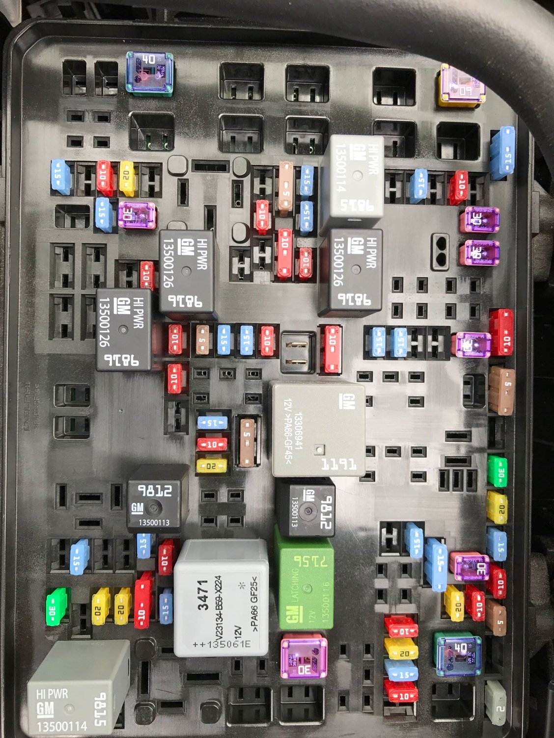

Where would the power connector go on this board?
Old May 2, 2017 | 11:51 PM
  #231
C6 MoneyPit's Avatar
C6 MoneyPit
Joined: Feb 2006
Posts: 2,574
Likes: 136
From: Simi Valley California
St. Jude Donor '06-'07-'10, '15. '22-'23
[QUOTE=cberistain;1594656692]Where would the power connector go on this board?
Fuse 28 - look at the picture above or the diagram on the back of the fuse box lid.
