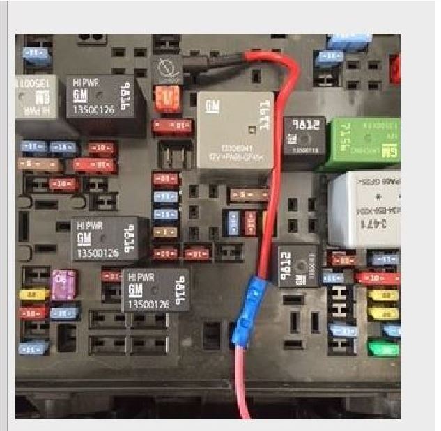

Originally Posted by fredl11
ordered the wrong tap Am now waiting for the MICRO tap.
I'm looking at the photo
and it looks like you removed fuses 27 and 28 , plugged in the tap and then placed the 2 removed fuses into the tap.
Am I seeing this correct or on the verge of shorting out the whole electrical system on the C7
The fuse in Position 27 (ODD ING) is covered by the Fuse Tap so you can't see it in the photo.
The Fuse Tap you want to use is for Micro-2 fuse.
1. What you need to do is pull the original 15A fuse from Position 28 (EVEN ING)
2. Put that fuse into the bottom position of the Fuse Tape.
3. Then put the new fuse (I used a 10A) in the top position of the Fuse Tap
4. Place the Fuse Tap back into Position 28
5. I cut a slot into to the fuse box to prevent the wire from being pinched by the fuse box cover.
Hope this explains it!
