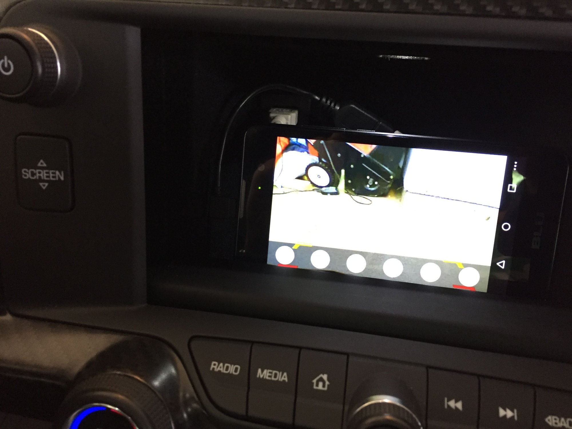

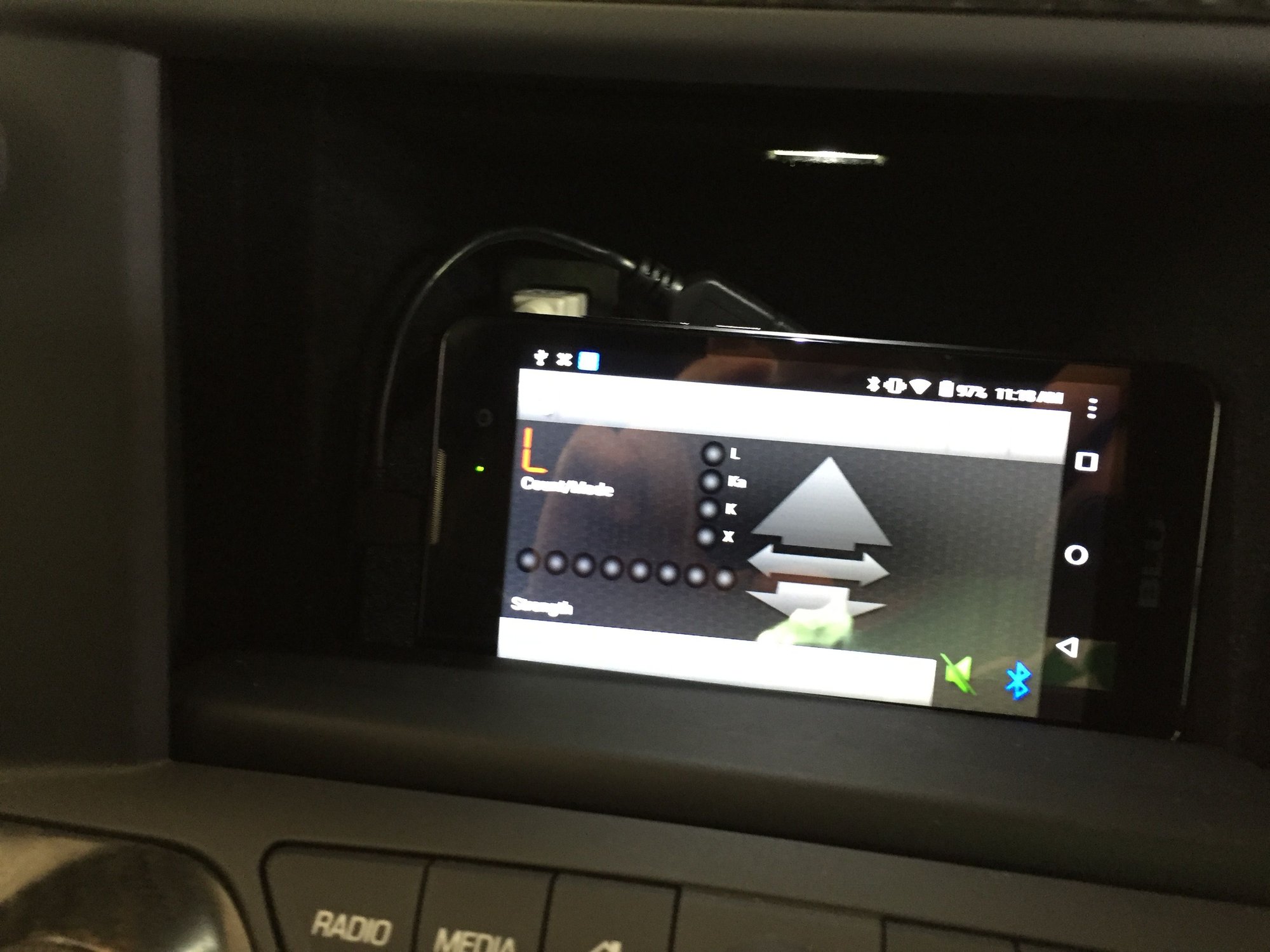

I still have the Trio tablet coming but it dawned on me that having Bluetooth would be nice so I could also use it with the Valentine One radar detector app. I ended up buying this, and for $60, I'm really impressed.
https://www.amazon.com/gp/product/B018IZ0SWI
Solid build, fast, nice screen, boots pretty quickly, 2 Sim slots, Android Lollipop 5.1. Just not sure about battery life (which doesn't matter for my use). There is an app in the Google Play store that wil auto start apps (like WIFIAV) when the phone boots up (All In One Toolbox, free with ads, $3.99 with no ads). You can also set the phone to shut off at a predetermined time everyday, so you don't have to worry about shutting the phone off. The phone works great with WIFIAV. No complaints. Get in the car, power the phone up, swipe up, WIFIAV is already running so you're all set. I haven't figured out how to have it bypass the swipe screen and go directly to the WIFIAV app. Yet. You probably should buy a SD memory card since this only has 4GB. I had one sitting around.
Not sure what I'll do with the Trio. I will still see how it works with th WIFIAV app once I get it.

Forgot to mention you are probably going to need a right angle micro usb cable to get this to fit (unless the micro usb connector is very low profile).
https://www.amazon.com/gp/product/B0...?ie=UTF8&psc=1
I cobbled together a couple of usb cables to get it to work in the meantime.
WIFIAV
Valentine One App

Happy to blaze the trail. What is nice about the BLU phone is it is a 5" screen, which is about the biggest you can fit in there and with a cheap SD Micro card, you are at $70. You can still buy a new iPhone 5S and they cost around $500 without a contract.

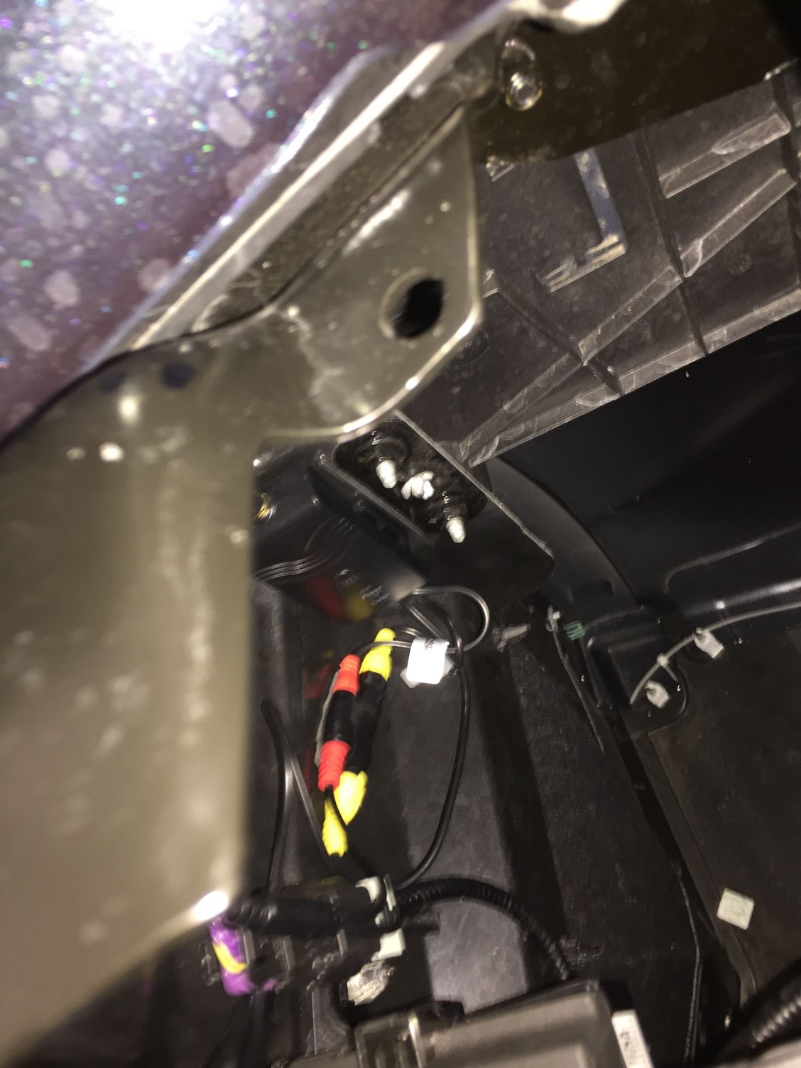

Originally Posted by zbrett
On the passenger side behind the the wheel well below the bumper strike plate for the hood. Does this help?
I give up. I can't find that spit
Do I need to remove pass tire and fender well?
I'm so confused
No removal is necessary. Look straight down beneath the plate where the hood bumper sits over the engine bay, behind the wheel well on the passenger side. Right below the windshield. All kinds of nice, flat areas where the wi-fi unit can be mounted.

Figured out how to bypass the security screen, so now the phone boots directly to the WIFIAV app. Total time to boot up and start the app is about 30 seconds.

I'm looking at the photo
and it looks like you removed fuses 27 and 28 , plugged in the tap and then placed the 2 removed fuses into the tap.
Am I seeing this correct or on the verge of shorting out the whole electrical system on the C7
ordered the wrong tap Am now waiting for the MICRO tap.
You don't remove fuse 27, remove fuse 28 and add another fuse to the microtap for the camera power source.
