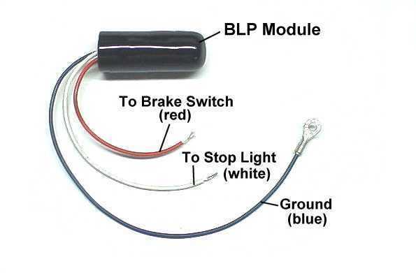

WebElectric products does make a "universal" module that requires splicing:
It has the same "delay feature" as their plug-and-play units.
