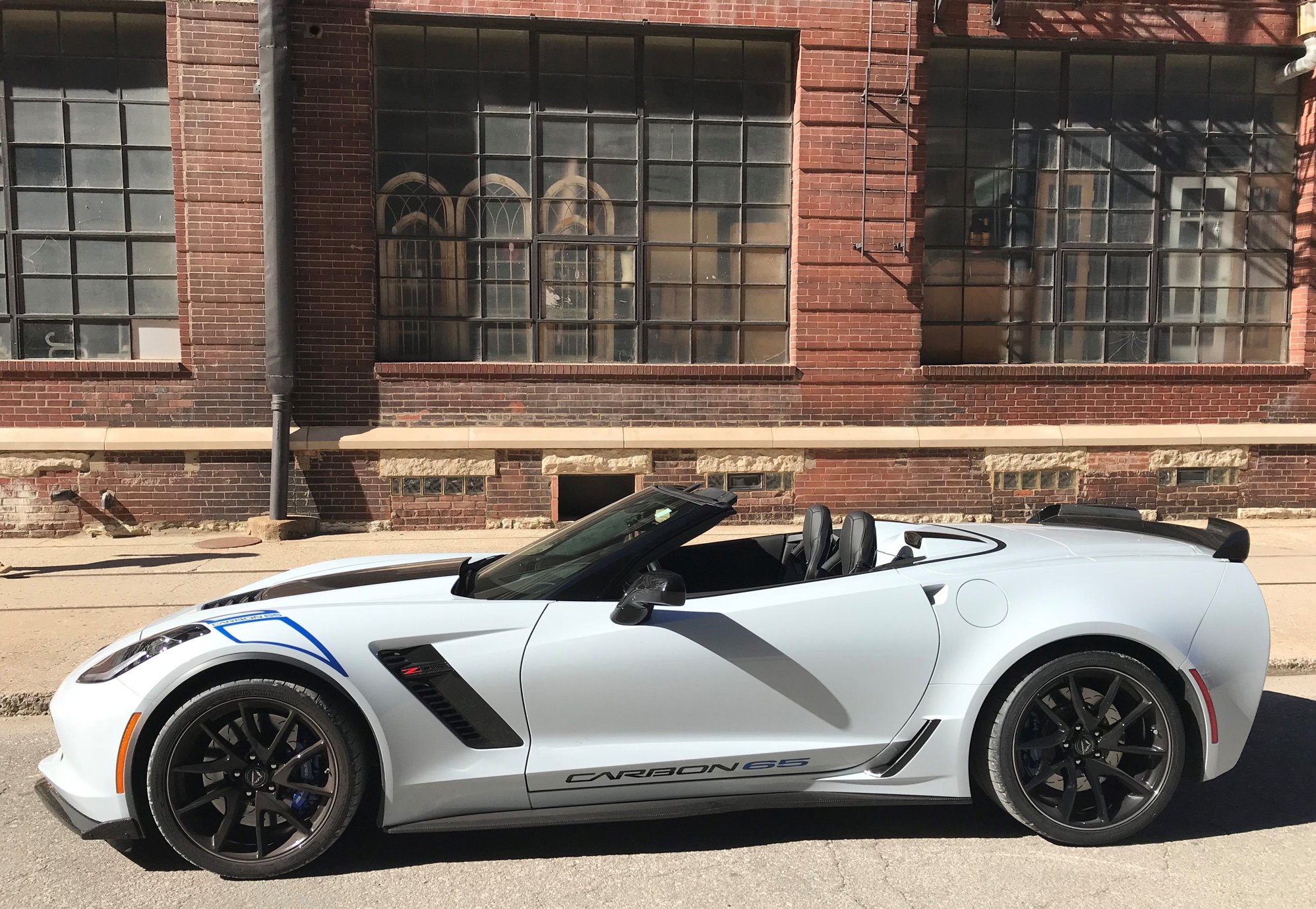

Default Heres mine

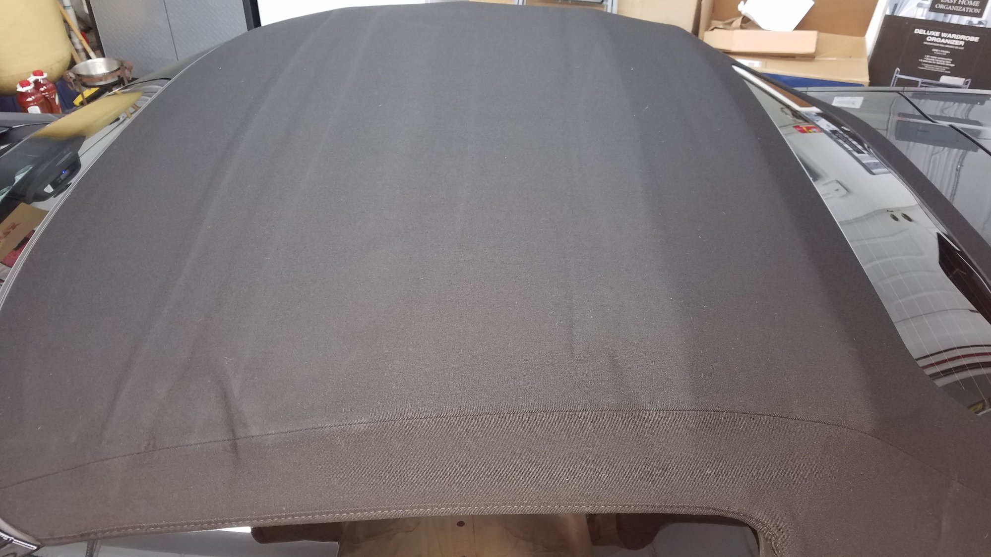

Default Rag top normal wear???
2019 ZO6. WGG M7. Normal rag top wear?? Top was water proofed since new. A/C garage kept. F'n crease patterns drives me nuts! Just wondering if this is the norm?

Looks like you have had the top down while the car is sitting. The top needs to go up while it is in the garage or those wrinkles will appear. If you or your wife keeps a clothes steamer around run it over the top slowly. But I always put the top up in the garage and I live in SoCal so the top is down most of the time I drive the car.

Top is always put up when not in use. Never put down when wet. Extremely cared for. These creases on a relatively brand new car seem premature......?
This is normal ragtop wear in Southern California.
But, If and when I put the top up the wrinkles are in the same place.

In that case I agree. Take it to your favorite dealer. I had about 3 threads pulled out where the top creases when the top folds. Took mine in and the Service Writer took a picture and said he would call me. About a month later he called and said your new top is in and I will need the car for 2 days to allow it to stretch properly after installation. So I got a new top on a 2500 mile car. Frankly I was floored with the service and the fix. And I do not have those creases when the top is up. Yours was just not installed tightly enough.

Mine does not show the wrinkles at all but it is stored with the top up all the time and driven with the top down. Got the tip on a Kindigit show. Their upholstery guy was replacing a 60's Chevelle top and said that any convertible should always be stored with top up or it will eventually wrinkle.

Wrinkles in the convertible top are just the nature of the beast. It also shows you know what a convertible top is made for.......... that's to put that bugger down every chance you get.
There are only two basic rules. Do not put the top down when it's wet, and put it up when you put the car up.

Met with the Dealer yday. Exactly as you stated. They took pics, wrote up the issues and submitted to GM. Hurry up and wait. Hope I have as good of an outcome as you!! Thanks......

I've had the same wrinkles for 3 yrs. coming this July.Always stored up.Driven 98% Down.Always garaged.Top was wet maybe 3 times.
I don't like the wrinkles.If all have them that would be fine.If they fix,holy crap i will look into that.
I always thought mine sat outside at KERBECK,Top down.Roasting under the tonneau in the direct sun melting the folds in?
Was your outside on display for a while at a dealer top down?
I think most owners if left outside parked would put top up for security and keeping clean.
Actually started a Thread way back when it was bothering me..
