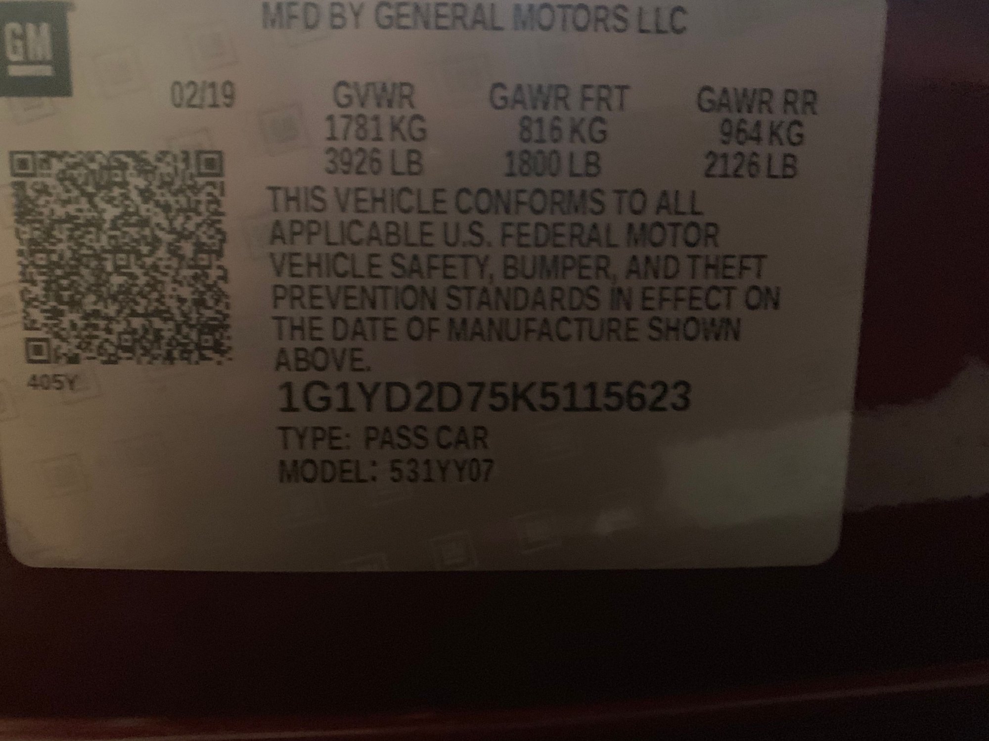

Have just finished my third careful reading of this thread and can't find the 18-NA-355 with the July 2019 revision. The one with this number I did find is undated and describes the required diagnostic procedure. I can not find 19-NA-121 at all.
Easy for me to claim ignorance here. My 2019 Stingray is about 1 month old. I would like to have these 2 documents in hand when I go into a dealer for this service. I well may be doing the search wrong and if someone can also fill me in on the specific site to search, it would be appreciated.

Originally Posted by mountainears
Found it. 2015 - Feb 1, 2019
I guess I should be good then.
