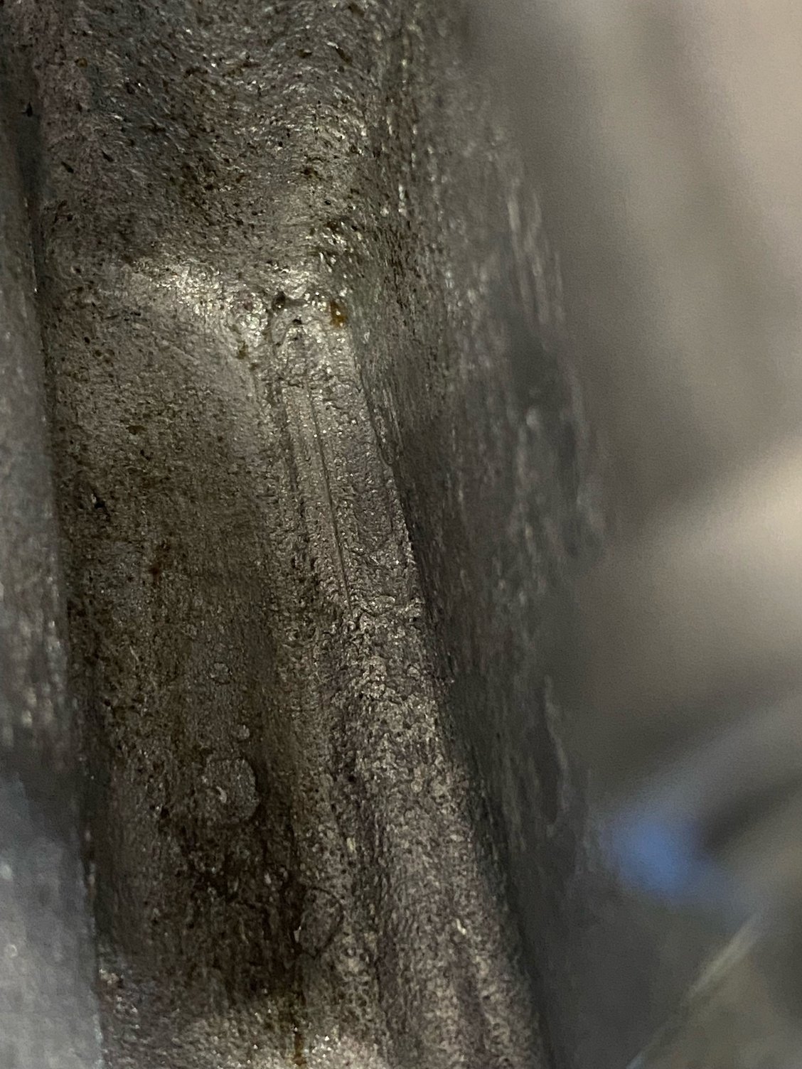

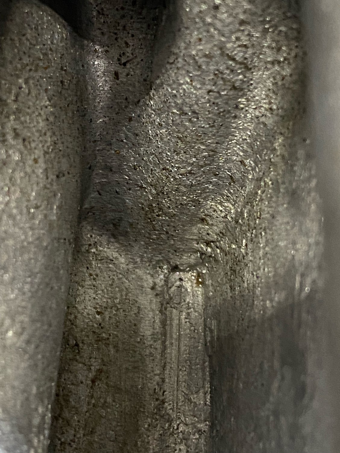

Just some pictures to close this out; I think the (lack of) quality in the casting speaks for itself. It probably leaks more under pressure but oil was still running out as it sits on the shop floor. They said the new casting does look better so lets hope that looks are everything on this!! For reference, this is looking down onto the web brace to the output drive casting; the output drive casting is on the left of the pictures. Classic porosity failure location.
Dealer said it was the worst looking casting they have seen and they have done more trans replacements than you should expect; I'm of the opinion that TREMEC and GM QA should have picked this kind of issue up before it ever made it into the vehicle. For reference, the old trans was built December 09 2021.

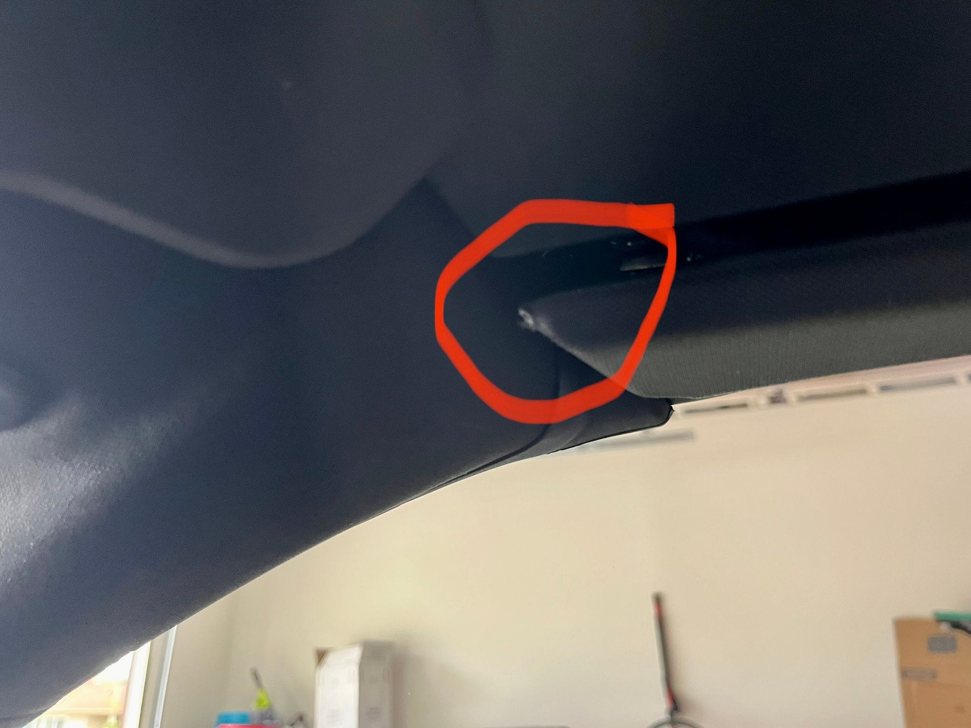

My HTC has started making a rather loud "clicking" or "snapping" noise when I raise the roof. I can't see any damage. Taking to the dealer in a week to see what's causing it.
Check out the interior trim pieces that fold over the passenger side. I’ll try to add a pic later. I had a similar issue.
Here’s the pic
