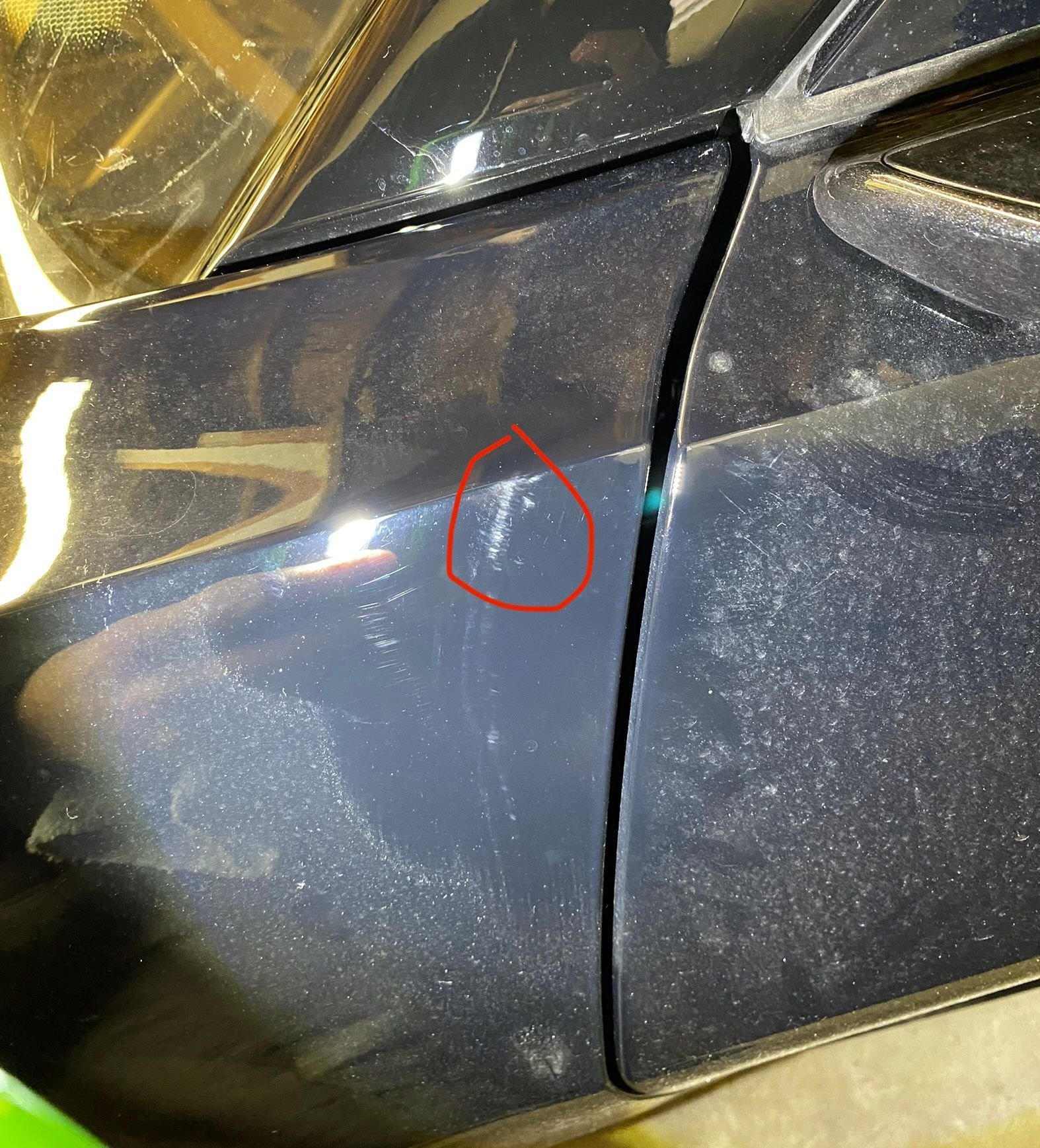

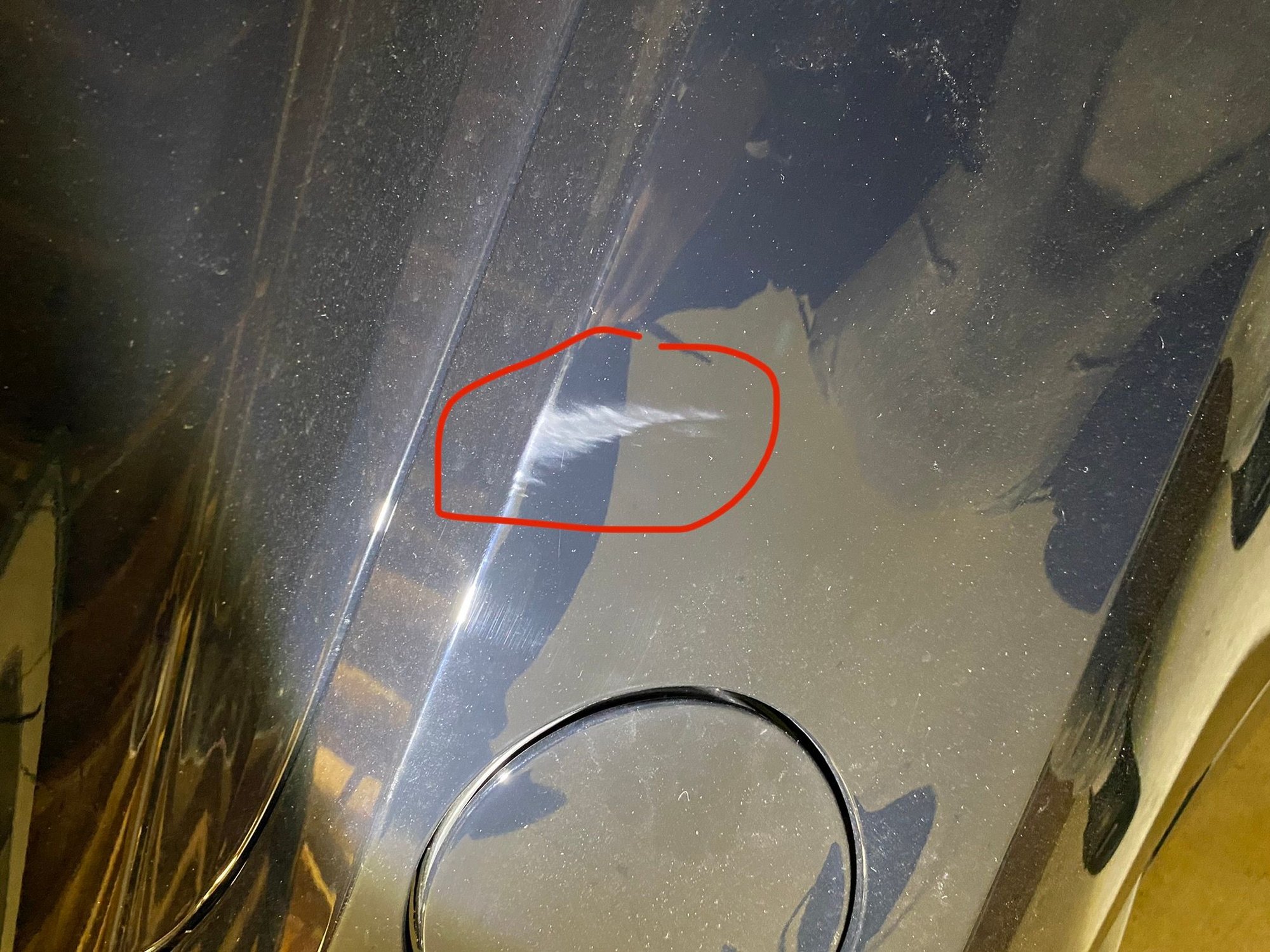

Etching and markings all over new delivery. 10+ all around car. I’ve seen a few dozen other people post about the same issue. Forgive me if this is already somewhere in the thread.
Suspicion is that it is the shipping covers.
Wow! That looks really bad. I don't know how comfortable I would be letting the dealer take care of that for me. I would first ask how they plan to take care of it, then ask if they had any cars there they had performed that work on so I could take a look. To me, these pics look like your car needs to be sent to a very competent paint shop. If you are planning to put PPF or ceramic on the car I would ask the dealer if they would pay for the work that has to be done to make this right if you aren't comfortable they can do it themselves.

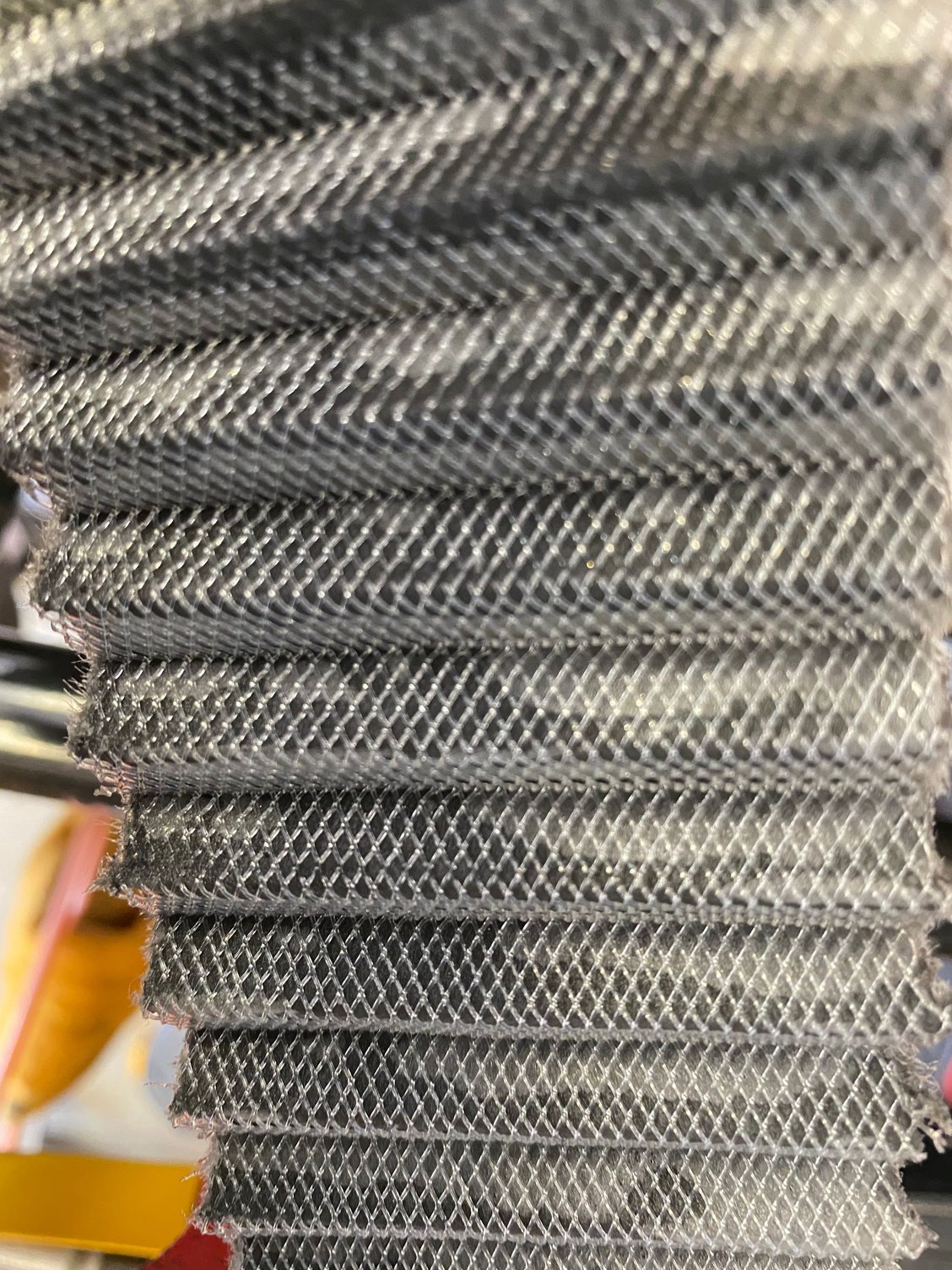

Default Early DCT Filter Change ... The Good and the Not So Good!
2022 Coupe - Jan Build. Based on the information on these forums and reading some of the Vette Titan's notes, I decided to change the DCT Filter at the 2,500 mile mark. I had previously added 1.8L of additional DCT fluid at 1,000 miles. On the "good" side the filter looked in fairly good shape with no major debris visible when I dismantled the used filter to look at the inside layers. Based on my observations I will have no reservations in waiting until the 7,500 mile service for the next filter change. However, upon dropping the shear plate I found a good amount of fresh DCT fluid on the shear plate and on the external parts of the transmission sump pan. I could see no evidence of leakage above the trans sump pan and concluded that the sump pan gasket was leaking. A quick check of the sump pan bolts found them all tight.
The trans leakage was the "not so good" part but I feel fortunate to have found this leak early because of doing an early DCT filter change. There was no evidence of oil drips on my garage floor but a little more checking shows that the air flow over the shear plate was enough to slowly push the leaking DCT fluid to the rear valance and then onto the exhaust where it was neatly burnt off!
The dealer says it is actually the solenoid valve cover (lid) plate gasket that is leaking and we are waiting parts. The location he identified as leaking is just in front of the drive shaft and in the areas that have been identified as being porosity-prone, but he feels 98.5% confident that it is just the cover leaking and not a porosity issue. Fingers crossed that he's right once the parts come in!
One last comment on the DCT Filter and its internal "pressure valve". A number of posters have referred to this as a "poppet valve" whose operation is either "OPEN" or "CLOSE" but the filter that I disassembled clearly have a valve that would open "PROPORTIONALLY" i.e acting as a pressure relief only for that fluid that couldn't pass through the filter materials.
DCT Filter medium - inside view
DCT Filter - cage removed
