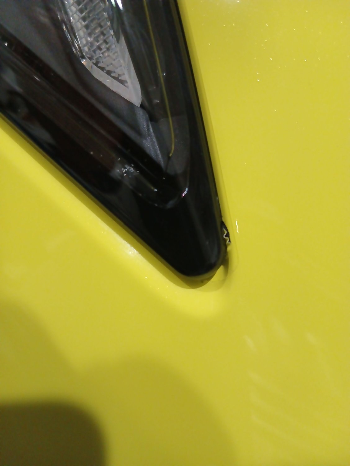

The dash has been bubbling since the car came out. 5 yrs, just another thing GM will not fix. Alot of people had it fail outside the warranty. Here is a SB published 2 years before mine was built and delivered with the same flaw. 3 days in the shop and pull/paint the front clip. People keep buying them?

My 2023 that I used to have had two small bubbles or chips like this next to the headlights. Has to be a common problem on alot of them I am thinking.

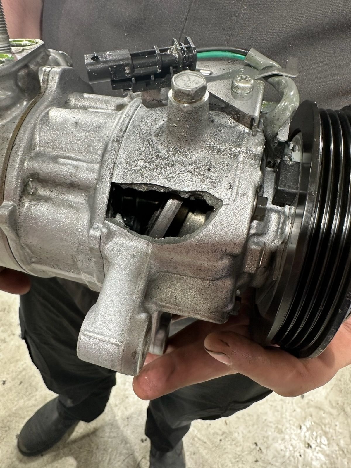

If you read the SB its about proper headlight alignment. .05mm I took delivery at the factory and could have checked and had it fixed if I was aware. How long for GM to check/fix
on the line? No, they just keep rolling them out. I traded a 2021 Mach 1 because of QC and ongoing mechanical issues. With 7000 miles this 2024 C8 might be heading the same way. What next??? No oil in this AC compressor. 5000 miles blew.

Yup, my 2023 had exactly the same problem, two tiny bubble cracks by the rear pointy bit of the headlamp where the panel join is. Just had it fixed under warranty at a Mercedes approved body shop, the only place I trust to do a decent job. They strip the whole front off to repaint it properly. Dealer wanted to pay $600!!! GM then approved the $3500 it actually cost. The front lift problem has returned. Same crappy dealer had the car for over three weeks at 1000 klm to fix Convertible top not working and the front lift only working once every trip. Did the roof but said they thought the lift was a bad connection! Never actually found or fixed the problem. Completely hopeless. I will have to find a better dealer willing to do the warranty work (Australia not US). Anyone know what this issue could be? Use it once then it says it needs servicing and doesn't work until you switch off and drive it the next time.

Is this paint flaw a warranty item? I have less than 5500 miles on my 24 2LT and it has shown up.

Its a SB from April 2022.

I had it repaired under warranty. 2023 car with 4,000klm. Tried to stiff me with a cheap touch up job. Held out for a full blown strip and repaint from a superb repair shop.
total cost $3500 au. Do not settle for anything less.

Thanks. I have an appointment with the dealer set up for this Friday to look at mine.
