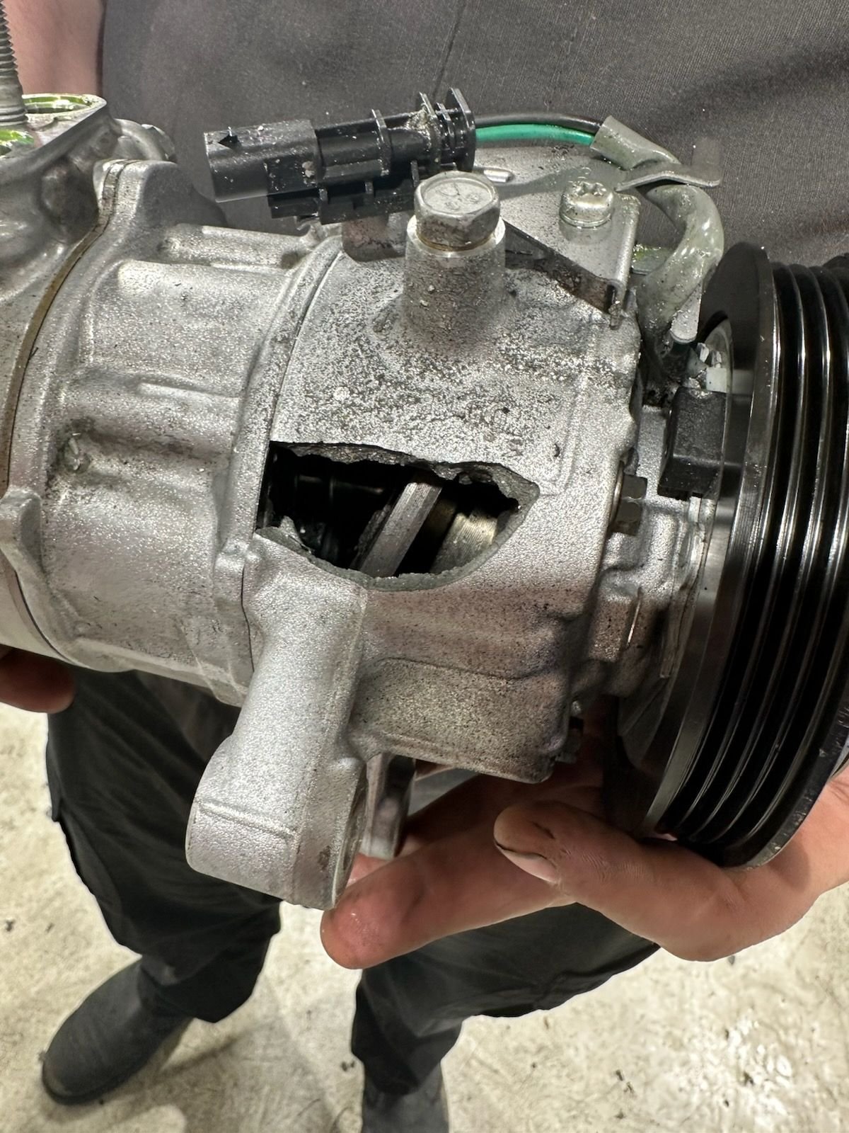

Originally Posted by kellyreno
That's a big hole - did you post a backstory about that?
One picture is worth a thousand words? They're not supposed to look like that, are they?

DefaultDefaultQuote:
AC compressor failed at 5,000 miles. Was running the defroster/heater at the time, OAT about 45 degrees. Slowed for a railroad crossing and when I accelerated it sounded like a grenade went off behind me. My first thought was the DCT had blown. No warning lights, went home and then to the dealer. Car has been in the shop since Wed. on Monday they told me the wait is for the receiver/drier. They hope it comes later this week, Tech said there was a big mess when he dropped the pan. Green slime (I thought R134 was Blue) along with metal fragments. He thought it might not have been filled with oil. No telling how much has contaminated the system. A lot of plumbing to purge with the condensers way up front.
It is common to replace AC condensers when compressors fail and send contamination through the system. They are hard to clean unless removed and once removed it is a trade between the cost to clean and the cost to replace.
The 'green slime' is the refrigerant oil with dye. Refrigerant has no color. The color of the can does not indicate the color of the contents.

Your car does not use R134. It uses R1234.
