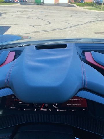

Default Leather Pulling on Dash
Mine is 2/20 production and is bad in area by HUD. 3LT
Ugh...
Any more details? Age of car? What state? Stored outside/inside?
I'm hoping this is a isolated case!

Originally Posted by jjsaustin
Ugh...
3LT Leather that detaches is not isolated and the main reason I didn't pay the big bucks for the 3LT option. Paying extra for a headache doesn't make much sense.

Default Dash problem
Yes . My 3LT Production 2/20 pulling by HUD.

As stated in post it was produced 2/20.Always garaged. 4000 miles.Car split time between IL and FL. Was happening before transporting to FL. It got significantly worse while parked in garage in Florida. Anyway it looks like an easy warranty issue. Sold car yesterday so new owner will deal with it.
UGH, this is exactly what I was worried about with 3LT. I really really really hope this is an isolated case. If more of these start popping up my decision to go back down to 2LT will be far easier to make, even if it means I can't get the exact color combo I want. Also wondering if it's more common in high humidity locations than low humidity ones.
Would it be SO hard for these manufacturers (since chevy isn't the only one with dash pulling issues on leather dashes) to use a quality adhesive that wont come off the minute the leather starts to expand/contract?
