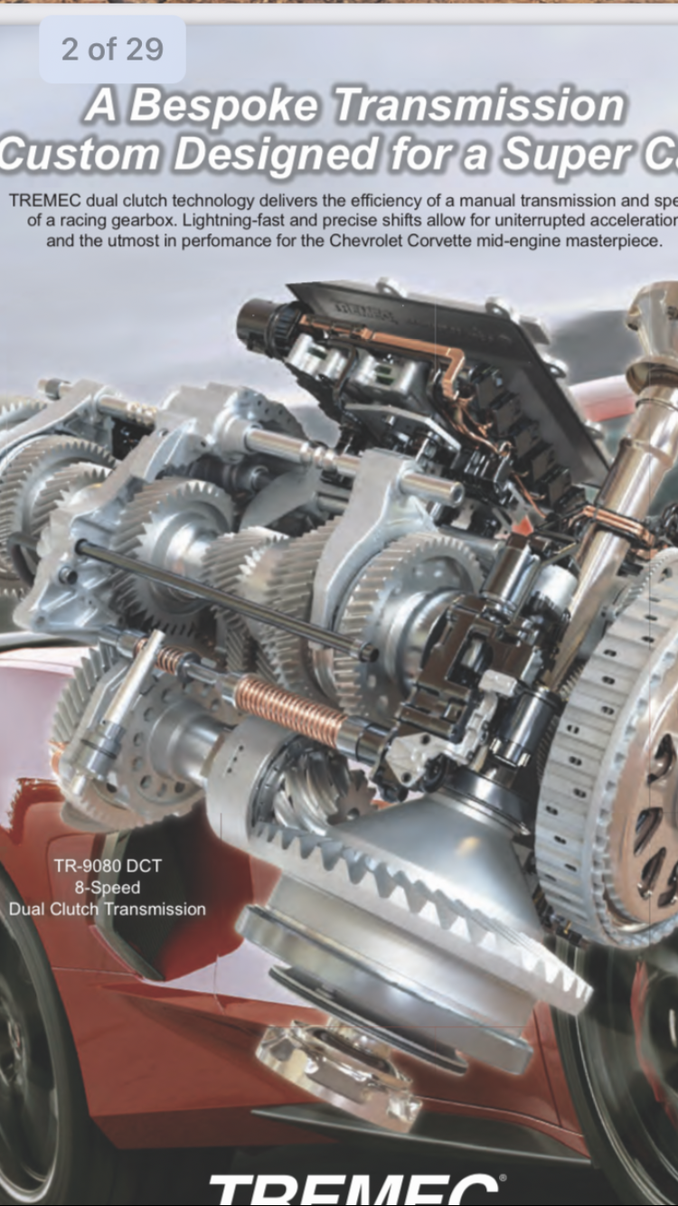

Here’s a cutaway pic of the DCT. I don’t see any spur gears in there.... but they may be out of view.

Old Dec 3, 2021 | 12:18 PM
RKCRLR's Avatar
RKCRLR
Joined: Aug 2016
Posts: 12,790
Likes: 10,218
From: Garden Valley CA
You're right. I had seen this photo and saw the spur gears. However, I didn't look close enough. They appear to be for the LSD and won't be rotating when going straight.
