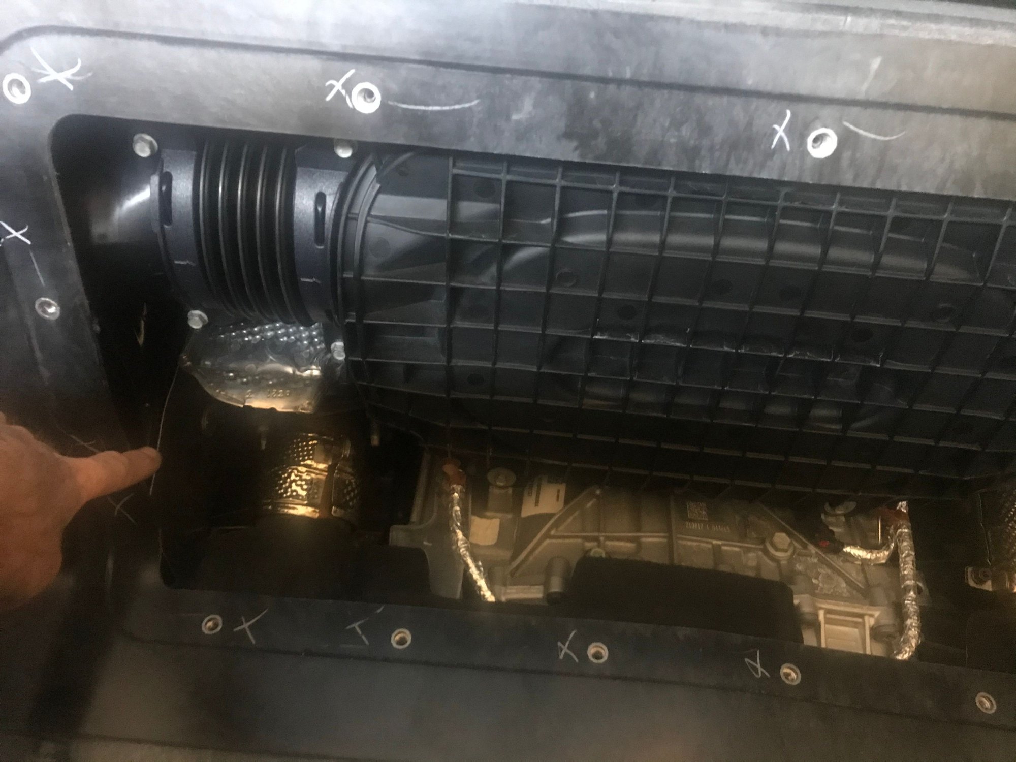

Thx. Any idea when ‘the move’ will take place? Mine doesn’t ‘make a bunch of racket’ but there is a noticeable ‘whine’ in the 65-70 mph range. It’s annoying and I can’t un-hear it. I take it back to the dealer next week to measure the frequency and amplitude. The we'll see what GM says.
As a side note, I was playing around today insulating the engine side of the removeable panel in the rear trunk. Looking down at the tranny, I noticed there are cone-shaped aluminum shields, bolted to the tranny, that shield the CV joints. When I tweak them with my finger, they ring like a bell. I can’t help but wonder if they amplify diff vibration when it hits a resonance frequency. I’ll probably ‘deaden’ them but not until after my dealer appmt
