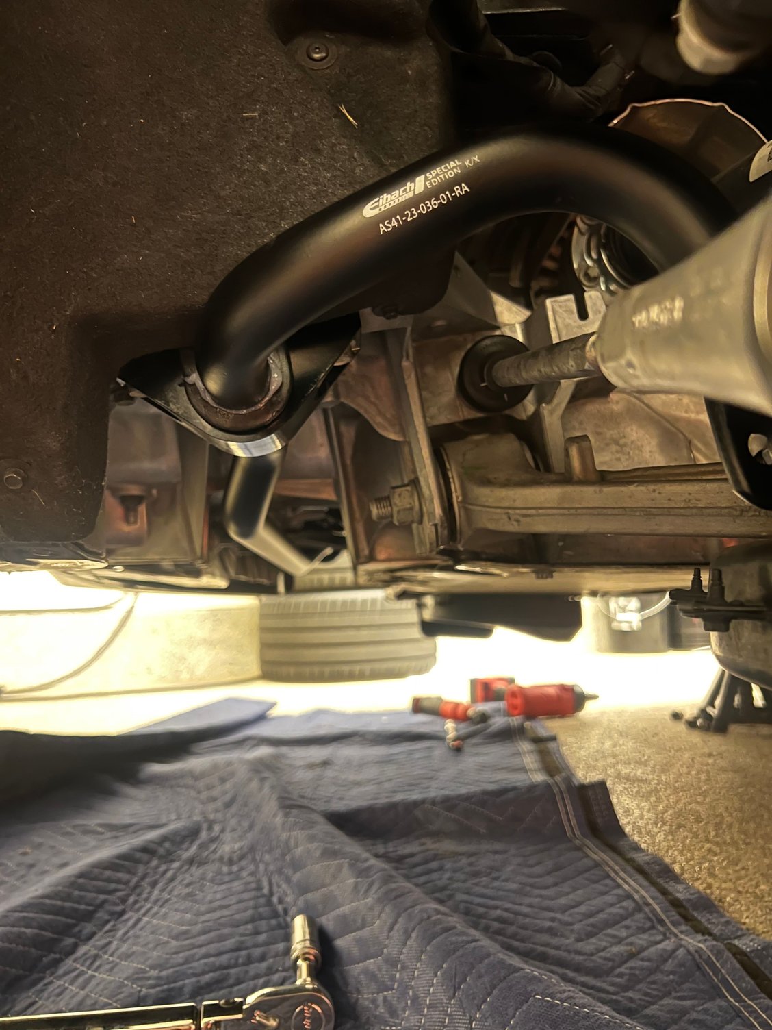

Hey all,
posting up a little review on the the rear bar install and driving.
install was pretty straightforward. Just made sure to lube up the bushings. Let me tell I was very impressed by the quality of the bar and the mounts, there quality pieces.
Just like others have said the rear of the car is more lively and fills like it wants to rotate more. Definitely more solid feeling as well more control even on the softest settings.
10/10

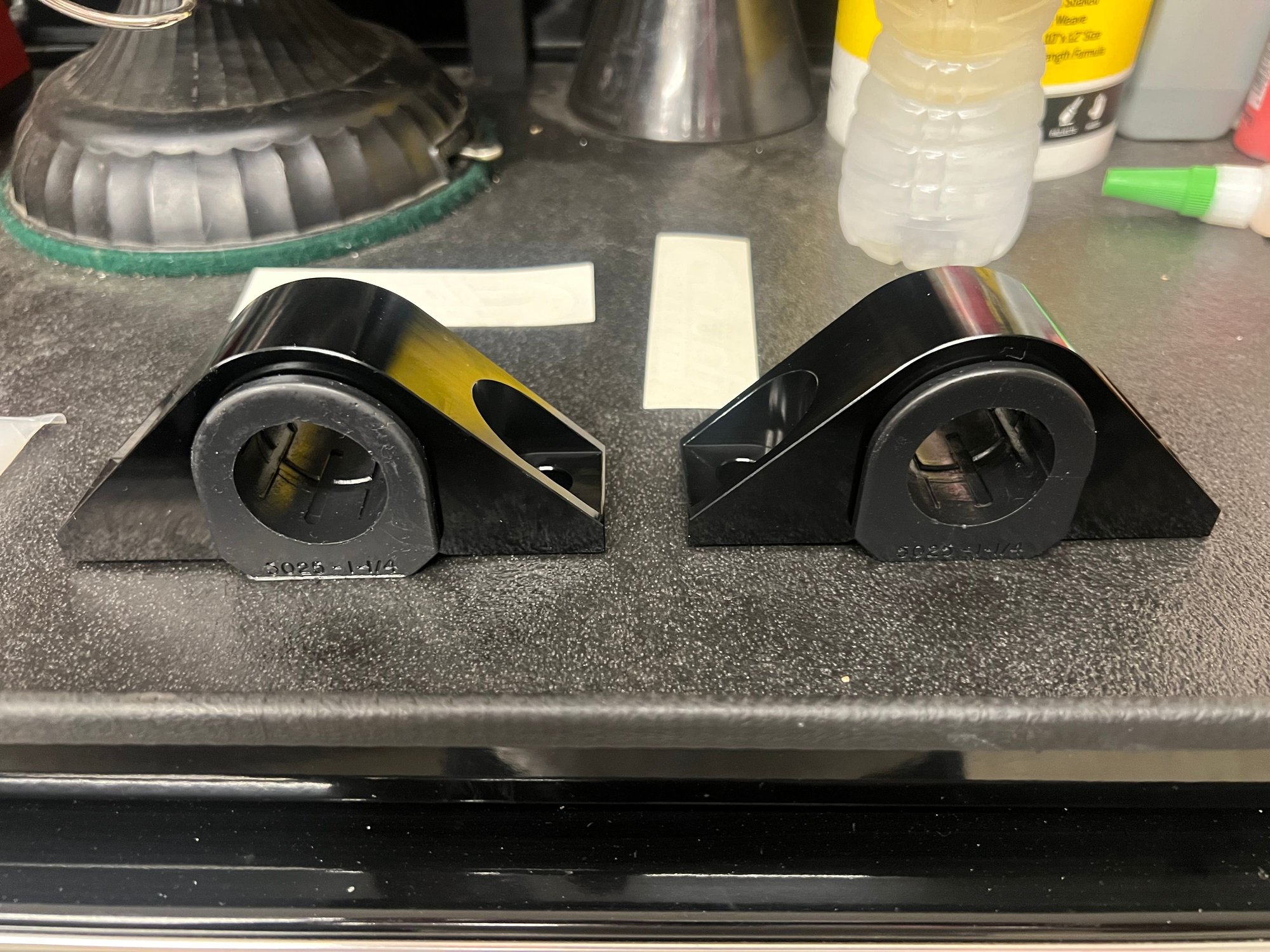

Hey all,
The only thing I was a bit disappointed with was the lack of zerk fittings in the brackets. No big deal... I drilled and tapped my own, but that's kept the kit at a 9/10 for me. Happy with the parts and the results thus far though.
