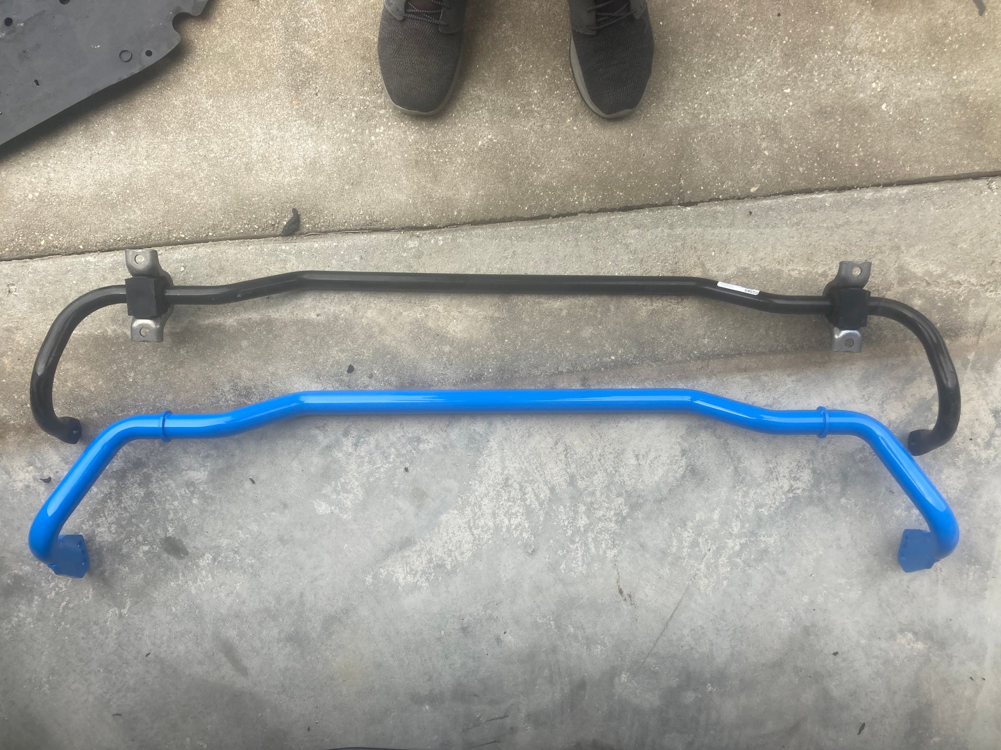

My rear bar showed up yesterday and I will say its very nice. Well-packaged, beefy black billet mounts, heavy-duty black bushings, and a tube of grease. Eibach's included instructions are detailed in full color as well.
Old Jul 30, 2022 | 12:44 PM
Kracka's Avatar
Kracka
Joined: Jan 2014
Posts: 10,709
Likes: 7,102
From: Fulshear, TX
The install process was straight forward and easy. I backed the car up onto a set of ramps. The bar is set to the "soft" setting as pictured below.
Tools needed include:
  • 7mm socket
  • 8mm socket
  • 15mm socket
  • 18mm ratcheting wrench
