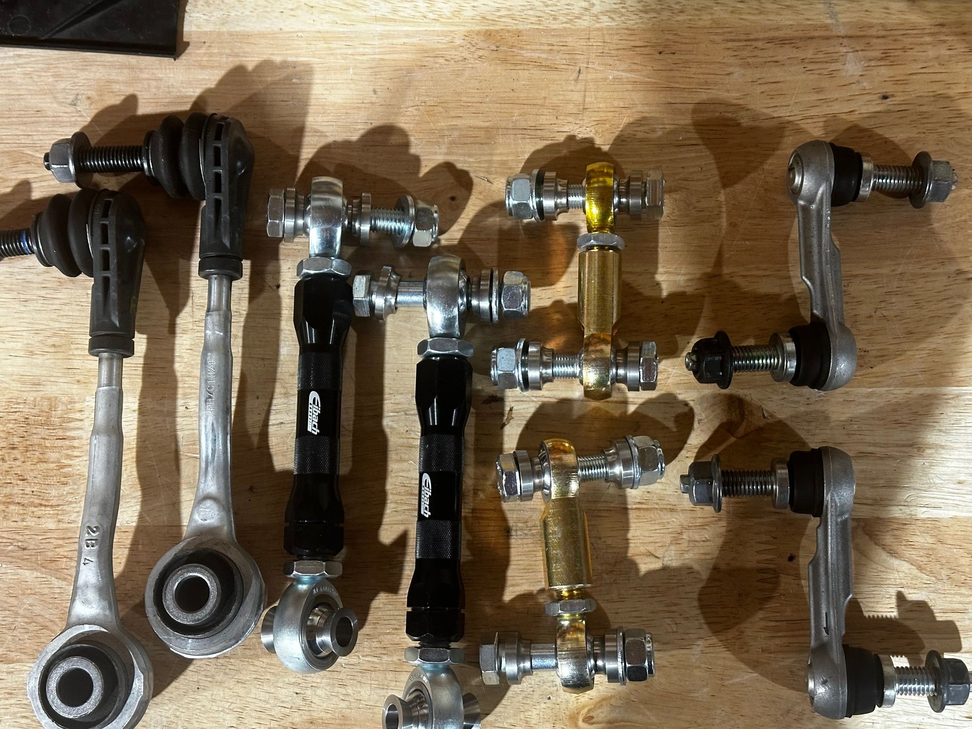

Did you, or anyone, ever measure the center to center distances or the length of the black turnbuckle on the longer set? The short ones seem to be ~80mm and the long ones ~192mm based on Eibach's instructions for install. How much adjustability did anyone need +/- from those nominal dimensions? I'm trying to figure out if I need 140mm or 150mm turnbuckles. An M12 male rod end is showing Center of eye to end of rod end to be 54mm w/ a threaded end length of 33mm. That means thread all the way into the turnbuckle I'd have 21mm to the eye. A 140mm turnbuckle with two rod ends install all the way would be 140+21+21 (182mm) and a 150mm turnbuckle would be 192mm but would not be able to go shorter. With the 140mm turnbuckle I could run those out to 192mm with still 16mm of engagement on each end which seems reasonable.
I'm all for supporting vendors, but at the same time as an engineer when I see I can build the part like this for considerable less money I'm open for doing it. Some end links and threaded couplers on McMaster is an easier solution... heck, even looking at Pegasus Racing for some Aurora end links (which from images I've found of the short Eibach link they appear to be Aurora's) it's pretty easy to build these up.
LOTS of great information on this thread. I've started to pull images and info together from here to make a reference sheet. Is there anywhere on this forum where we can upload / share stuff outside of threads? Sometimes you just want to grab a sheet that lists all the tools needed, a couple of reference photos, and torque specs all in one quick sheet.
