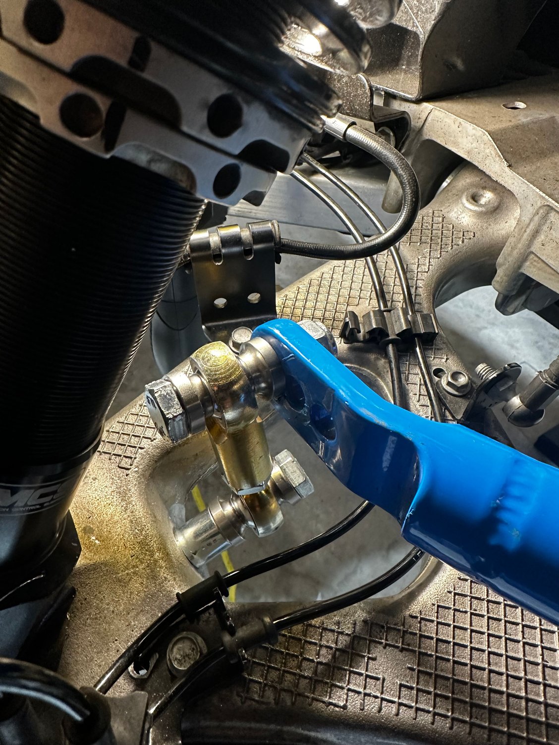

Eibachs front endlinks off the shelf won’t work with AFE bars. Due to the thickness of the mounting ends and slight offset. Will update when I get it figured out and finished. The angle of the mounting hole on the lower control arm doesn’t help much. Pretty much just need 1 10mm longer spacer on each end of each endlink to align with no bind. Found this by stacking washers. I couldn’t adjust or especially tighten down without damage. Plus 25mm longer bolts. The rears were perfect.
Working with Eibach on it. Doesn’t surprise myself They built them around their bars.

Sometimes you have to modify aftermarket or mismatch brands.
Also I feel the heim joint on the control arm side could be bigger for more range.That would solve it really. The joint doesn’t have the same range of motion as the OEM joint.
The guy at Eibach said the link will bind at full droop on the lower joint. Understandably. But a taller joint would avoid that too. Long as it’s centered under load is perfect.

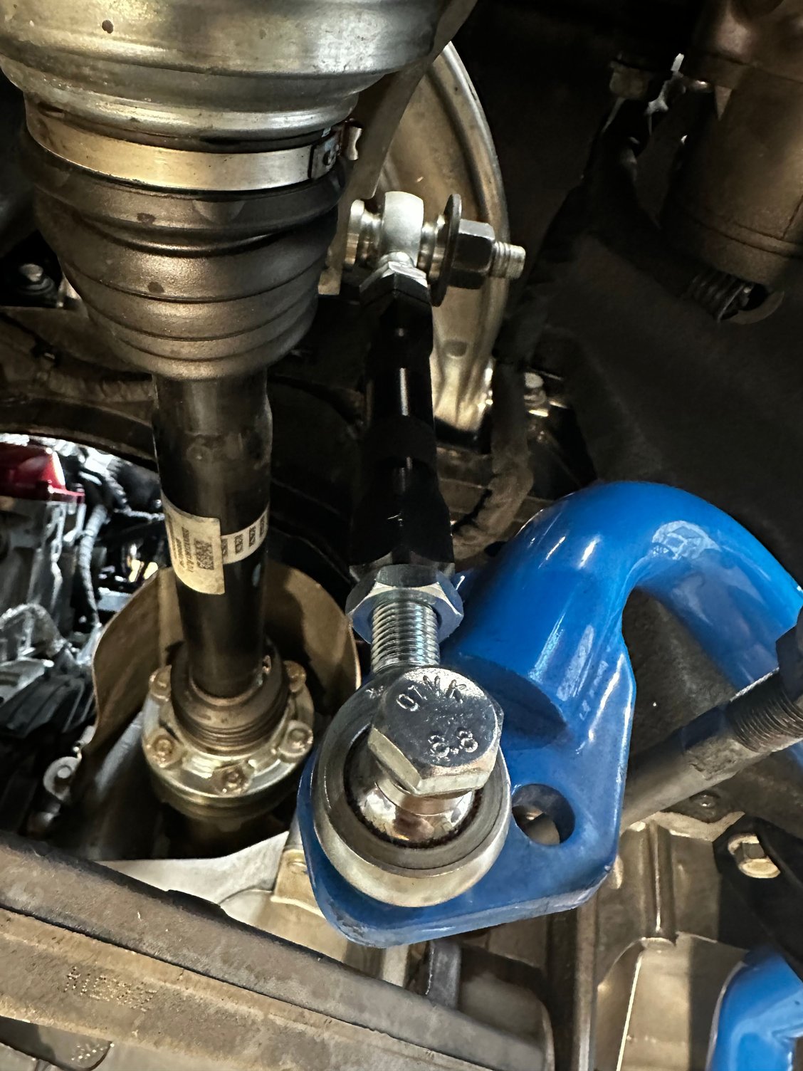

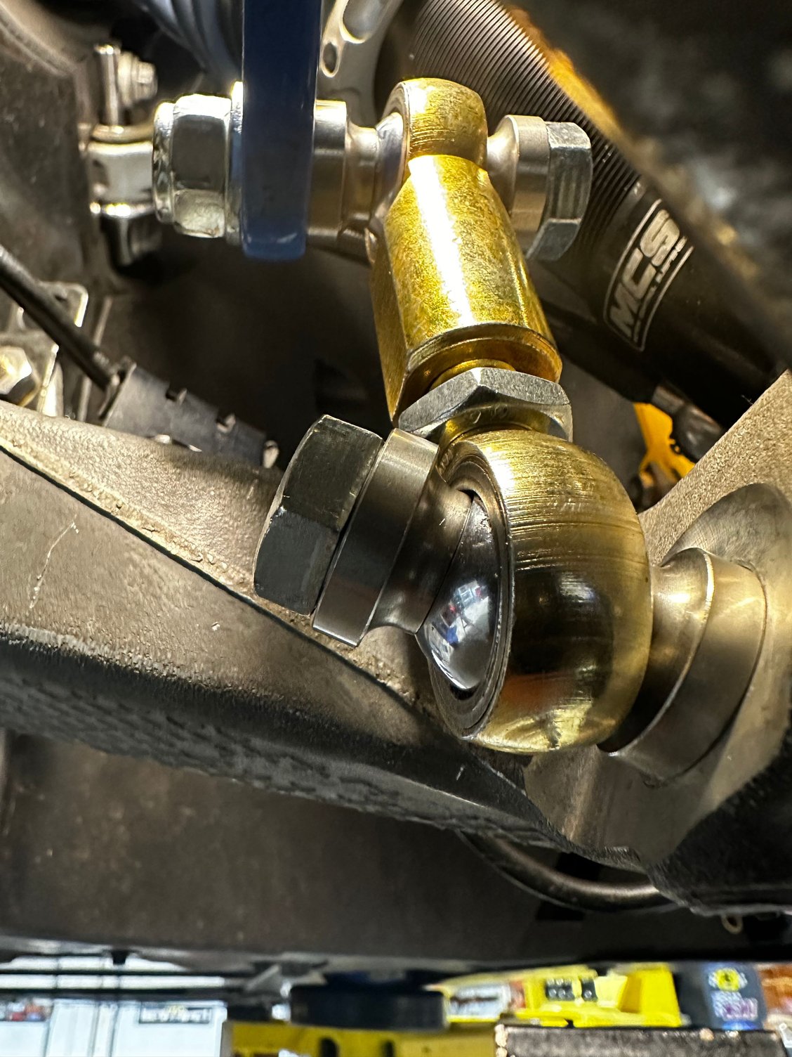

I ended up needing a total of 20mm spacer to get this more even. Eibach knows others have longer spacer especially on aftermarket bars. Being Eibach develops their own bars and endlinks, you won’t need but a 5-10mm spacer/ ear that comes with the kit.
You will see in the pics how my AFE bar ends are formed more center of the bar with a thicker end. OEM and Eibach ends are flatter and more outward. The OEM endlinks have a larger range in motion than the smaller but a lot stronger Eibach hiem joint.
I was going to go with one smaller spacer on each end of the endlink. Either way I would need longer bolts. Add that to the equation you wouldn’t be able to feed the bolt in with the hardware due to the coilover tower and I didn’t want to stack washers ultimately. So as I said I needed a 20 mm spacer total. Ended up with a SS 3/4 (and 19mm) spacer and a 1” longer bolt.
It’s great now. No bind under full droop or compression. A lot stronger than OEM. Eibach said you would have a little bind under full droop with the standard kit. It is a small compressed area.
When first attempted. Full bind and won’t extend further.
WITH SPACER
