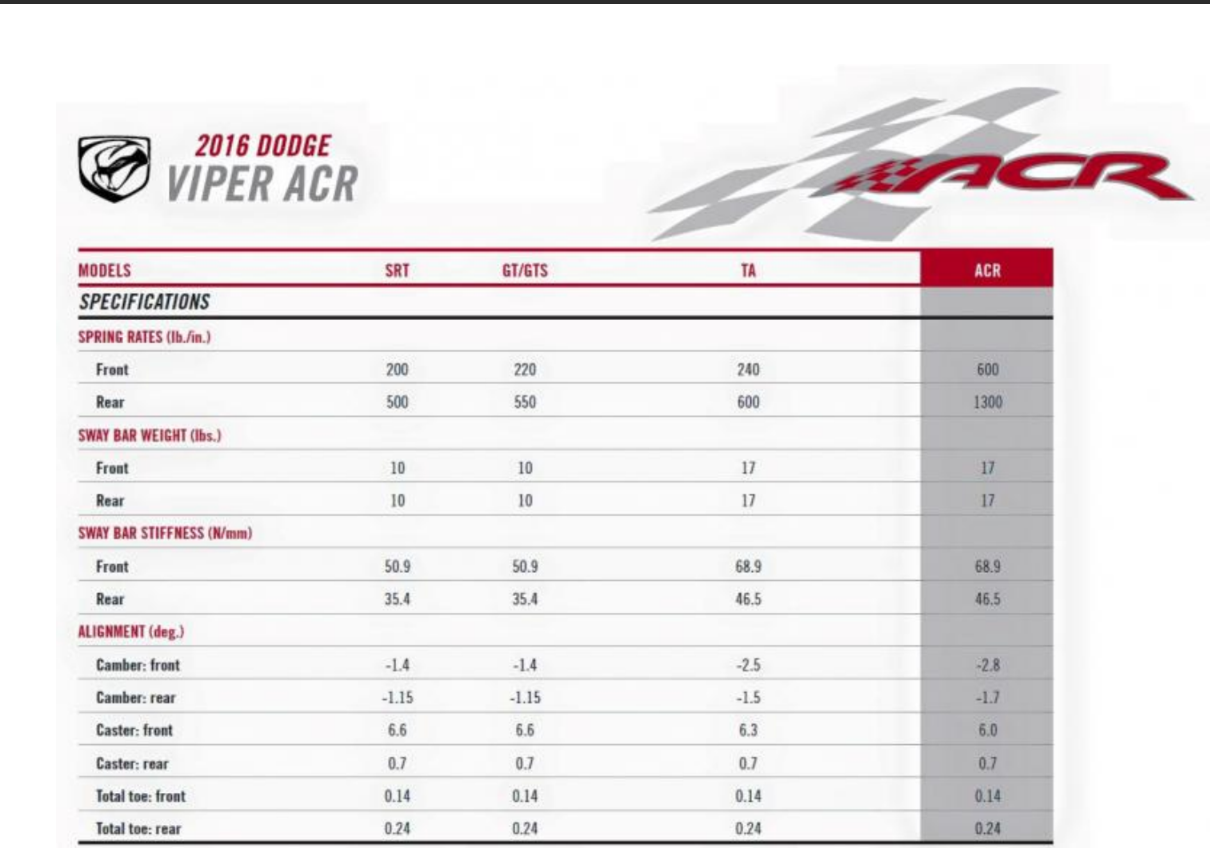

Below are Viper rates. Even though ACR's spring rates are much higher than other models', they did not feel the need to soften it up. This is similar to my experience playing with these things on cars like Miata, etc., too; stiff sway bars are great for track. I don't know GM's reasons, but they might have softened it up on Z06 to make it a more comfortable ride, which is not my priority at all...

What tires do you run as that’s a big determining factor isn’t it? I don’t consider 700/750 high for a C8 being it’s not exactly light, I run 700/650 on my C6GS with 200tw tires and no aero which I kept it on the softer side as some tracks like Hallett are not very smooth plus I like to autocross.
The big reason for the ACR having ~double the spring rate of the other Viper models is the Kumho tires and downforce I thought? The difference in Z07 and Z06 on the C8 is spring rate and sway bar bushings to handle the aero and tires right?

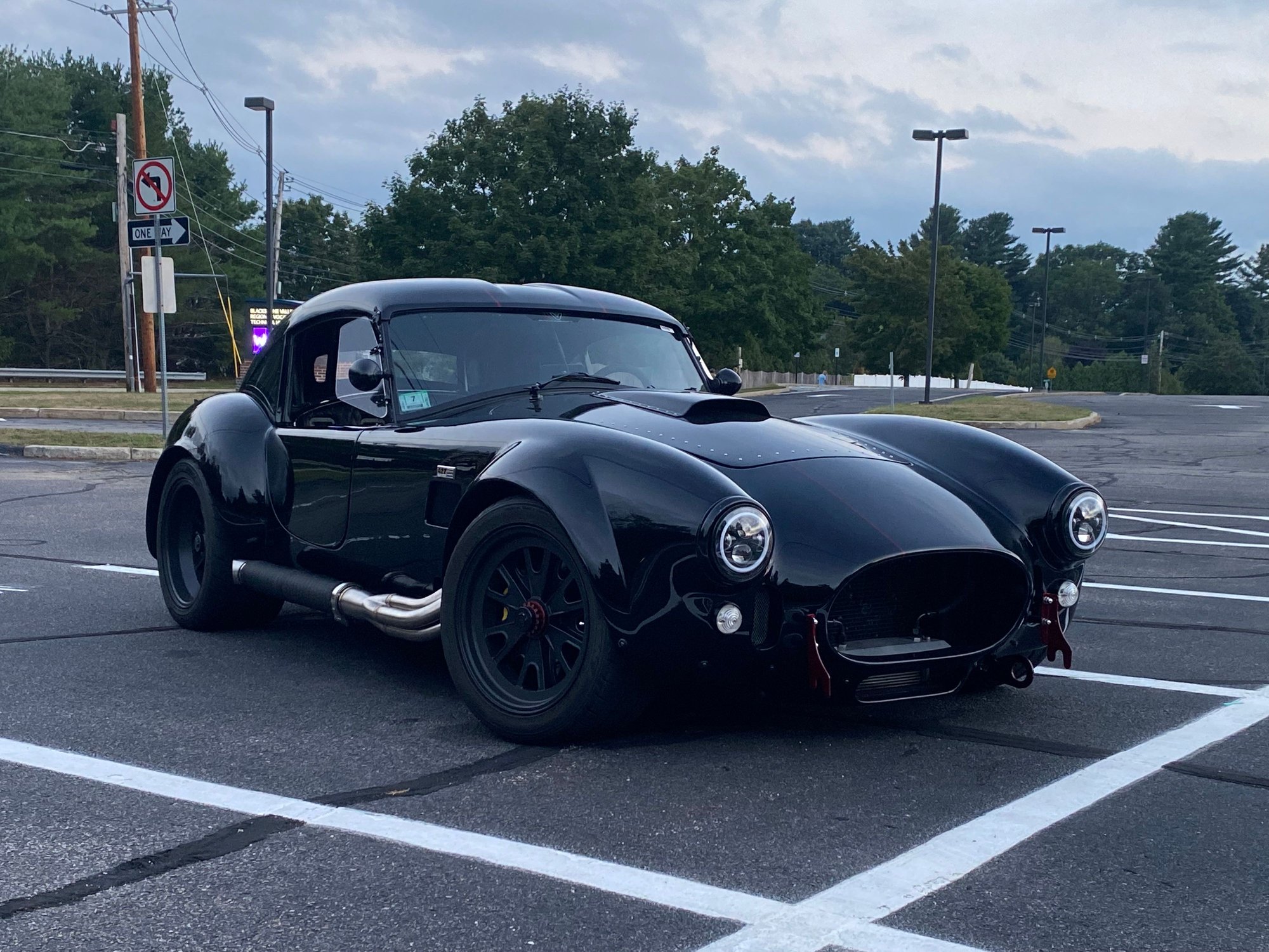

Backdraft.
I run my car on street too, it rides similar to my car in track mode when I dial down the shocks but a bit smoother
this was my backdraft, traded it for the C8 after having it about 7 years

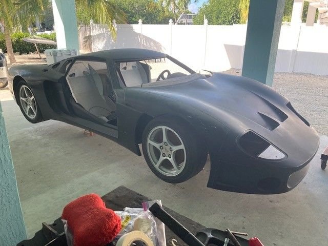

That's badass. I have an uncompleted FFR project I promised my wife I'd sell after getting my C8. Hasn't sold yet.

GTM, very cool, not many out there
