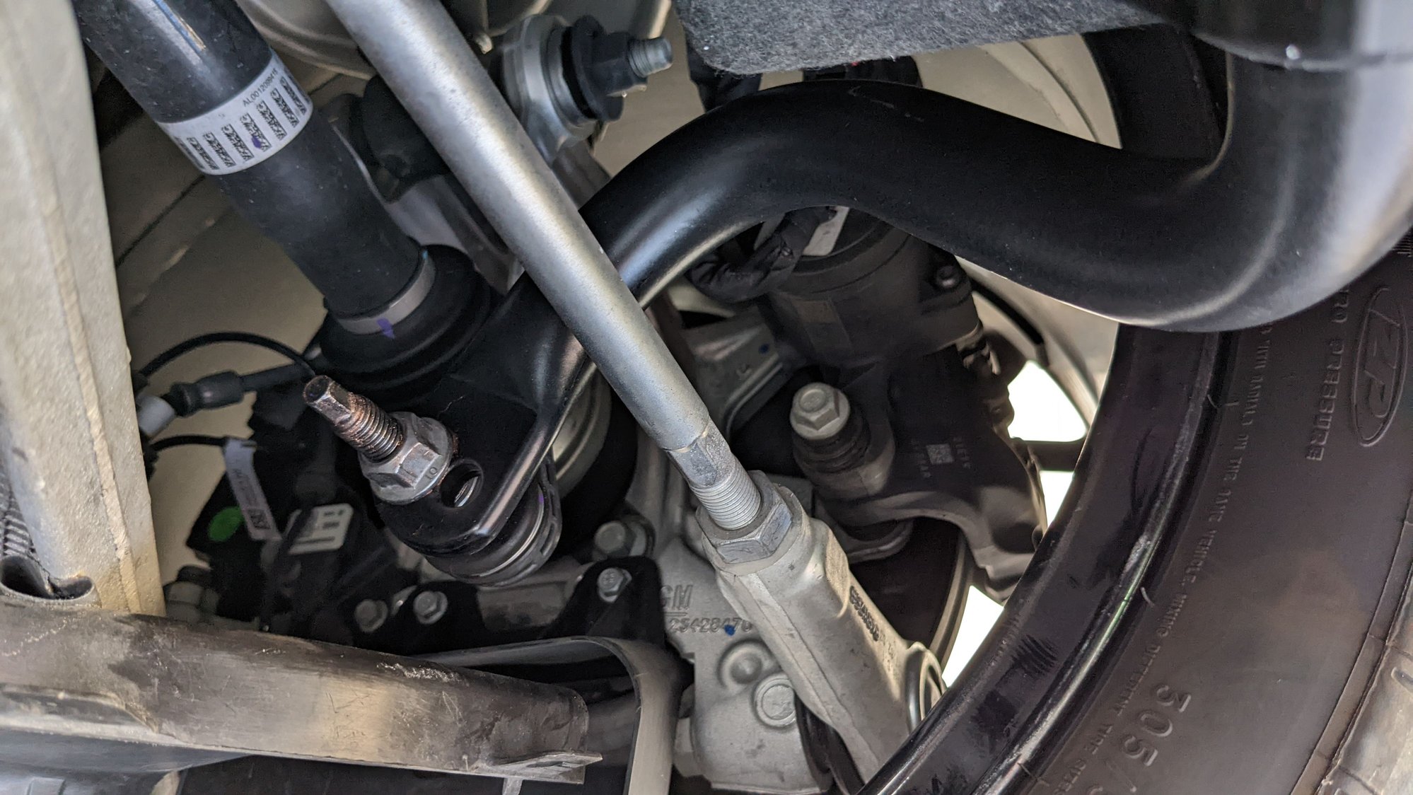

Likes: 654
Originally Posted by Kracka
The install process was straight forward and easy. I backed the car up onto a set of ramps. The bar is set to the "soft" setting as pictured below.
Tools needed include:
  • 7mm socket
  • 8mm socket
  • 15mm socket
  • 18mm ratcheting wrench
Ok, I'm a complete dumbass.........gonna embarrass myself (I do a lot of my own wrenching and am relatively mechanically inclined). I've read all the instructions for the rear install. I can see where the 7mm/15mm/18mm is needed, but can't see where the 8mm comes into play for the end link? Can someone enlighten me on that? Additionally, to get the bar off does the end link just push back easily? Again, sorry for the dumb questions. Thanks.

Originally Posted by Semifighter18
Ok, I'm a complete dumbass.........gonna embarrass myself. I've read all the instructions for the rear install. I can see where the 7mm/15mm/18mm is needed, but can't see where the 8mm comes into play for the end link? Can someone enlighten me on that? Thanks.
the end of the threaded rod, you can put a socket or wrench on that to keep it from spinning when taking the nut off.
Old Dec 30, 2023 | 03:28 PM
  #90
Kracka's Avatar
Kracka
Joined: Jan 2014
Posts: 10,709
Likes: 7,102
From: Fulshear, TX
Going from memory, the 8mm is to hold the end-link stud from spinning when loosening/tightening the nut against the swaybar.

Semifighter18's Avatar
Semifighter18
Joined: Jan 2023
Posts: 615
Likes: 654
LOL, now I see it......ugh I'm an idiot!
