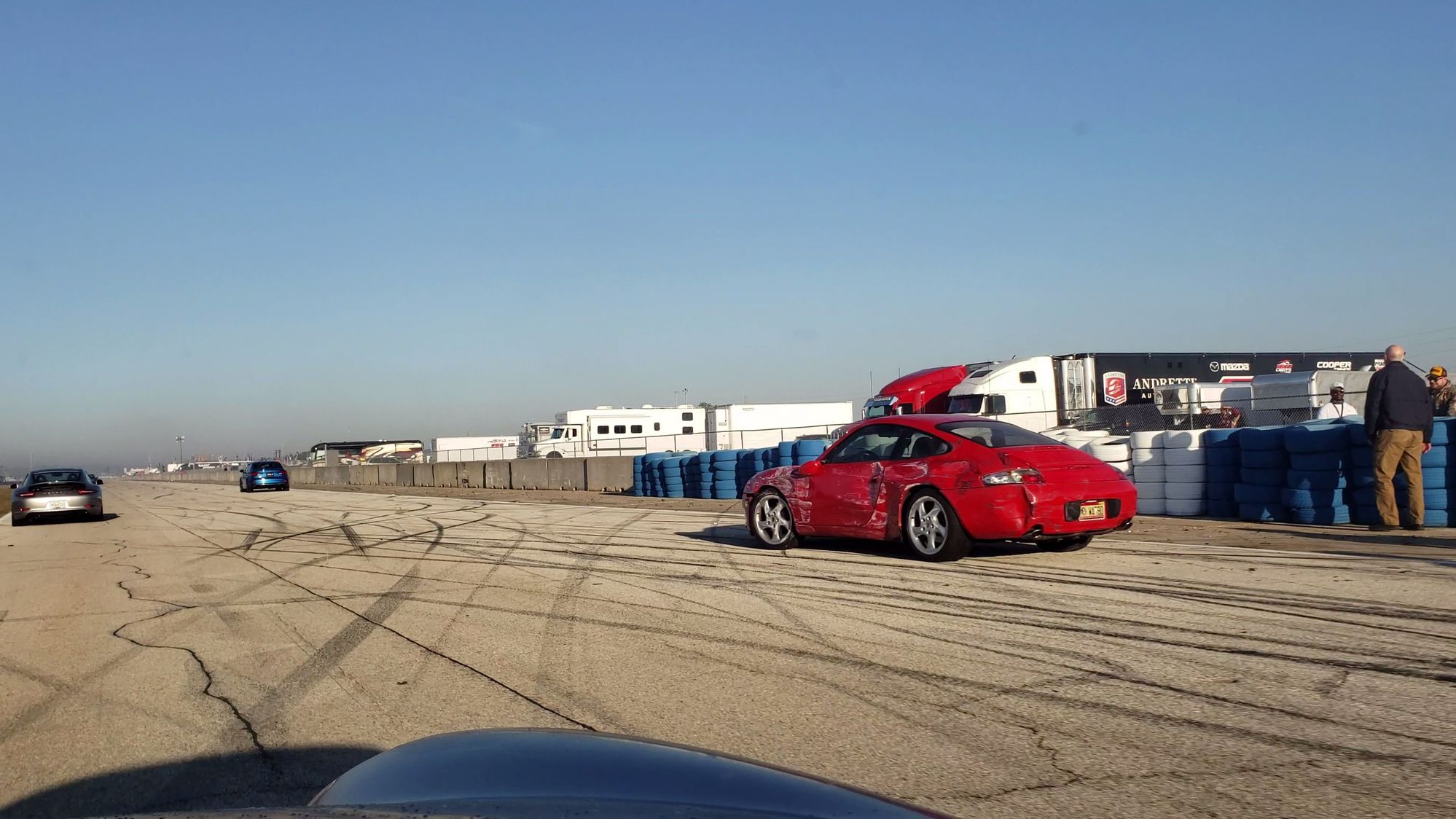

It always reminds me of one of the funnier days in my life when they were doing the 12-hour race at Sebring and all of us at the Porsche corral had a chance to do a parade lap. This is a parade lap. Let me say that again this was a parade lap. I hear two different guys get into their cars and say make sure you turn off the traction control. I immediately said to my passenger.... Watch what happens.
Yes both of those cars had an off track on a parade lap and will never be allowed there again haha.
Parade lap....2018 12 hour race

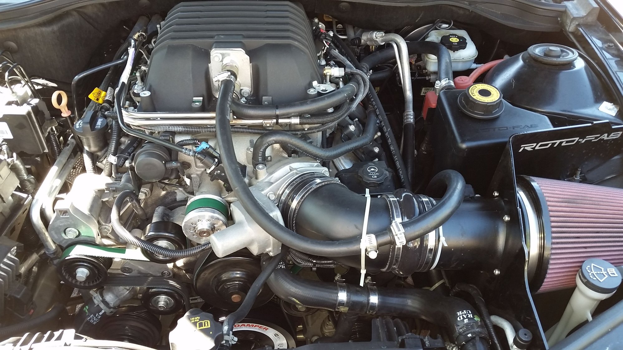

I had a 2010 Camaro SS that I put a TVS supercharger on and there's no way the traction control worked anymore.
I used to say while I was sleeping it stayed up at night thinking of ways to kill me.
You could mat it at 60mph with a straight wheel and it would try and put you in the ditch

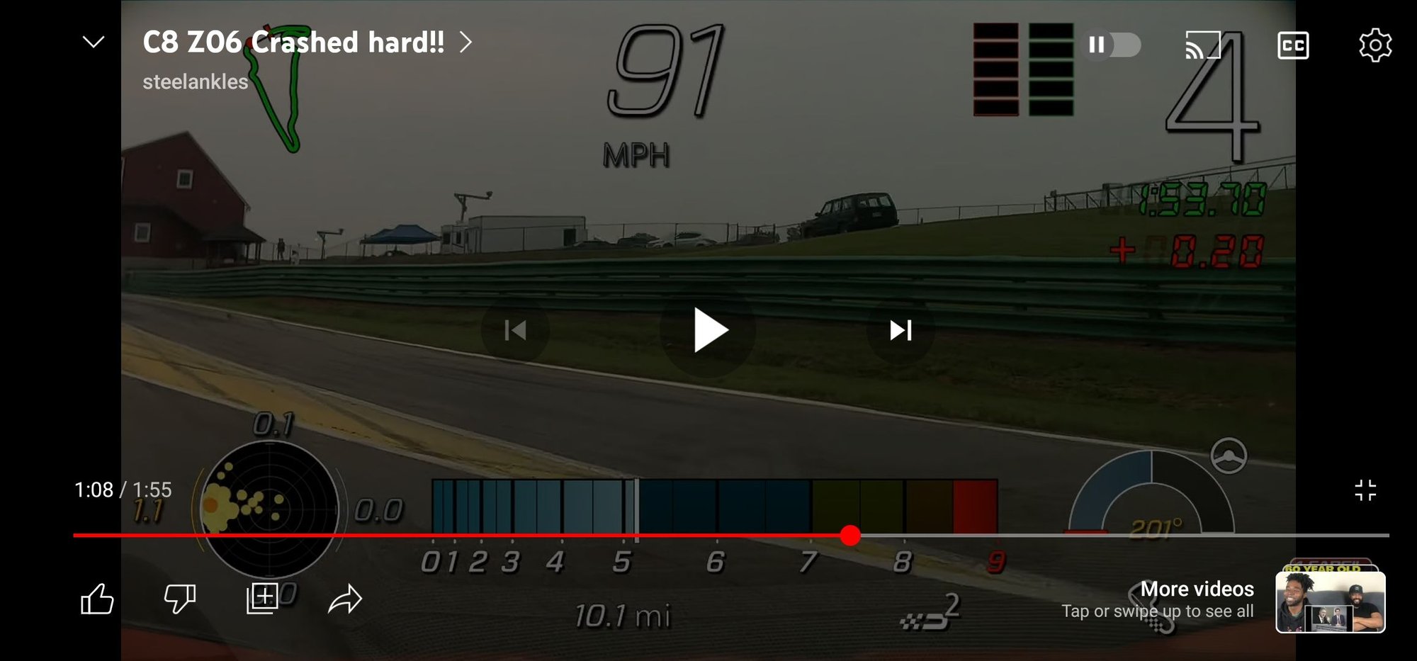

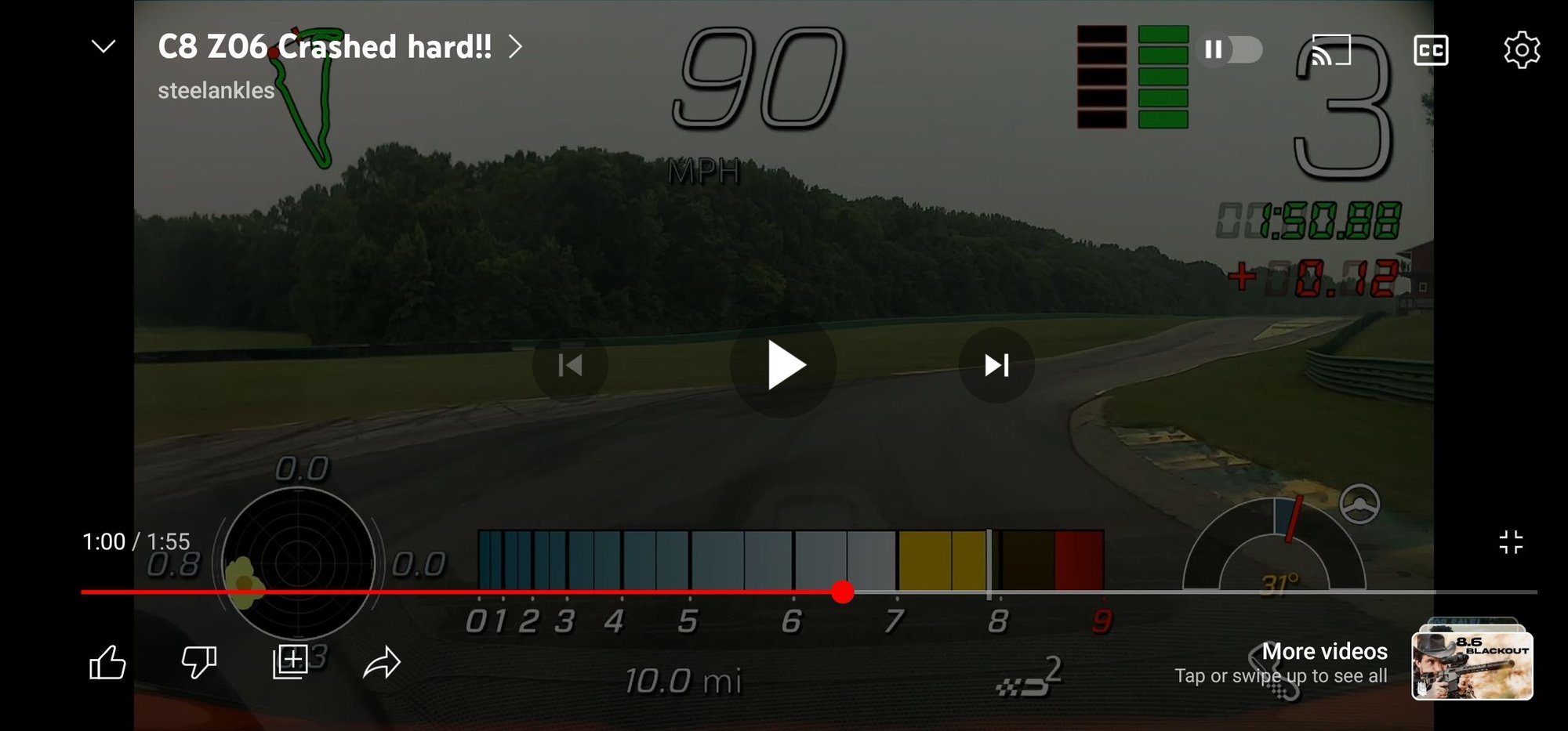

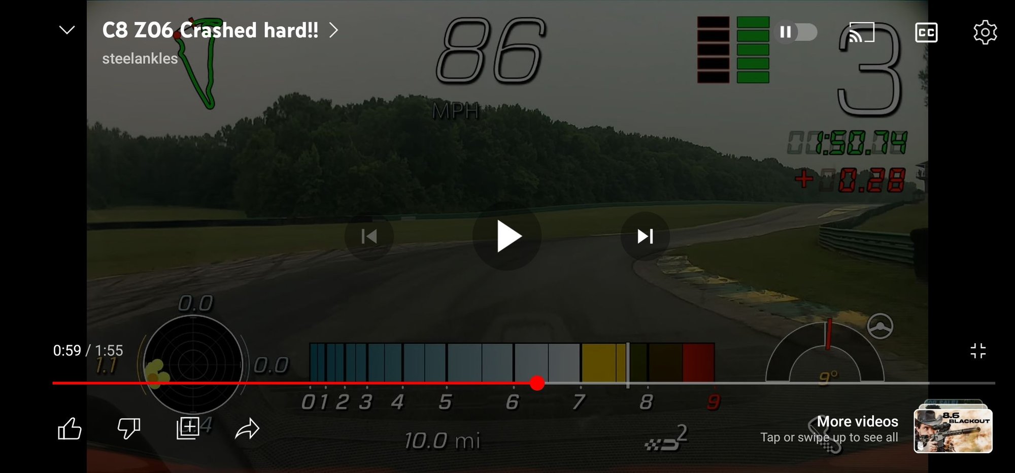

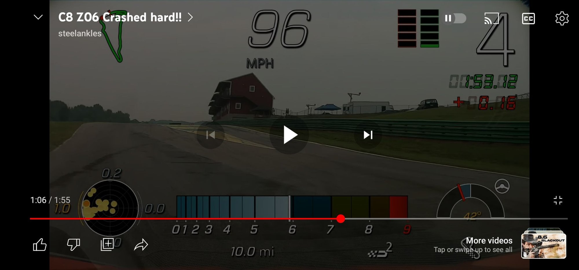

I agree you should not be in full throttle while still approaching an apex. He was too hot in that corner.
I watched the video though and he did not unwind the wheel. There was literally a half second where the wheel unwinds and winds right back to where it was which is just normal reaction to surface changes.
He didn't "unwind" though. He was going to hot and dropped a wheel and doesn't start to spin until he drops the wheel which apparently they are saying caused a damaged tire when he dropped it.
Here he is going in full throttle with 28 degrees steering. No traction control intervention is coming up on screen
Here is a half second later where he "unwinds" but we all have had a half second steering move in a turn when you feel a bump or a slip. This is normal....no traction control intervention is occuring yet either....
as you see within a half second he is right back at 31 degrees steering. Still no traction control intervention.
now apparently he drops the wheel and damages the tire.
Here is the issue. He is already facing the wrong direction and has started to slide. Traction control has still not intervened yet.
Yet he is only counter steering 42 degrees. He probably doesn't realize the tire is damaged and he likely would have needed 4x that amount of counter steer. Easy to Monday evening quarter back it but that wasn't enough counter steer...
this is the first point in which he aggressively countersteers. It was way too late....still no traction control intervention....
And this is actually the first second traction control kicks in.... after he has already made an initial impact....
I'd guess that was ptm race 2. If it has been ptm sport it would have intervened earlier and may have given him that bit of extra time to have initiated more countersteer.
