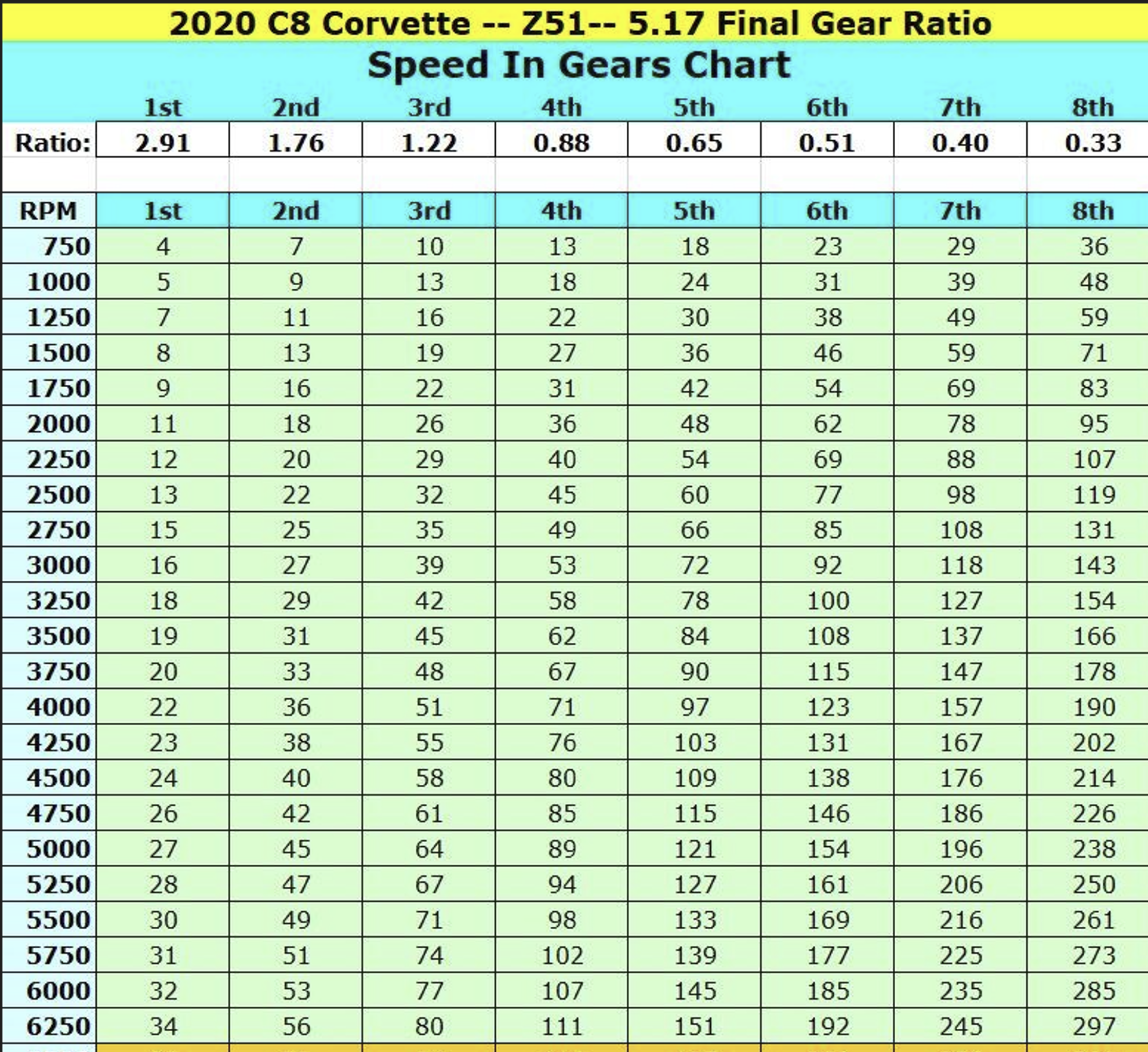

Edit: this is not a response to the post above. I was writing it when it was posted. I'm not disagreeing with anyone that is sensing actual lugging - I'm just presenting some stuff on how it is supposed to work.
I do not believe the car can lug (if it is working right) and I do not believe that it lugs in AFM -not if it is working right. It is supposed to force a downshift even in manual shift mode. OP mentioned hearing knock. I never hear any engine knock, not even briefly. As I described in post 10, in AFM , I can sense something in the drivetrain the is reminiscent of lugging, but it is not lugging. And most do not even notice it.
As for actual lugging, the manual give no definition but says don't lug and don't let the engine labor. It is never defined, but refers to driving car in a gear that is too high for the speed and especially trying to accelerate like that. The resulting sensation is a low rumble and shaking sensation. Difficult to achieve with the C8 even in manual mode. It will automatically downshift, even in manual mode. A clue can be had to what lugging might mean by looking in the manual for the minimum upshift speeds for the Z and non Z car. Upshifts are inhibited below those speeds. Presumably the car will also downshift below that speed if the gear is too high. Using those tables in the manual, and table of speed vs RPM for each gear, for the non Z car, I calculated about 1100 RPM for first gear, and just under 1200 RPM for all the others. For the Z car, I calculated 1000 for first gear, and a little over 1200 for the other gears. The differences might just be rounding errors - the speeds give in the manual are to the nearest 1 mph - and the manual says they are "approximately" the listed speed. But around 1200 RPM +/- for all gears except first. Some may consider that lugging already. I won't disagree - its just what does. And, it may be that there is some hysteresis between the upshift allowed and the downshift required - probably is - so the automatic downshifts may be a touch lower than these numbers. I have never actually watched it while driving.
As an example, the table in the manual says a minimum upshift for the Z car into third is "aproximately" 16 mph. Using tables for speed vs rpm, that corresponds to 1250 RPM. For upshift allowed. Automatic downshifting may be a touch lower.
Here is the Z table.
