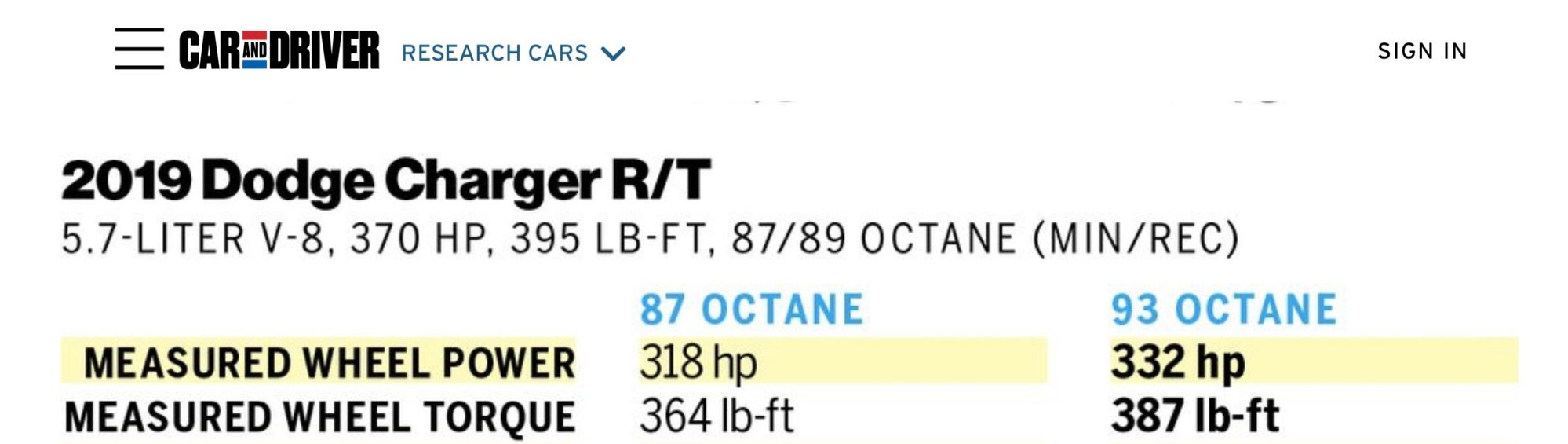

Not the LT2 I realize, but a lower hp 10.2:1 port injection NA V8 that was “tuned” for 89 octane though can run on 87. 93 is clearly overkill though it still made a noticeable amount more power than 87, which I think is similar to what you’d see with an LT2 on 94 vs 91. Not sure what octane is used for SAE testing exactly, but the last sentence in the link below comes as no surprise. “The vehicle with the highest compression ratio technology showed the largest and most consistent octane appetite.”
https://www.sae.org/publications/tec.../2020-01-0619/

We saw similar results with the stock LS3, moving from GM's recommended 91 to 93. And to 94/95 in some cars. Data confirmed less KR, less timing pulled, and higher MAF throughput, not to mention higher trap speeds, if you're into those things. Once we started tuning, 95/96 became the sweet spot for those who could get that octane.

And that’s a 10.7:1 SCR port injection/fixed IVC engine vs 11.5:1 SCR direct injection/variable IVC which is more sensitive to octane I’d say.
