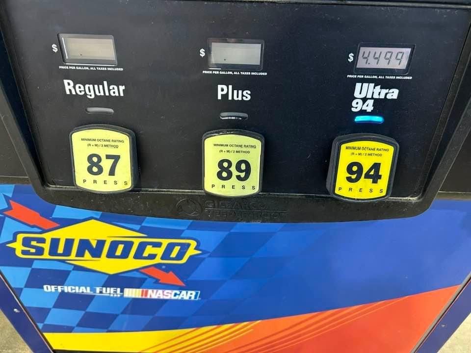

Some Sunoco stations around here have 94 octane premium, anyone ever run it in their C8?
I have. The locations along Dallas North Tollway have it so I've stopped at the Plano station a few times since its only a few exits south of my office.

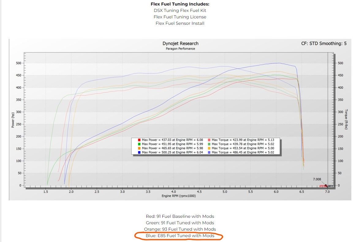

All I'm saying is the fact that a LT2 is still a basic small block, you can change fuel timing and volume, you can change cam timing although you can't change cam LSA, you can change spark timing, but you can't change the maximum combustion chamber size or compression ratio..
Bang for the buck is dismal on a naturally aspirated engine with ethanol. Your better off doing Nitrous with your money.
If anybody has any hard data from a LT2 on an engine dyno I would love to see it.

https://www.paragonperf.com/C8-Corve...ing_p_929.html
Explanation of the mods and parameters in the video, above link;
