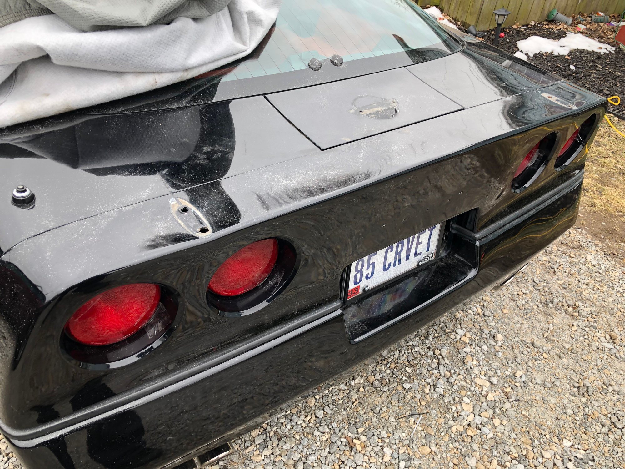

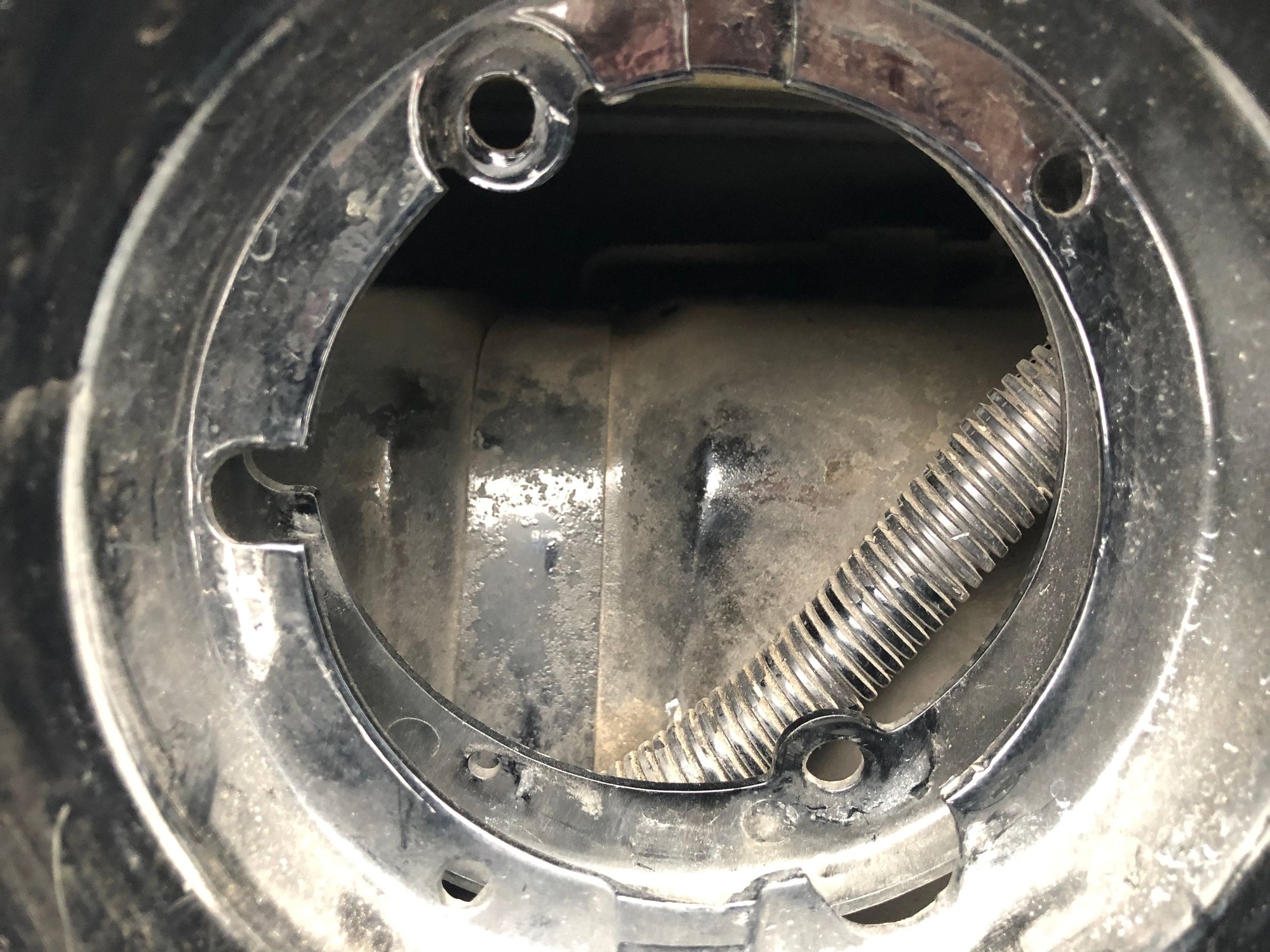

I got the twilights out but how do you get this little bracket they go into off. I need it off to reach behind it to take off the spoiler. Here a couple pictures of what I mean. I took off a bolt but can’t figure out what holds that part on. The spoiler bolts on to the bumper behind where they are attached so I can’t reach the bolts to the spoiler.

IF your rear spoiler has a nut or bolt that is in between where your taillights are..I have had to come up from the bottom to get it with a long extension and I can generally see it. So when i know I can see it...in most cases....I can get to it. . And even though it is a pain in the backside...it can be done.
These taillight retainers are pop riveted to the metal retainer that is attached to your bumper so you can install the sheet metal screws.
Removing these would be a problem.
On some cars I take of the rear bumper while it is still attached to the bumper and then take it off and when I go to put it back on I get the bumper all set then install it.

Ok, thanks again. One thing I wondered is how would I get it back on if I do get enough room with an extension to take the spoiler off?

I honestly do not know how to answer that question do to I run into scenarios like this and the time it takes is just that...the time it takes and having to be really good at problem solving and using common sense...such as using soft putty to hold the washer and nut on your socket when oyu work it back up and try to get it to start on the threaded stud of the rear wing or if you need to install a bolt....figure out how it will work
You just have to figure it out because I cannot see what you have going on ...so I am commenting literally blind here and only able to comment from past experiences and what you say when you type out your concerns. As you are finding out...working on cars is not always as easy as some people may think.

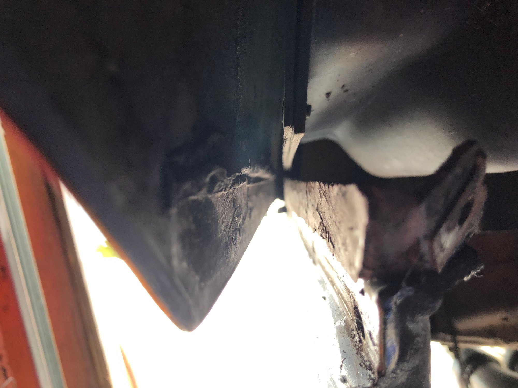

I got quite a bit done today. I removed the corner lights and the rear quarter panel front and rear side moldings on it. There was a few nuts that were rusted with the stud but I used an angle grinder and cut them off. There’s one thing that I needed to ask about though. I was about done with the passenger side and noticed that this came loose.
Its where the rear quarter panel bonds with the bumper. Once I put it back together you can move the quarter panel back and forth a little bit then. I didn’t think it looks that hard to fix but wasn’t sure how to do it. I was thinking I could get some body filler and put a layer on there and hold them
together so they bond together again but figured I would ask you if this would work good. If it’s something hard to do then I will just not do anything and ask Maaco to fix it when they paint it.

I cannot comment on where and what to use on this area you feel it needs to be bonded due to I cannot see anything in your photo due to lack of proper lighting.

Ok I’ll get some better pictures sometime. I don’t know why I didn’t get a picture from the outside I just noticed that. on the bottom picture that is the passenger rear quarter panel separated from the place the bumper is bolted to. I meant to get a picture from the outside but forgot all about it.

If you are referring to the fiberglass retainer that was bonded on your quarter panel. The stuff you were thinking of using will not work. You need a 2 part product like SEM 39747 to bond that piece back on. CALL SEM directly and they can get you one to use...via through their local rep..
