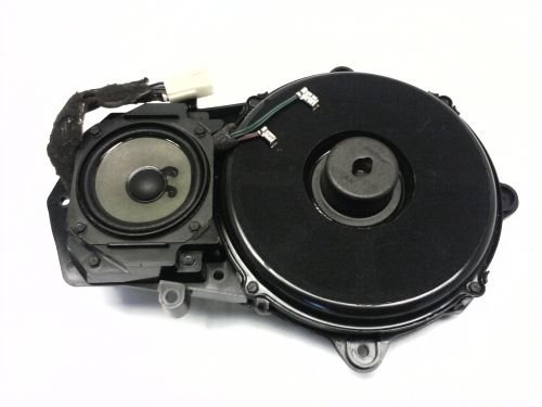

ok, just looking for a quick answer... what size is the stock Bose speaker?
saying one "can fit anything short of a subwoofer" doesnt really nail it down. One can order an 8in 3way speaker... will that fit? How about a 10in version?
a simple measurement of the stock speaker will clear this up.
any help?
EDIT - Nevermind... I found it (on a different forum)... the C5 Corvette Bose Door speaker has an 8in woofer.

It's not easy to squeeze an aftermarket 8" speaker into a C5.
Post #3 of THIS THREAD has good pics of what you're looking at. 6.5" is about as big as you'd want to go.

Default Front Speaker replacement
I understand the stock Bose speakers in the front doors of my 2003 C5 are 3 1/2 diameter? Will a 4 inch diameter speaker fit into the same cavity without having to do any mods outside of drilling a couple new mounting holes? Don't want to find out different after pulling the door panels off.
There is a wider selection of 4" speakers then 3 1/2. Like Cerwin Vega seems to have only one 3 1/2 speaker option.
Old Dec 23, 2016 | 10:24 PM
  #240
markcz's Avatar
markcz
Joined: May 2003
Posts: 7,035
Likes: 134
From: North Augusta, SC
If you're replacing the stock C5 mounting plate with an aftermarket plate, then you might be able to use 4" on the top, if you're just swapping speakers then they won't fit on the stock plate.
