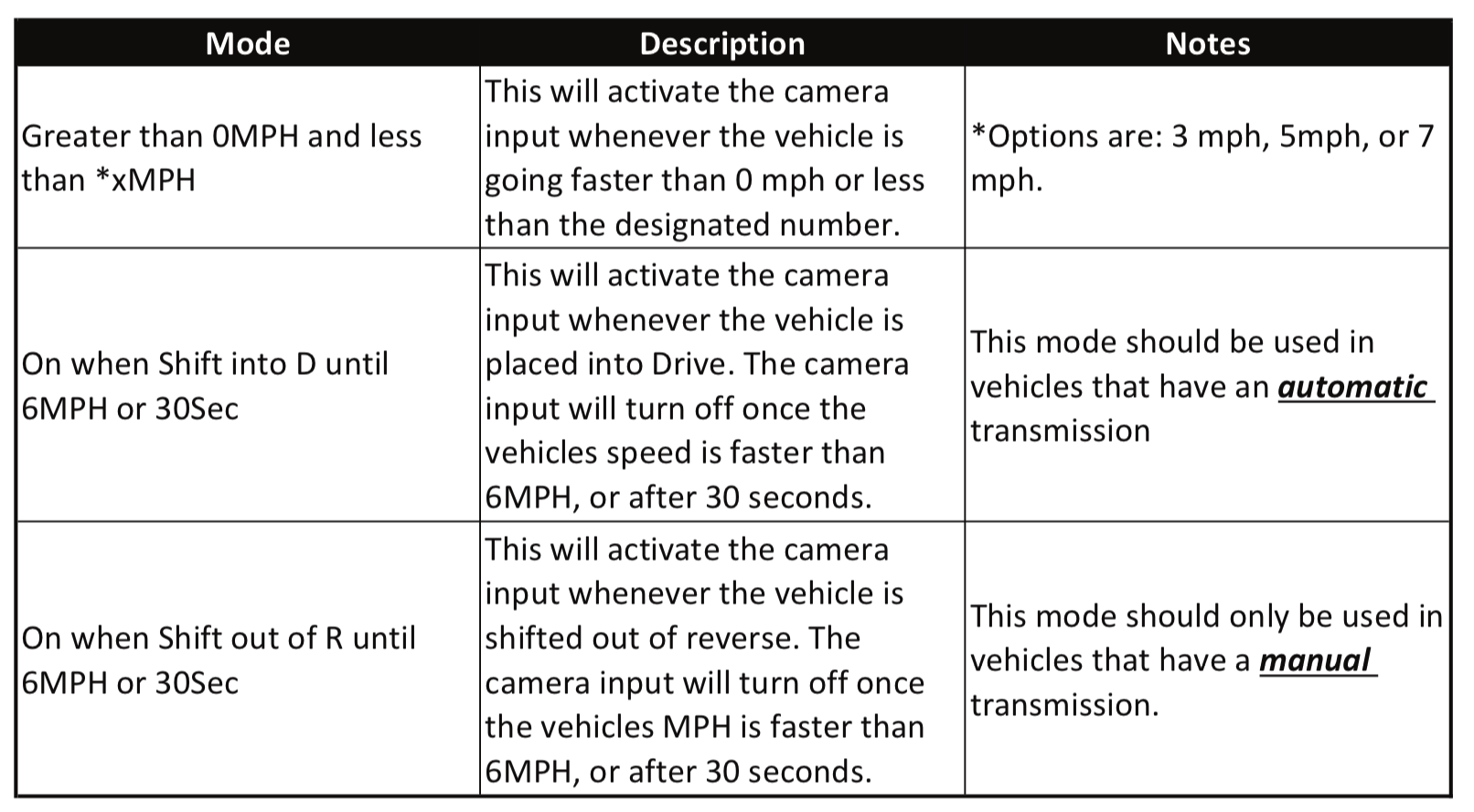

These are the different camera settings I was referring to earlier when using the VS41 in conjunction with the GM1A-RST. I thought I'd give it a try, I came across a VS41 on eBay for $70, so I bought it. Don't you just love playing with this stuff ?

Getting the VS41 in the mail today, going to mess around with it in the next day or two, I post my findings here when I'm done playing around with it.

I got the VS41 installed today and it works good, I set the camera setting on 0-5 mph. Took it for a little cruse today and I gotta say it's kind of a nice feature having the front camera come on automatically when pulling up to parking blocks to see how close I am, I was concerned however about it coming on every time I pull up to a stop light/sign, but honestly, I didn't really even notice it. I installed the unit using this set of instructions. https://pac-audio.com/index.php?cont...ttachment=1598 I only had to connect the purple/white wire from the VS41 to the purple/white wire from the Pioneer system, and the white wire to the purple/white wire from the GM1A-RST, and plug the RCA cables into their respective connections. Because I only have the two cameras and the VS41 is made for four cameras, I may just remove the additional wires/pins from the connector to help reduce the clutter behind the dash. One other thing it changed, is that I'm no longer able to switch the cameras off and on from the head unit like I used to be able to do, I'm thinking I could address this by using some RCA Y adapters, then I'd have that function back also, I'll have to pick some up though, because I don't have any on hand.
