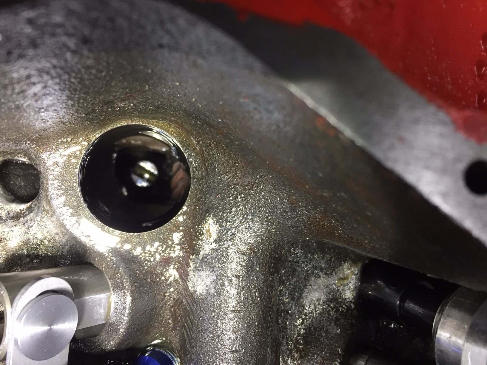

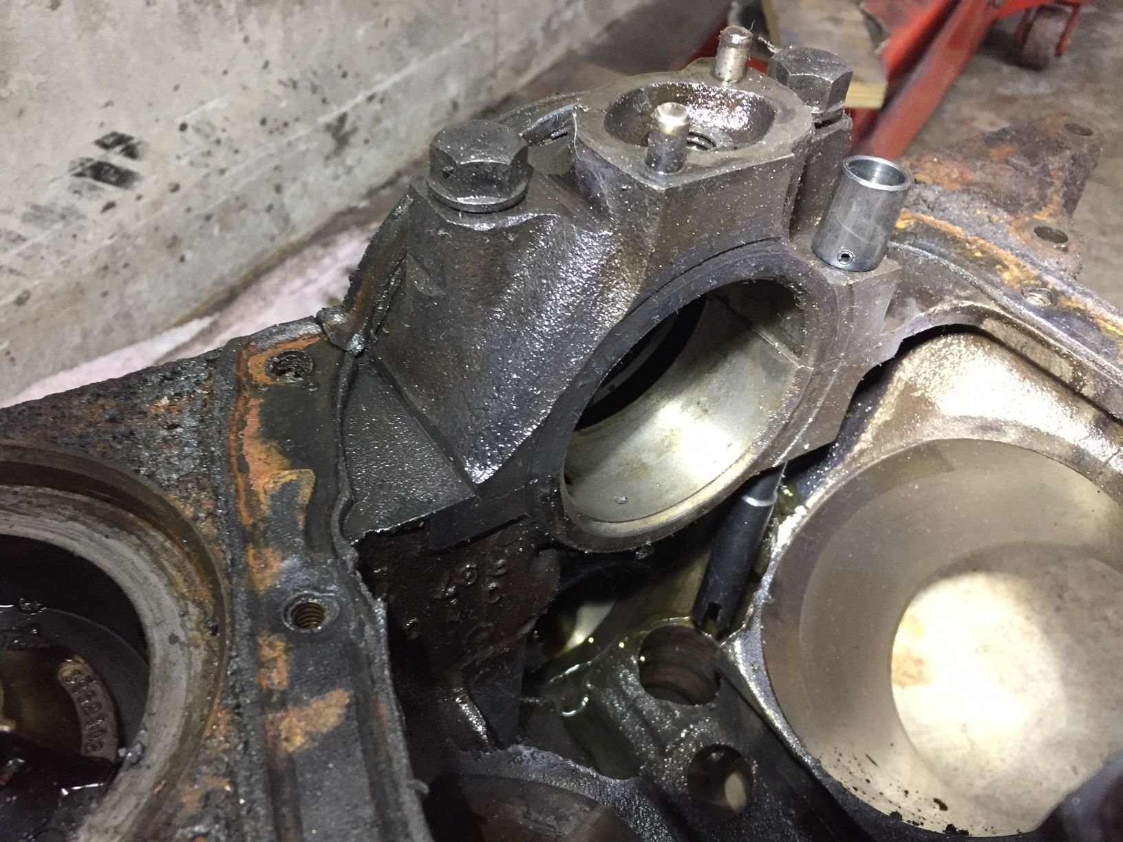

After 3 pages I can't believe I am the only one with an extra engine block laying around.
By removing the pan you get a visual of the gear and pin. It also allopws you to remove the oil pump and oil pump drive shaft as that might be stuck on the end of the dist gear and removes one more variable out of the equation. Now if the pin is out and not allowing the dist to come out you really have no room to work as the crank and rods are in the way. There is also no room to drop it out of the bottom but that would require wrecking the dist mech advance.
If the pin is not out of line you could use a small brass drift through oil pump driveshaft hole and tap the dist up.
These photos should help clear things up.
Picture from the top of a 406 I'm building now.
The next photos are from an old block I have.
Underside of block where the dist gear interfaces with the oil pump driveshaft
Photo showing how the oil pump drive would be in the block.
