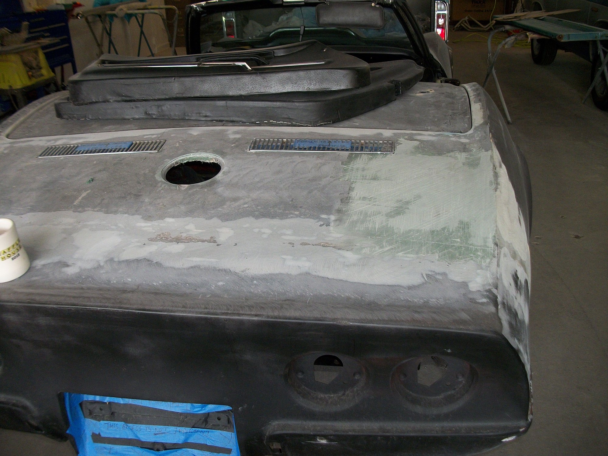

Old Apr 22, 2019 | 02:22 PM
  #4849
doorgunner's Avatar
doorgunner
2026 Loser of the Year
Posts: 36,607
Likes: 7,053
From: New Or-leens Loo-z-anna
I took a few pics today......….the silver convertible on the far-left is ahead of my car..………......………..
The doors are off......one door is in another room being prepared for primer...…………………...……......
Meanwhile......he is filling in the really low spots on the doors and body...………………………………......
I may be able to get more pics tonight......he told me to drop by/there is a good chance he will be working on it.
Well......back to the garage to add more elec. outlets.

Looks like he didn't fill in the seam around the back deck... the gills in the fenders. You staying with the 73-up style?
I have a pair of repair-gills and the chrome inserts to make 'em pop in the gloss black paint.
I oughta' take a heat gun to the Paint shop and remove the clip since it is "un-bonding itself" at the firewall. Then I can install the gills, repair the. Crack in each fender arch, sand off the 3 layers of previous black paint while the car is being painted from the doors rearward. The hood is already painted.......
