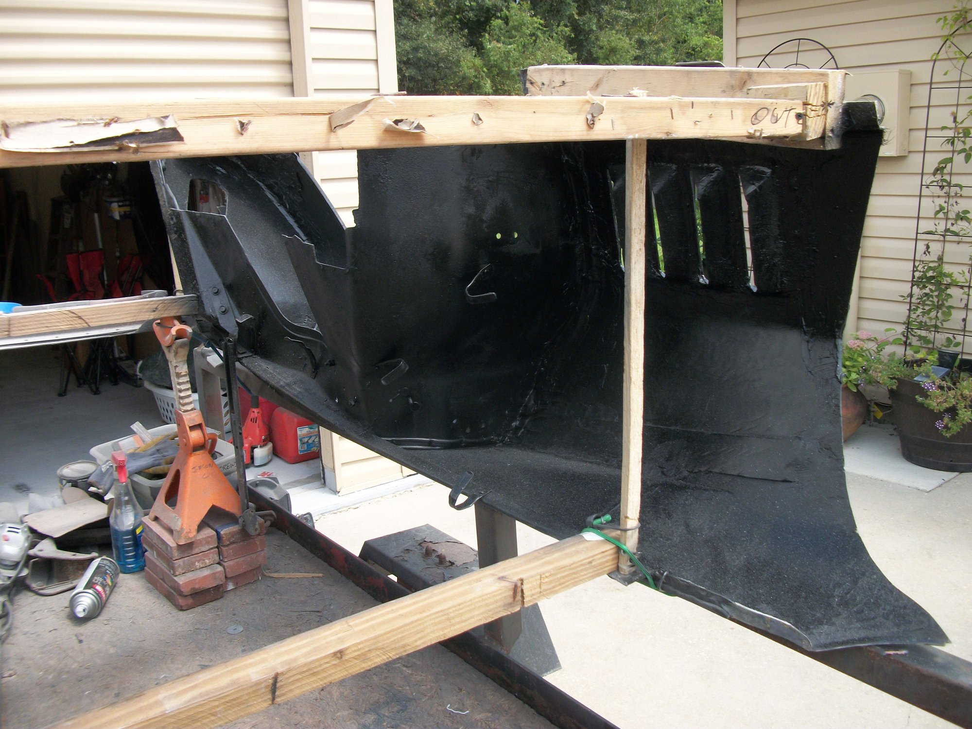

Late this afternoon I decided to remove some of the crud from the wheel wells/etc. The 4"dia. sanding disc kept clogging up with grime so I switched to a 4" dia. brass wire wheel which was 3 times faster than the sanding discs...…..
BEFORE...……50 years of grease/grime dead raccoons/dead armadillos/etc…..
AFTER...………much better, but more sanding to do…….
Kinda' clean now...…..
Still a bit nasty...……..
I'll clean and sand the other wheel well/inner fender tomorrow....then begin fiberglassing the inside areas where repairs were made.....and re-bond the inner fender splash panels.

Satin black would hide everything in shadows and it actually looks good

Even while the satin paint is still wet it looks better/hides rookie work
The rectangular white areas on the fender lip need more fiberglass mat to fill in the low spots...…...

Annnnnd has worn meself out also.....I did break away and beatified the underside of the clip a little more....driver's side...…..
Passenger;s side...………...
Passenger's side wheel well...……...……...……….........
Now.....four more areas to build up before I can flip it to the upright position. That's when I'll tape off the areas that I need to "cut off"
I'll post pics so you guys can advise me.
