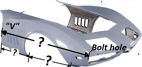

This is the repair piece I will use...……...
6 & 1/4" from hood outboard corner to headlight opening...…….
6 & 3/8" from hood opening to midway of headlight opening...…...
6 & 3/8" from hood opening to inboard headlight opening...……..
*************PICTURE DID NOT TRANSFER TO THE POST*************
16 & 1/2" (?) from hood opening to leading edge of headlight opening (add 1/4" more for flat ahead of headlight opening/16 & 3/4" )…...
16 & 3/4" from hood opening to leading edge of fiberglass flat ahead of headlight opening...……..

How about these numbers?...….I need to make sure the wheel well arches are centered on both sides of the clip.........…...............…...

My headlight to hood is the same 6-1/4. Mine is 75 though. The nose i used for a mold is back in the yard. And it is aftermarket, so dimensions could be off. The REAL dimension you need is the whole hood surround length. Your 68 has the long hood and no wiper door if i remember correctly. Maybe cut your bad headlight piece off flush with the front of hood opening. Then you will have about an inch overlap with Roger's maroon piece. Then put it together with a few small screws or pop rivets saving that overlap for the moment. I have a feeling if you line those 2 rounded hood opening corners up, the nose piece is gonna fall right into place. Then if the paint shop is close enough and the car is where you can work on it, go do some fitting, measuring. Fab bonding strips out of scraps and then even if cut a little short, you have some wiggle room. Cuz if you can get back there with a finished nose before he shoots the paint...

Yep Derek.....what surprised me is the inboard measurement is 1/4" longer........GM/what you gonna do with 'em.

Yea. that's what I'm talking about. Starting to come to life. Do you still need those measurements for the clip? I can get them of the 69 just let me know.
