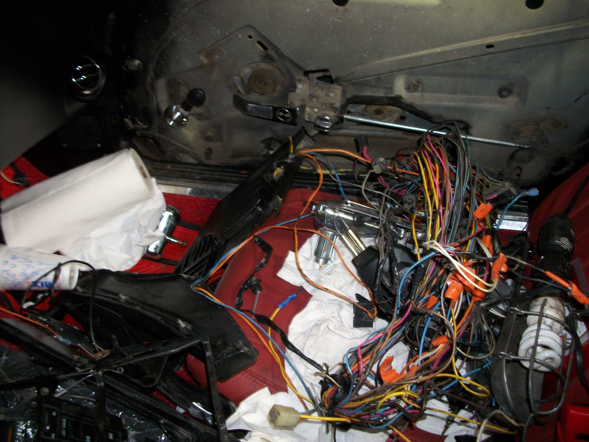

Anyhow................Dash Work Part IV....................
The old wiring harness is getting transplanted one wire at a time.....
The gauge wiring isn't pretty but it's definitely easy to remove the cluster......(Yes....Bubba took a hack saw and a file to the radio opening!)......................
The original lense didn't look so worn until I held it next to the new one.........
I think I'll take Kris' suggestion and add a disconnect to the center console wiring while everything is apart.
(Then it will be time to install the alarm/remote-start module and harness)
Note to self: Reinstall the A/T kickdown switch onto the accelerator bracket

door gunner, that sure looks like a squirrel's nest!!! I hate dealing with electrical. Imagine doing what your doing being color blind. I have to remember each and every damn wire when I work on electric.!!!!! One is solid, one has a line, one has a thick line, one has a thinner line. LOL…..
LOL......now imagine being on PTSD meds and thinking how all those colored wires are "messing with your little mind"! I solved the problem today by taking small pieces of yellow tape and labeling the wires and the connectors.

Lookie what I found on the front porch....................
Only 26 more wires to go and I can put the dash back together!
