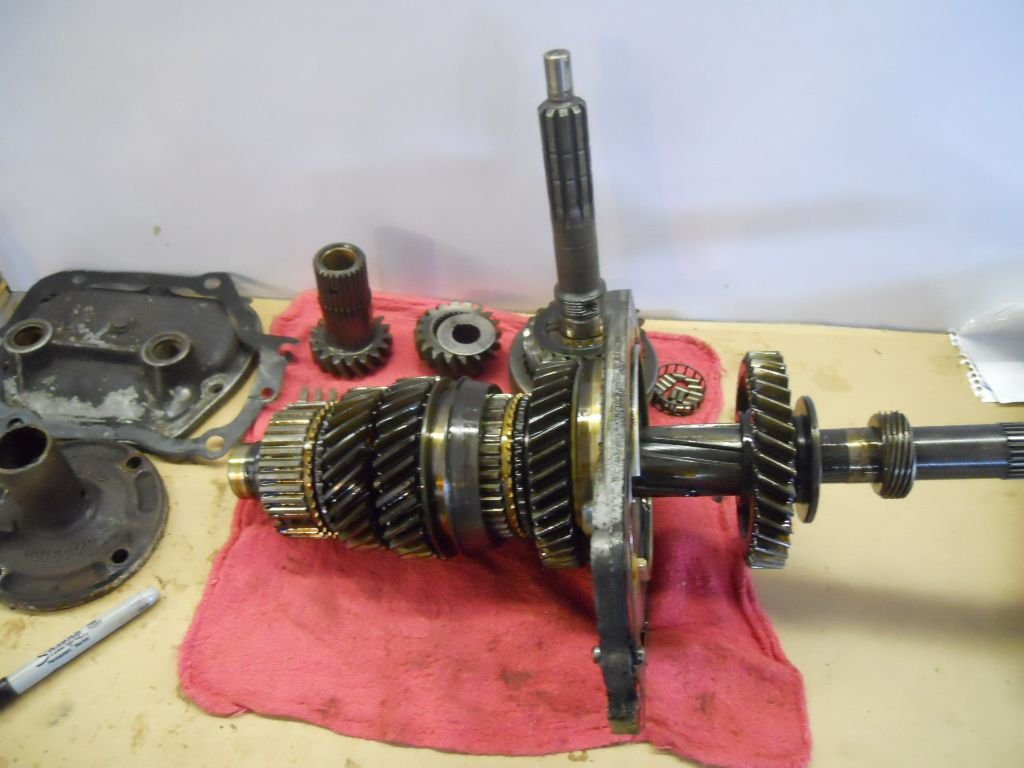

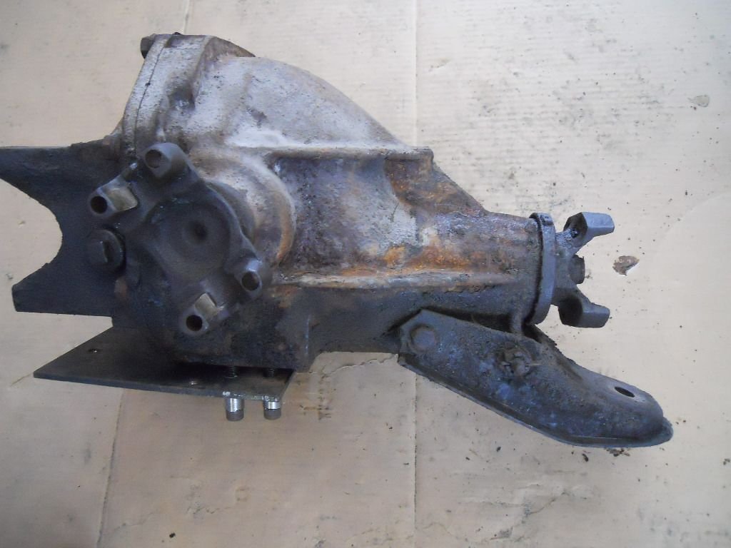

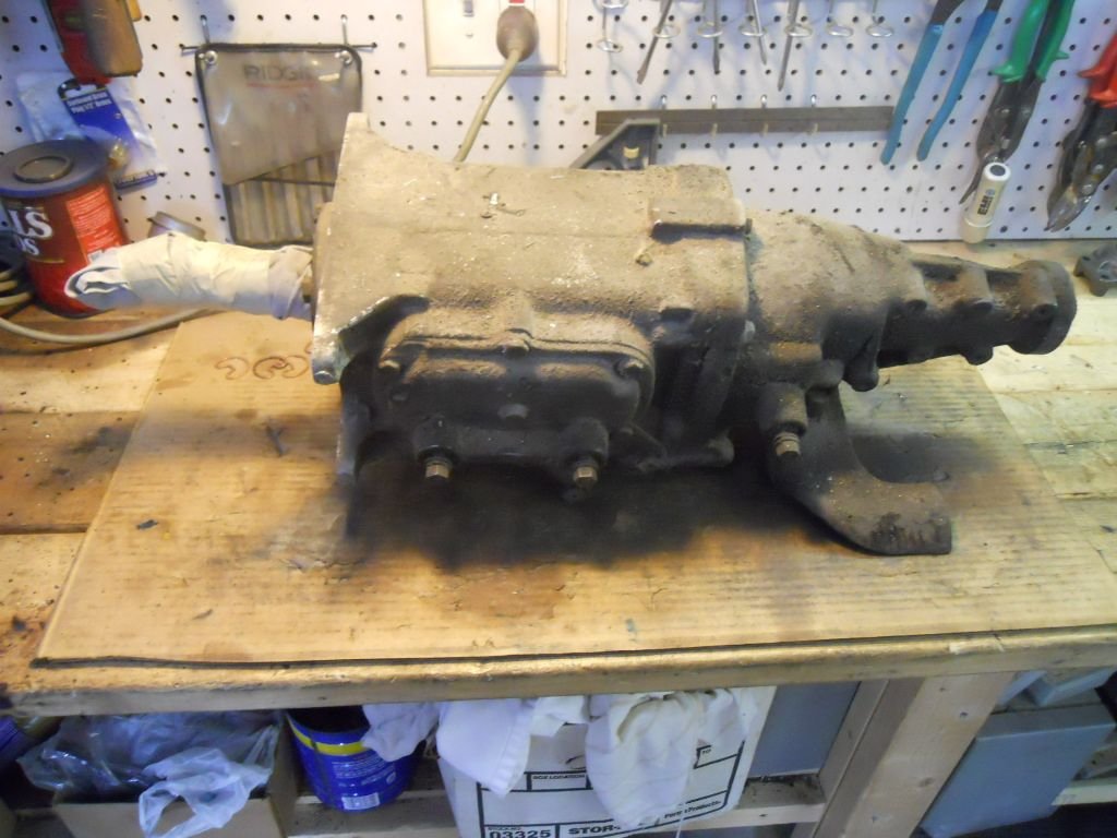

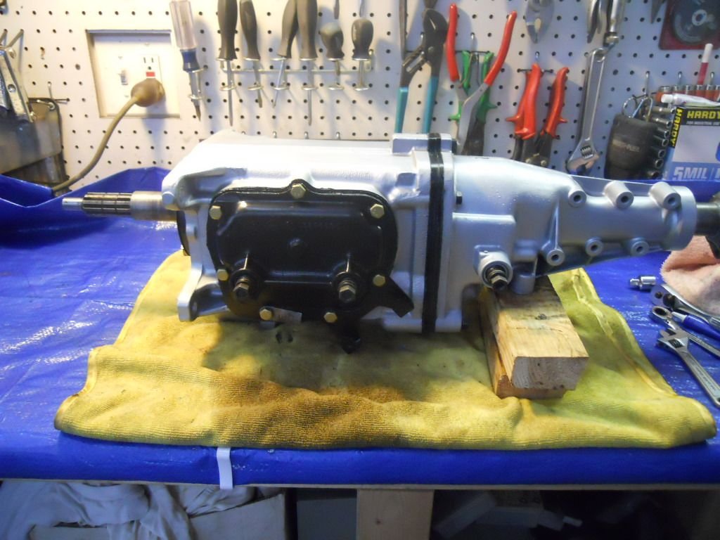

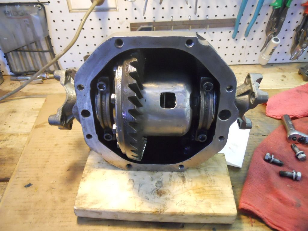

So I've been busy on my 68 restoration. Here is my update. I have rebuilt by differntial and transmission. I lost my job October 16 of this year. So I put my time off to good use and kept my sanity. I also landed a new job that starts January 2nd, so no worries. Here are some updated pictures of my progress. I also want to acknowledge Gary for all his help and walking me through the differential rebuild. I could not have completed it without his assistance. Also Paul from 5speed. He was also great to work with. Both answered my questions and did not hesitate give there advise. Thank you to both.
The differential before;
After;
Transmission Before;
I ended up replacing second and third gears due to the syncro locating cogs being a bit beat. These gears were hammered in their past life.
I will be tackling the L79 next. Updates to come.
Peter

Hi Peter,
Nice looking WORK on those parts!
After;
Peter
Looks great, that looks familiar too. I bought a 68 m21 to replace my current m21 and decided to refresh it while I worked on the rest of the car.

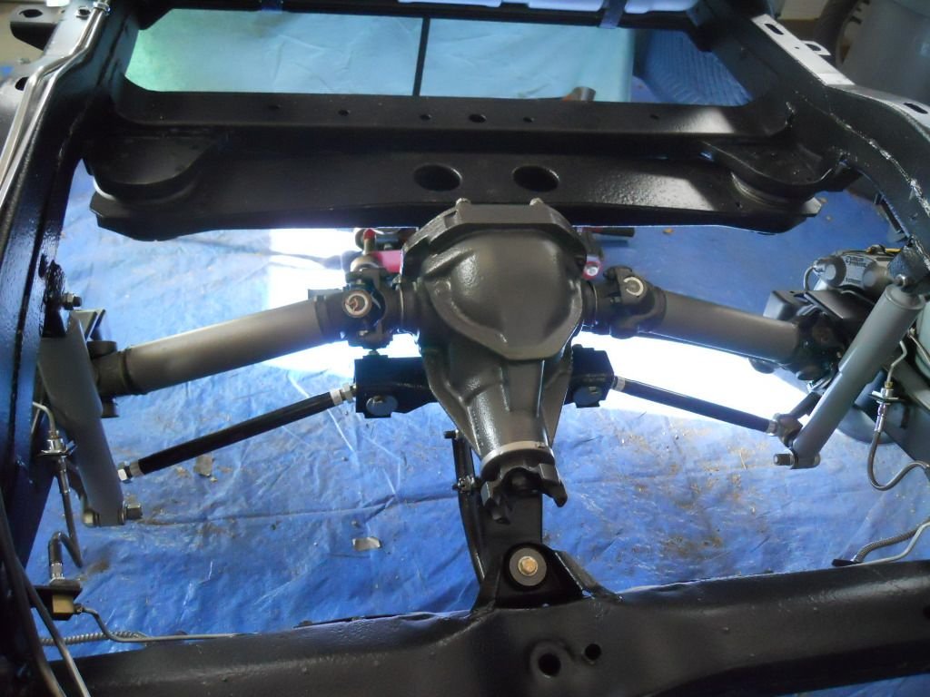

Default Progress Update
Thought I would show some of the progress pictures

Really great work on your car. Nice to see a DIY owner with good refurbish/rebuild skills.
Just curious what is the exterior color on your '68. It appears to have Tobacco interior color, which is not common but very desirable. If exterior is Corvette Bronze, that would be an outstanding combination.
Also, just wondered what shock absorbers you chose. They are painted gray like factory, but I wouldn't think you would go with basic hydraulic shocks on the rebuild, unless you were going for a completely-factory redo.
On the shocks, yes the are just Delco. I was a bit short on funds when I bought them. I may upgrade down the road. The original color is Corvette Bronze and I will be painting it original however the original interior was and will be Dark Orange. The car has a very 1968 vibe.
