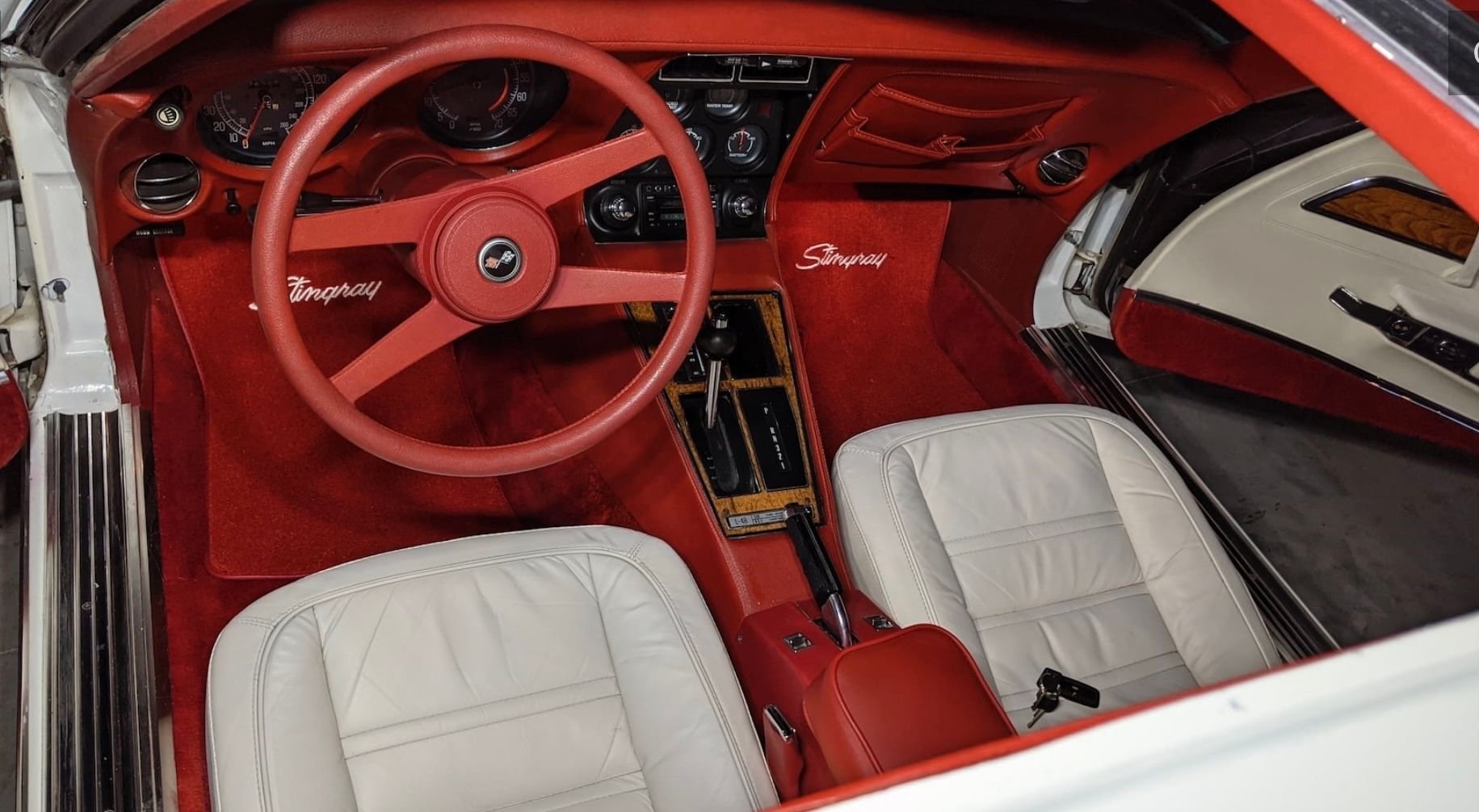

The seller of this white 1976 Corvette is advertising it has "the original white and red delux leather interior" How rare was this option?? it kinda looks awkward like its a mistake

In 1976/1977 the body trim plate code ZJ1 which is located in the upper left corner just above the interior code stands for (CUSTOM INTERIOR TWO-TONE). This option was never listed in any sales brochures or dealer handouts. It took an override to order a new corvette with this option. I have seen only a handful with this code. I have a 77 L-82 4 speed with this override option.

with Beck and have only seen a handful. I have seen white with red; white with blue and white with slate. Rare is probably good word to describe these two-tone interior options but know that rare does not always compute to desirable and therefore command the big bucks.

I don't believe that the two-tone white interiors are all that rare. I've seen plenty of them over the years, especially the white and Firethorn (red) combo.
In 76 and 77, if you ordered a white interior, the door panels and seat covers were white, and the rest of the interior was color keyed to the exterior color of the car. With a White exterior, you had a choice of either a White and Black interior, White and Blue/Green or White and Dark Firethorn interior. For the rest of the 76 exterior colors, the breakdown was as follows.
Silver exterior - White and Smoke Gray interior.
Dark Green Exterior - White and Blue/Green interior.
Mahogany exterior - White and Dark Firethorn interior.
Light Buckskin - White and Dark Brown interior.
Dark Brown exterior - White and Dark Brown interior.
Corvette Red exterior - White and Dark Firethorn interior.
The 77 the white interior two-tone combinations were:
White exterior - White and Smoke/Gray interior.
Silver exterior - White and Smoke/Gray interior.
Black exterior - White and Smoke/Gray interior.
Dark Blue exterior - White and Dark Blue interior.
Medium Red exterior - White and Medium Red interior.
Buckskin exterior - White and Buckskin Tan Interior.
The 76 white and firethorn interior is pretty common, while the white and blue/green and white and dark brown are pretty rare. I don't know if the 77 white/buckskin combination was ever actually offered. I seem to remember reading that it was cancelled before production began?

The headliners were red (technically "Firethorn"), as were the a-pillar moldings, the rear interior quarter trim panels, the targa bar headliner and the T-bar molding between the tops. On the two-tone white interiors, only the door panels and seats were white, the rest of the interior including the tops, all trim panels, dash, console and carpet were red, or whatever the interior's primary color was. The t-top headliners would only ever be black in a car with a black interior.

I have one just like the photo.... found this one a website: https://www.corvettesalvage.com/c3-c...Ga0a47JQGRZa5J
See the '76 color chart.

‘76 White and Firethorn
