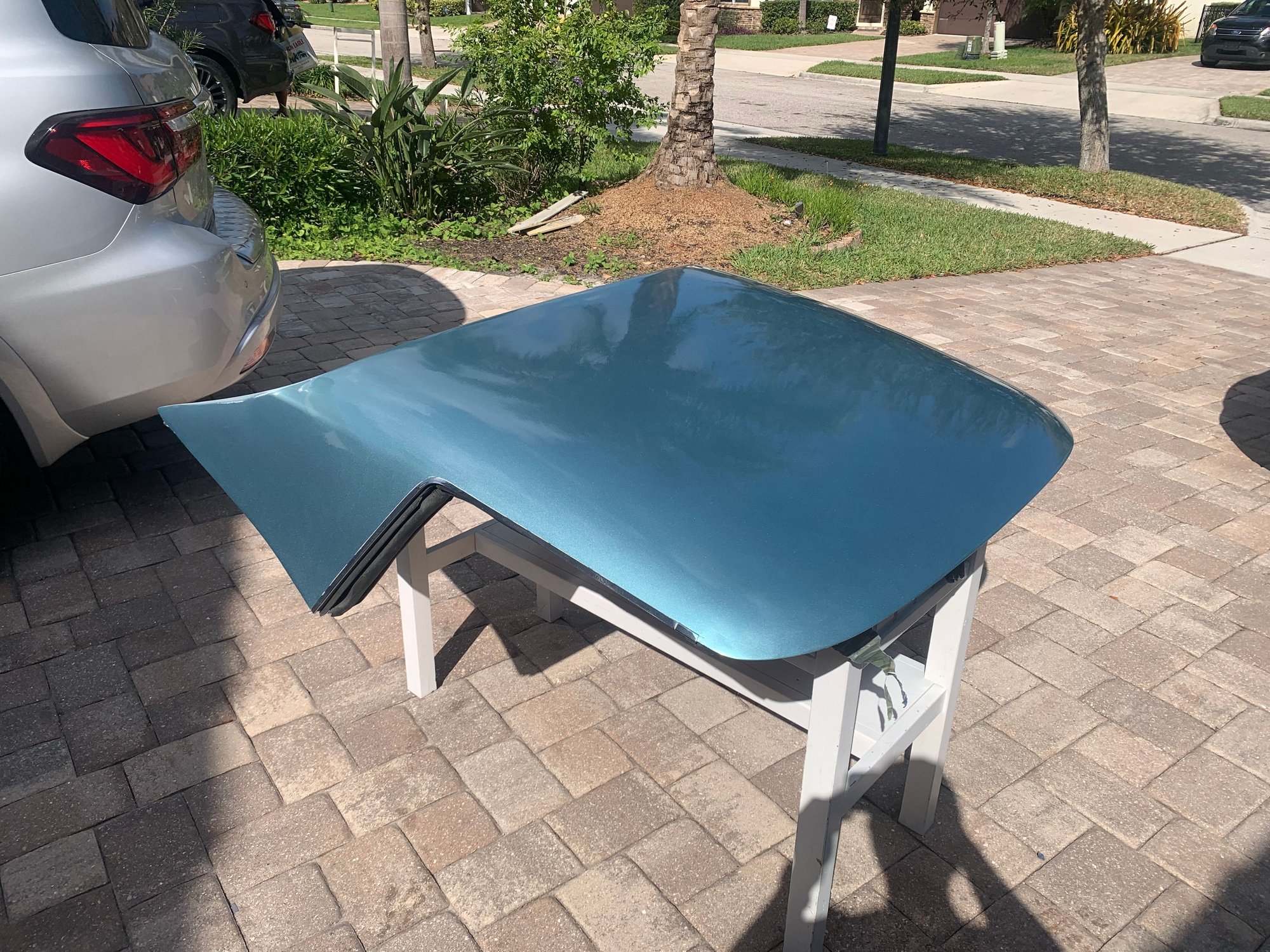

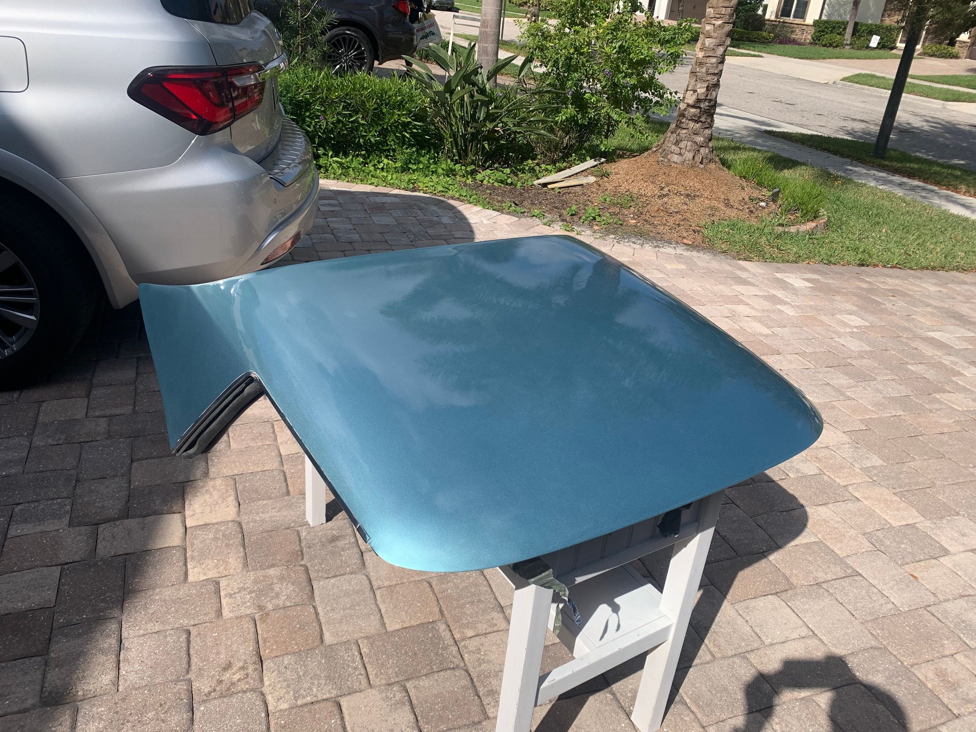

Cleaned it up and polished the chrome trim. Still need to put in the corner pieces.

That hard top needs to go on the car, at least long enough to snap some pictures.
Best looking C3 is a convertible with a hard top.
I’d swap my 73 coupe body for a 73 convertible body in an instant, put the hard top on and never remove it.

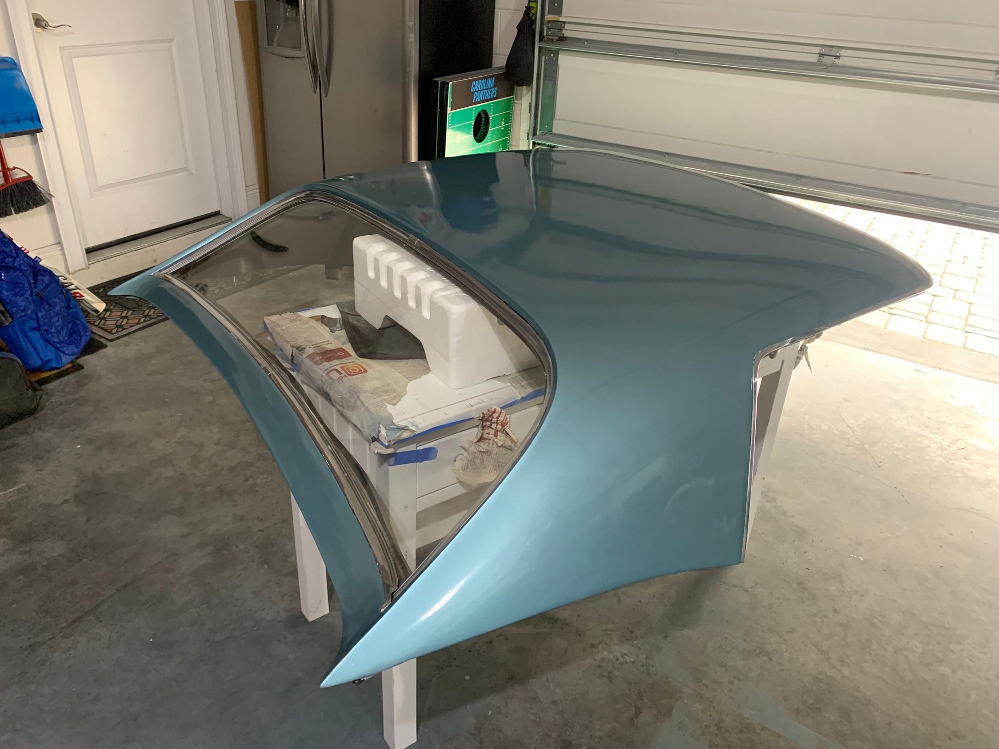

I have new seals for it that need to go on first. Don’t want to scratch the new paint once I spray it.

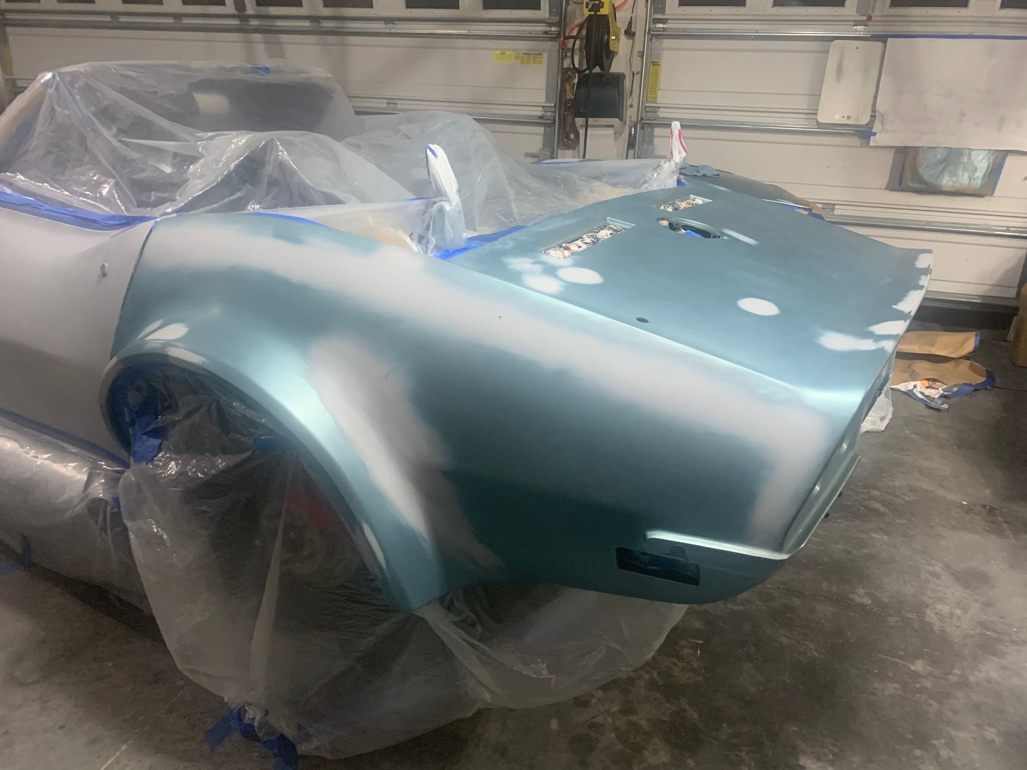

Thanks. Body work has been a huge learning experience. Planning on spraying base this week. Then I will de nib the base since this is all garage built. After de nibbing I will apply two more coats of base to get the clear on. 4 or 5 coats of base so I can wet sand and buff afterwards. Slowly but surely.

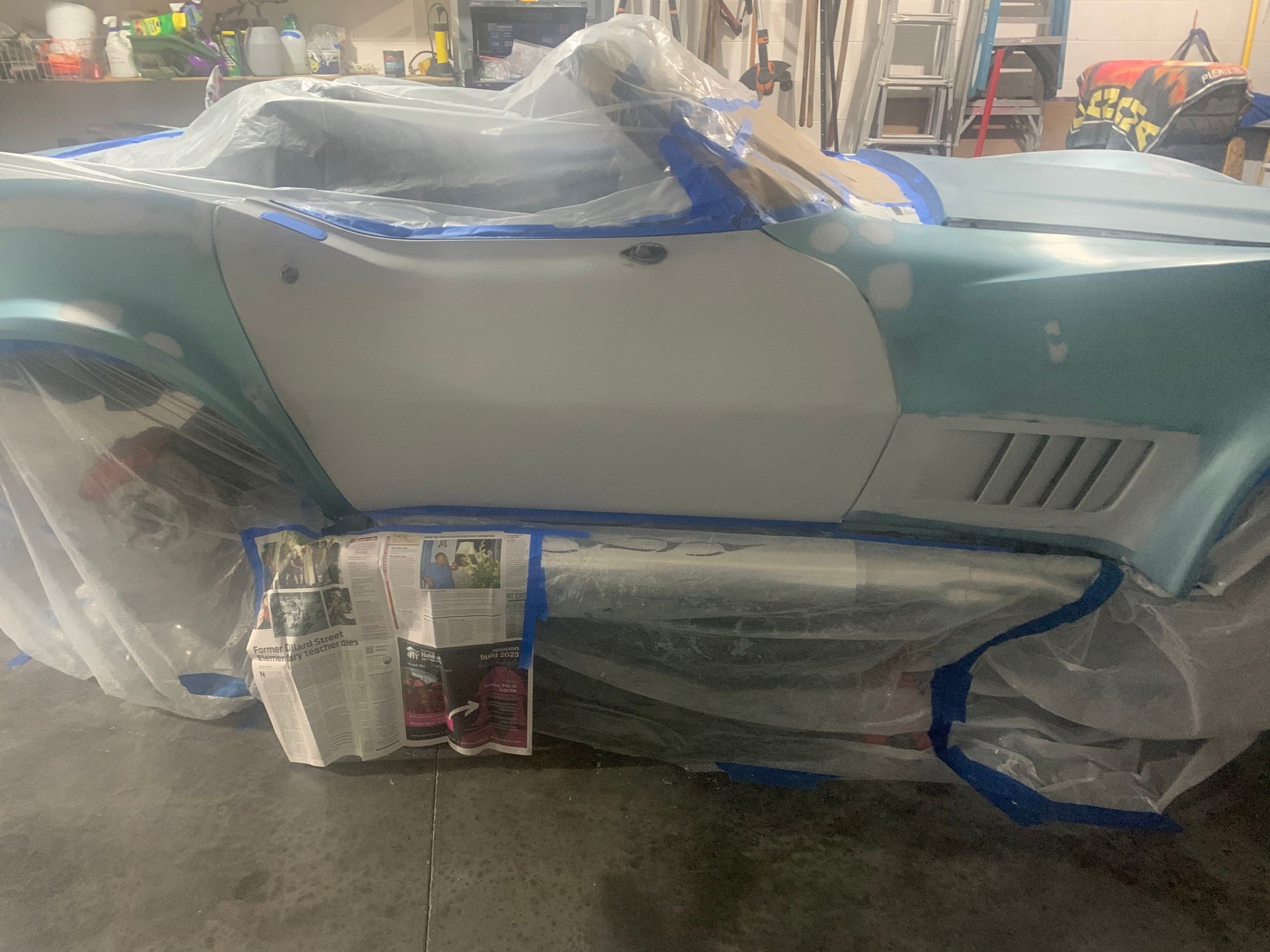

Hope to have the car masked off today and maybe basecoat tomorrow

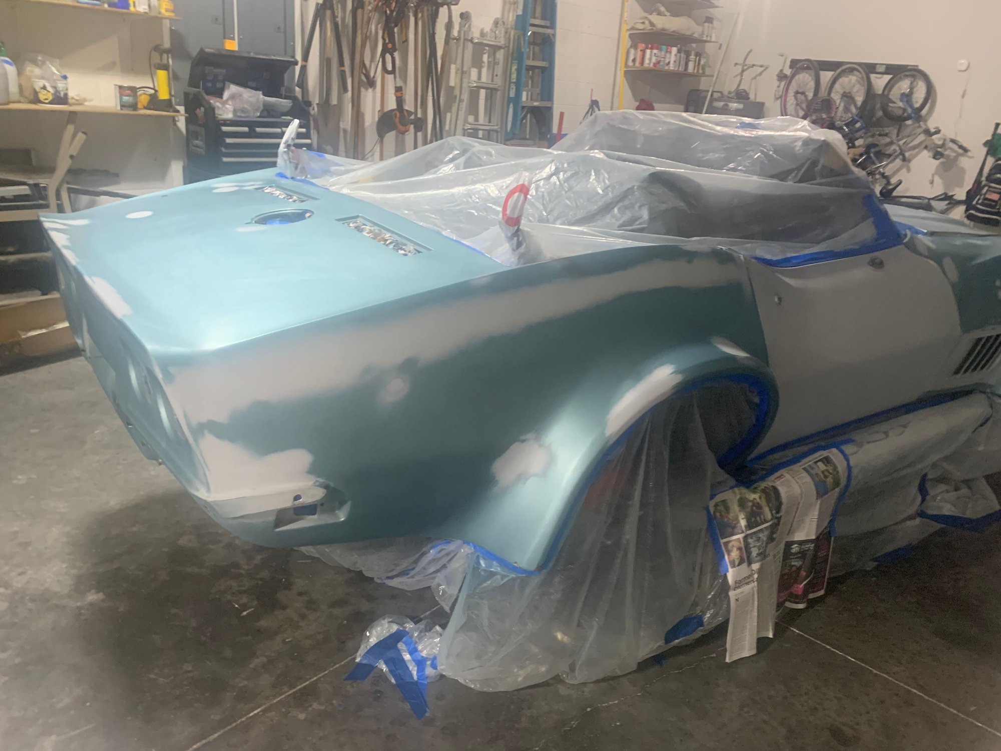

Man, masking is a major pia. Should be spraying base tomorrow ho
pefully

Originally I was going to. Based on limitations of not doing this in a booth and never having painted a car before I spent more time prepping and cleaning the body. It’s what best works for me and worked well when I tested this process on the hard top.

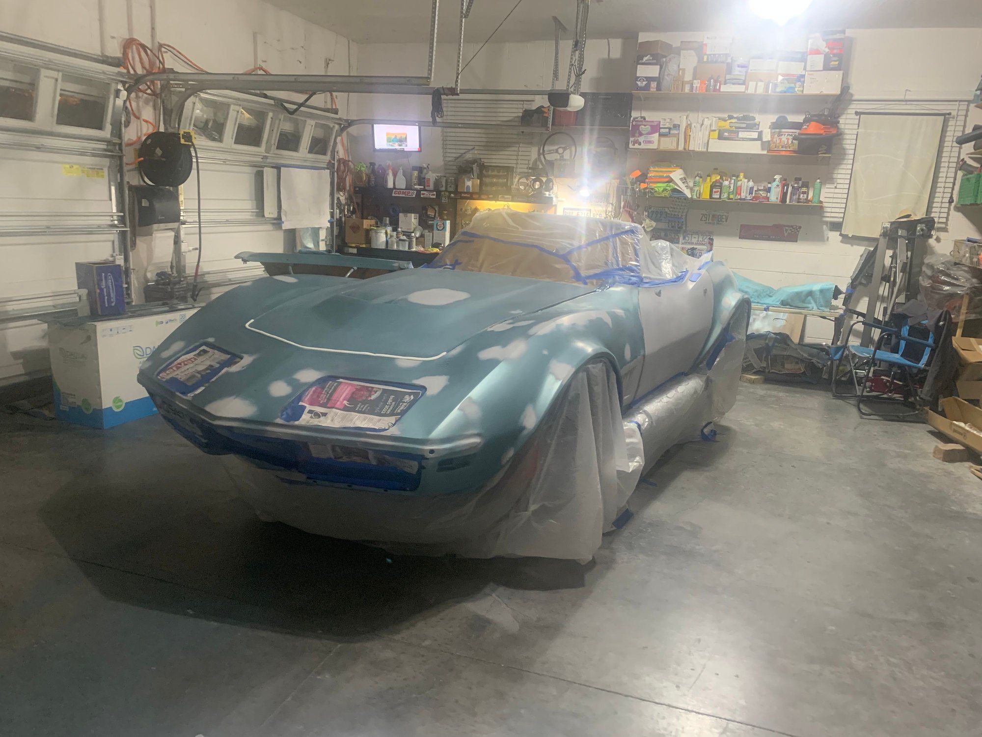

Found a few more spots to work and prime. Still looking like I’ll be ready for basecoats tonoght.

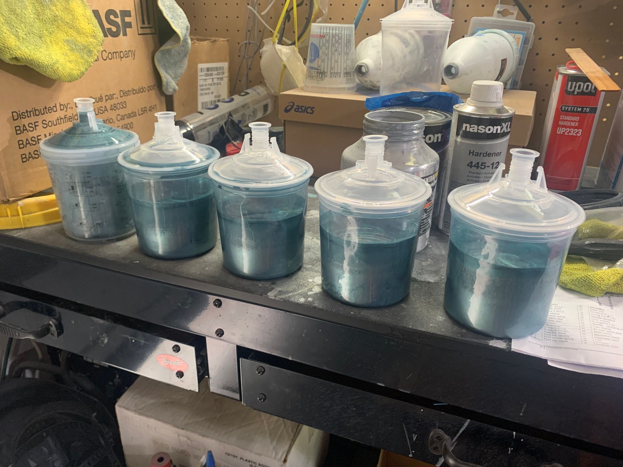

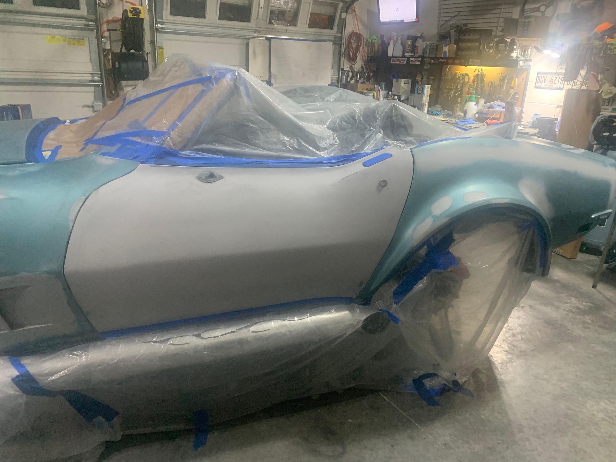

Basecoat mixed and ready to go. Each container is exactly the same mix ratio.

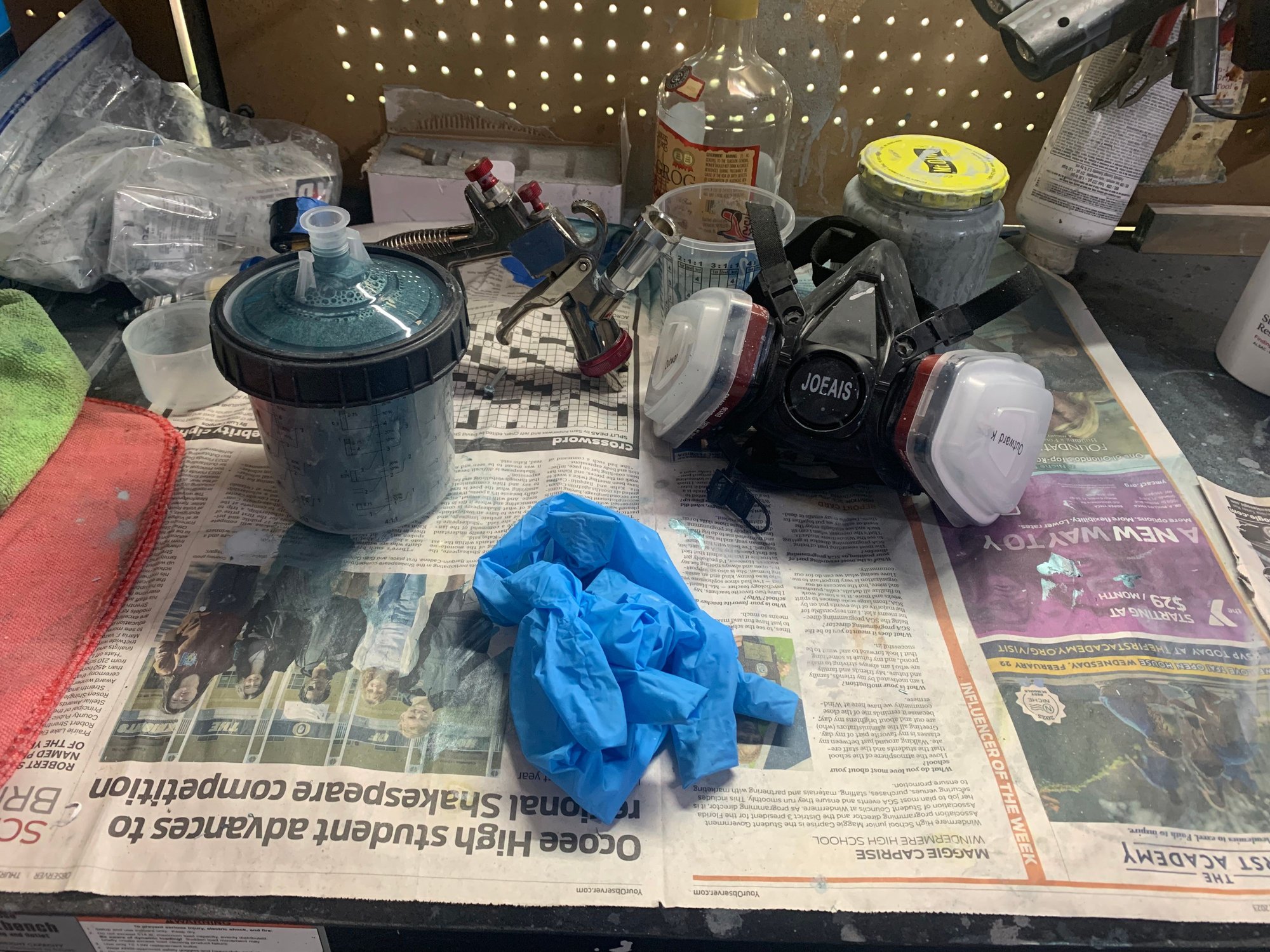

It’s not too late to turn back being I’ve NEVER done this before. Should I be “safe” and call a professional?
Only if you want to wait for 6 months.
