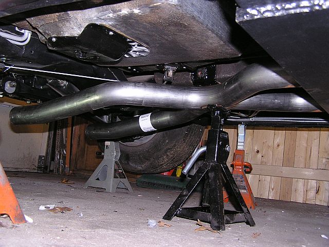

Hey, got my Pypes exhaust on Wednesday the 27th. I just did a trial fit on my '73 with the th400. Here are some pics. The images are not great as I only have enough room to squeeze under while on stands.
Seems like plenty of room. I can even attach to the stock, front exhaust hanger at the base of the tranny.

did the x pipe match up with the collectors ok? From the pics it looks like its pretty close. I havent been able to do anymore to mine for the last 3 weeks but I am going to take some time off later next week and see if I can get mine on.

It seems as if the x-pipe lines-up. There 2 's' bend pipes that give some room for alignment. You have to look at the pipes carefully when they get installed. It appears as if they are right and left handed...the instructions are not very clear regarding this. The "s" bends fall short of the collectors by 12" to 18". I will weld some pipe to make up the difference. I intend on having this all done today. First, I really have to install my new fuel tank.
I will post more pics and possibly a sound clip when completed.
THose are Dynomax Cyclone Ceramic Headers.

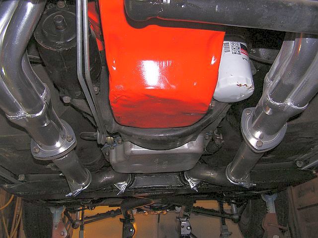

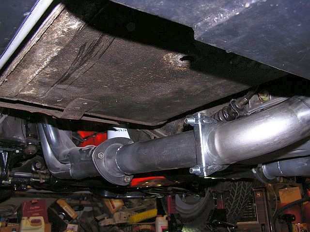

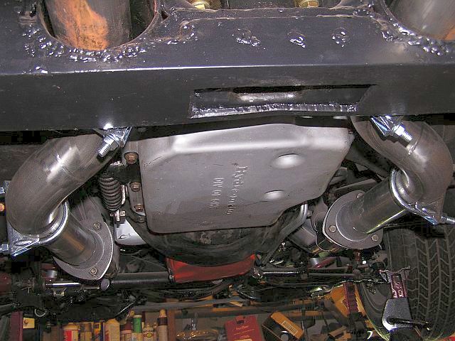

Here are the lastest pics.
Firrst, the alignment to the collector ends was near perfect. A little persuasions was required. Second, I did not finish. Ran out of time.
I will be calling Pypes tomorrow to have them answer o few questions.
- Are the "s" pipes supposed to be that short of the collectors?
- Does the arrow on the x-pipe plate point toward the front or indicate air flow direction?
- Which way is the bend on the rear of the x-pipe face, upward or downward?
- Why are the "polished" tips not polished?
- Can you ship 2 more hanger blocks? They are missing from the kit.
- What is the "bonus" pack that is listed on the parts list? I did not get one.
I know this is a new system for Pypes, but these issues need to be ironed out.

MZMGB: I think I can answer a few of the answers for you????
The "S" pipes are meant to be that length, I had talked to Chris at Pypes and he explained, that I would have to bridge the gap between it and the headers.
The arrow on the X pipe points toward the front of the car.
The bend on the end of the X pipe faces upward.
I agree with you on the polished tips....the description clearly states that they are supposed to be....mine aren't either.
Amen on the missing block hangers....I only got two also.
I believe I read somewhere that the bonus kit consisted of the Pypes hat and some decals...I did get.

Called Pypes. They apologized for the missing hanger blocks and said I would have them on Wednesday. They are going to check on the "polished" tips. I wasn't quite sure how that issued was resolved.
The difference from the "s" pipe to the collector was left intentionally so that the system could accommodate various header manufacturers.
The extra 2 clamps I had suggested are supplied with the downpipe kit for stock manifolds. I will weld mine.
NTMMDR : You said "The bend on the end of the X pipe faces upward."
The rep said the x-pipe bends DOWNWARD to clear under the rear. The output legs of the x-pipe should be parallel to the ground. See my earlier posted pics. Not to be confused with the instructions that say "... should not point towards the ground".
