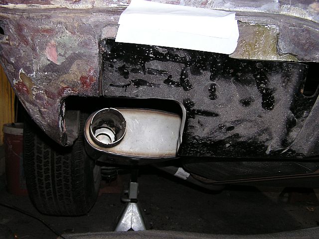

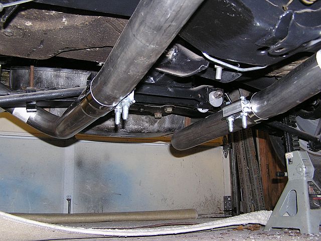

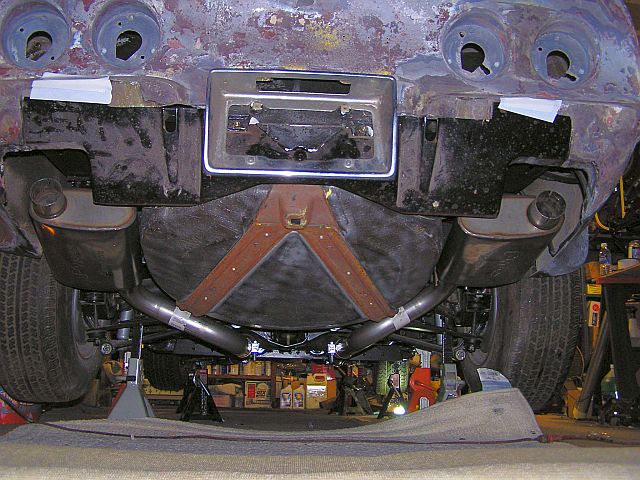

Well, it's installed...almost. I need to figure out what I want to do with the tailpipes.
Some points of interest.
-The driver's side pipe is shorter that the passenger's side. I had to make up a spacer in order to obtain the proper exit height. Pypes needs to increase the hanger wire length.
-The tailpipes do not come out in the center of the rear panel opening on a '73. Both left and right pipes exit toward the outside of the openings. If you try to center you will interfere with the tire carrier. Maybe PYpes can move the exit pipe more for this year.
-Absolutely dry fit everything with the tire carrier in place. You will have to make some adjustments.
-THe Pypes band clamps are 15mm nuts.
-Buy extra band clamps. I bought (4) stainless, wide clamps at Car Quest for $8.50 each. Well worth it. This will come in handy when you need to replace the extension piece to your collectors. Especially if you don't make them from stainless.
Pardon the appearance...I am still stripping the car. I just needed to put the exhaust on to rid my garage of the coffin-sized box.
