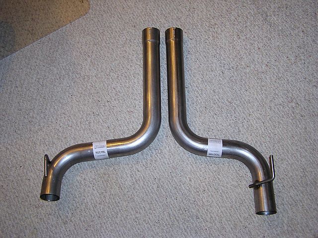

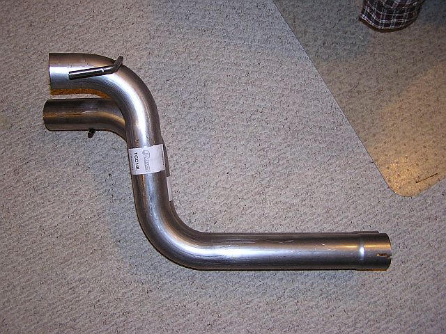

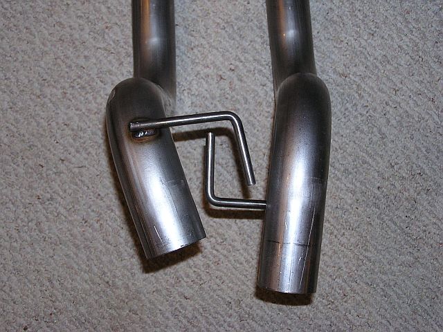

How annoying is this? The left & right pipes are very different in length and bends. How about some Quality controls?
Hangers are in different locations and directions. The mufflers also will not line-up at the rear panel. The left pipe doesn't even point near the exit opening in the panel. The right seems to be where it should.
Anyone else want to confirm whether on not their pipes are similar.

ok, you made me run out to the shop and pull the box out and check. Mine are also different on each side. This is the only pic I had, mine doesnt look like yours. I am going to dryfit the xpipe back tomorrow morning, I can't hook to the headers until I get the ac box back in. Will keep you posted....
The pipes you are talking about are the ones that connect the xpipe to the mufflers, right?

L82shark, you got lucky. It seems there were a few polished sets around and you got one of them. Polishing takes too long ans costs too much. I can polish mine if I get really bored.
Pipe lengths...The pipes are different lengths. The rear is asymmetrical and requires the different lengths. I just don't see it. I will measure to confirm and try again.
Some pipes may require some "tweaking" too fit properly on different years. I was told to only bend on the straight lengths to avoid unnecessarily distorting the pipe. I fortunately have access to a bender and can make the tweaks.
Brandon at Pypes was very helpful and apologetic for all the issues and questions. Like I said, this is a newly released product and they will be some bugs.
