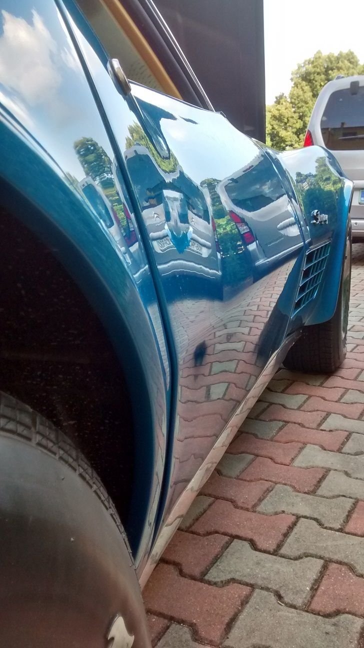

Well after a long time (too long) I finally took pictures of my doors and what is wrong with them.
Here they are:

The top picture shows too much shaved off the body work, in my opinion on the door. In the middle picture to me it looks like the bottom edge of the door has been shaved off as well given the gap between the lower left corner of the door and the rocker/rocker trim panel.
I'm not too sure about the middle picture but I think it just needs the striker plate moved inwards a bit as the door looks like its sticking out too much.

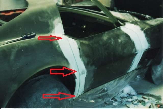

If you want to get it perfect you will have to do fiberglass work on both the quarter panel and the door. IMO you're probably better off working with what you have than swapping to another door. The new door will also need work to fit right as all C3's are unique (I always call them 'the factory built kit-car').
Something is not right with the bottom of the quarter. Has it been replaced? See how the bottom is at the wrong angle to match the molding. Here's my '71:
Yeah, looks like most of the error is on the door. The edge of the door should come to a point, but it's been sanded off. It can be built back up with resin & mat.

It looks to me that fixing what You have is going to be way less work that re skinning or adapting another door. These are not Metal cars, Fiberglass can be added or subtracted fairly easy.
I have no idea if it has been replaced by previous owners. But as I looked underneath the only visible thing is that the fiberglass on the rear right wheel well was repaired from the inside on one small section.
I talked to my friend who did my paint job and is a professional painter and has a paint shop that we did some mistakes when prepping the car. We did too little research before painting and we didn't do the doors as was suggested in this thread. Also my was the very first corvette he ever painted so he was lacking experience too. Well we will have to repair those 2 bits wont we.
