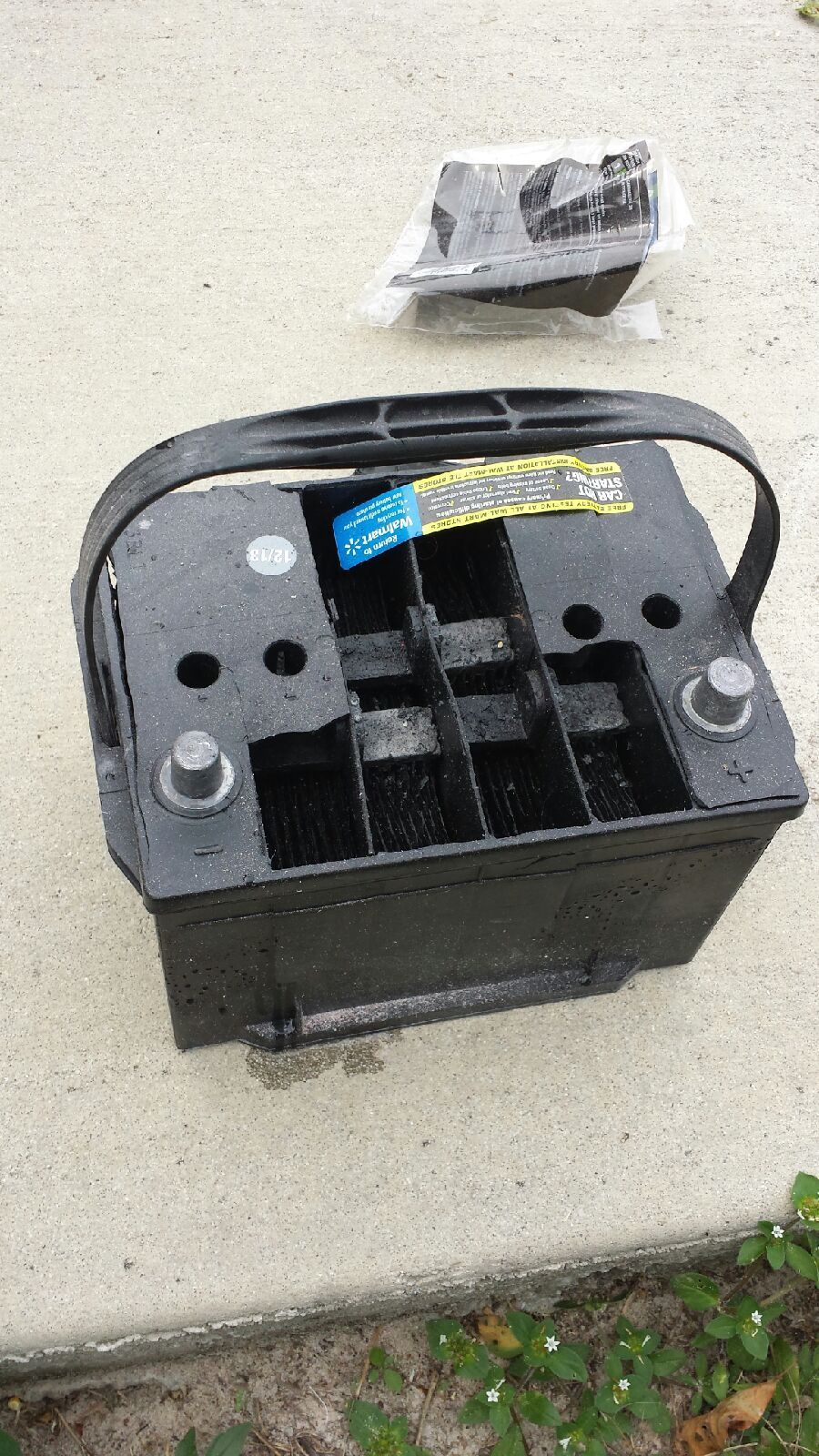

So I have a 74 convertible project that I am working on. It has a 1 year old battery in it that I bought from Walmart. The battery has a trickle charger on it to keep it charged as I do not start the car but every once in a while to move it or keep the carb from getting stale. Well today I was out doing some sanding on the body and wanted to get the car out into the sunlight, so I disconnected the charger and proceeded to turn on the ignition. I have open headers on the car and at first thought the car backfired, but noticed smoke coming from behind the seat. The noise actually deafened my right ear as it was a loud boom. I immediately lifted the vert cover and disconnected the ground cable and got out of the garage to let the poisonous gas clear. I went back in with a respirator to baking soda the battery compartment and my garage floor. I tell you what, I am 47 and have been working on cars since I could drive and never once had this happen and as a kid had a battery fall into my radiator and short out. This is some scary crap. This is especially scary with the battery sitting right inside the drivers compartment.
So anyone else have one of these interesting stories? And what can be done to avoid this again? It might only be once in a lifetime, but not one I would like to recreate .

The battery was boiling, producing hydrogen gas that ignited.
So the possibilities I see are either the battery had a bad cell causing the tender to try to charge it and boiling the remaining cells, or the tender is bad.
I have a CTEK tender and it does detect a bad battery and stops charging.

I buy lots of "stuff" at harbor freight but I have to say using one of their trickle chargers was a serious lapse in judgement. I use an actual Battery Tender brand unit and have confidence in the built in safety features. The factory is in Deltona if you ever have an issue they stand behind it. Mine was 10 years old and I asked them to check it out, they tossed it in the garbage and gave me a new one.
Exploding batteries are no joke and I suspect yours exploded because of some type of gas build up from boiling the acid, it wouldn't take much of an ignition source, even static electricity.

The HF unit puts out vey little current, we call it a "drip" charge. If you measure the voltage it should be about 13.8v
But, because the battery is in a closed compartment guess enough hydrogen built up to ignite. Glad you are OK, I hate to clean up messes like that!

Just had a automotive type battery on my Generac standby house generator explode. Not 100 percent if this is fact but this is what I was told "that since the battery is always on a trickle charge the battery is slowly boiling off water and producing explosive gasses". Plates inside the battery can short out and if they do... the gas only needs a spark. I learned a lesson to check the water level in the battery as it can boil off. I am not sure if sealed batteries have this same problem.

That's why I'm not a big fan of using battery tenders all the time. Sure, there is a very small chance of that happening but that's no consolation when it does.
A Ctek will boil a battery too. Had one do it to one of my batteries. The battery wasn't in the car because I don't store my vehicles with the battery in them.

If you're worried about hydrogen buildup, you should do what the factory did: Buy a vented battery and run the hoses through the floor. Nowadays most batteries are sealed which usually works fine, but every now and then... it doesn't.

When charging the battery (yes, even with a trickle charger), the battery door needs to be left open and the driver's window should be rolled down a good bit. That's the only way to get the hydrogen gas out of the battery box/interior.
I doubt there was anything defective with the battery. If constantly on a trickle charger, the electrolyte level needs to be checked every month or so, as well.

This is the reason I have my battery charger plugged into a household 6hrs/week timer. This battery is left unattended for up to 6 months at a time, so I wanted better control of the charger.
Having a battery on a trickle charge indefinitely is a recipe for disaster.

nothing wrong with the cheap trickle chargers at HF, but as the last post said, put them on a timer. let them run an hour a day or so, not non-stop. I have a few but found it's easier just to use a battery disconnect and re-charge if needed every few months...the top post disconnects with the screw off terminal work great, reach under the battery door and give it a spin. side posts in my C4 is a little more difficult, I use the blade switch there, but either way, you eliminate any parasitic drains, clocks, ecm's, etc...
