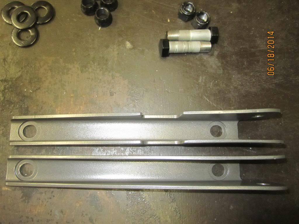

I believe VB&P are the only ones making a spreader bar for BB. You have to run an electric fan though.
I just finished installing the Speed Direct unit on my 72-BB, running electric fans, but I made my own brackets using angle iron from Home Depot. If you have access to a welder it's not that difficult.

I believe you will find the VB&P unit is beefier than the Speed Direct one. All depends how far you are pushing your car. I'm basically a cruiser with some occasional spirited diving.
Regardless, here are some photos of my install as you asked. In a nutshell, I cut up the brackets supplied from Speed Direct and, using 1" angle iron stock, cut up/welded up some new brackets using both materials. I got the bar as close as I could to the pulleys on the motor. A little trial and error is involved. Not to difficult a project.

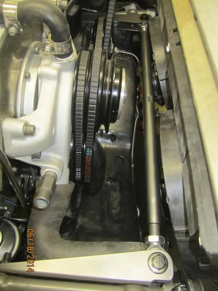

Kim - I notice you have yours much nearer the engine and pulleys than Mooser does. Is this just a matter of preference or is there some benefit from having it closer? Or is Mooser's idea of making it more difficult just that? Mooser WHY did you do that? LOL! I gotta admit I kinda think it would be easier to live with having it further forward, but what do I know???? Thanks guys you are really helping me along!
No particular reason for me. You just have to skirt the front bolt/nut on the a-arm.

Ideally you'd want to go in-line with but in between the two control arm bolts. That doesn't work so well with the BB. So it's either up or down some to make clearance on the WP pulley (I have seen somewhere that someone made a spacer for the stock fan and managed to sneak the bar in on a BB)
Like Kim72 said, you need to get around that front a-arm bolt. I wanted to stay in-line with the bolts rather than going up or down so this worked for me.

I did not want to comment on the placement location of your spreader bar...because I understand WHY you went where you went with it. Sometimes....'thing's' can only go where they can go even though we might want them to go elsewhere.
Very impressive....very CLEAN looking installation.
