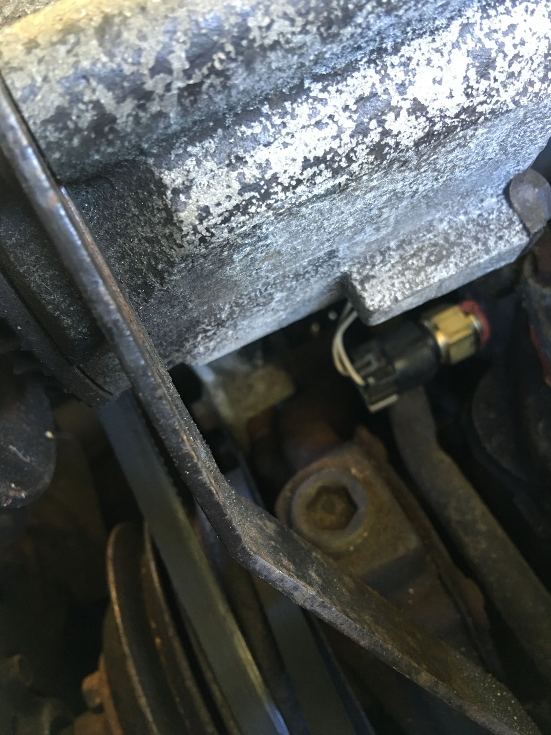

Originally Posted by lancer013
i changes the coolant sensor it would only go in one way woth a lock on plug
YES...BUT did you replace the wiring connector????
POST a photo of your coolant temp sensor.
In 1982 ...if my memory serves me correctly...the coolant temp sensor was a different design as what you can buy today. The new sensors are better...and that means that you need to cut off the old connector and install a new one....which is why I am asking IF you replaced the wring connector when you replaced the coolant temp sensor.
Which is why I am asking for a photo of it.
DUB

Originally Posted by DUB
YES...BUT did you replace the wiring connector???? In 1982 ...if my memory serves me correctly...the coolant temp sensor was a different design as what you can buy today. The new sensors are better...and that means that you need to cut off the old connector and install a new one....
DUB
DUB is correct..
Lancer this is what your sensor needs to look like. If it doesn't, you may have been chasing rabbits. As many have mentioned, your coolant sensor is integral to the system and will totally confuse your ECM.
I got mine at AutoZone and swapped it in 15 minutes including soldering.

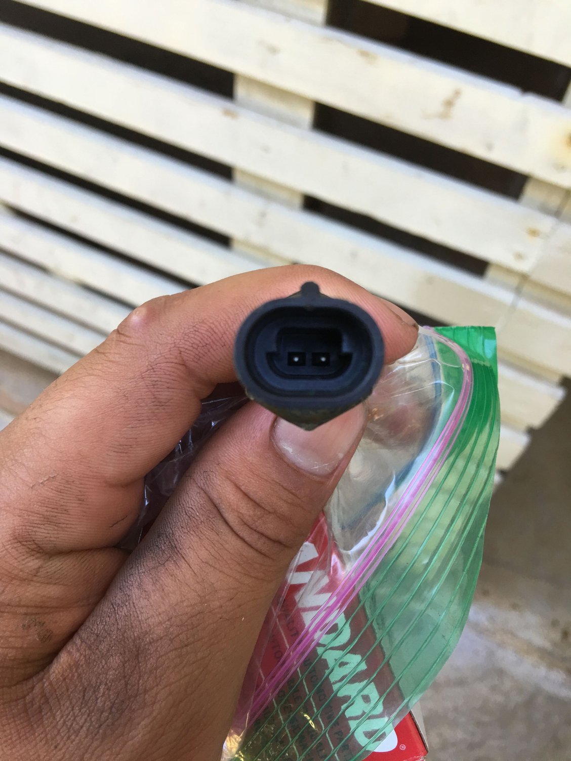

These are mines and i havent seen any spieces yet goin try make harness to adjust tps anyone know a good ob1 reader

You have the current design which is GOOD but you MUST make sure that it was wired correctly. IF the wires were switched/crossed...the engine will run VERY POORLY.
The manual will help you in that.
DUB

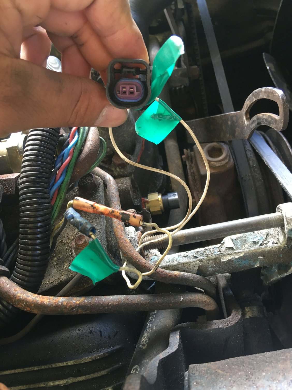

After removing the smog pump i seen the splice is it correct

Will plug it but since they spliced wires are those correct

If the car ran okay before you had this last problem then they are okay.but atleast tape up the connections ,best would be to solder them.this sending unit is what tells the computer the temp

Yeah ran perfectly fine it was taped and cover but i wasnt to open it to see if it was loose
