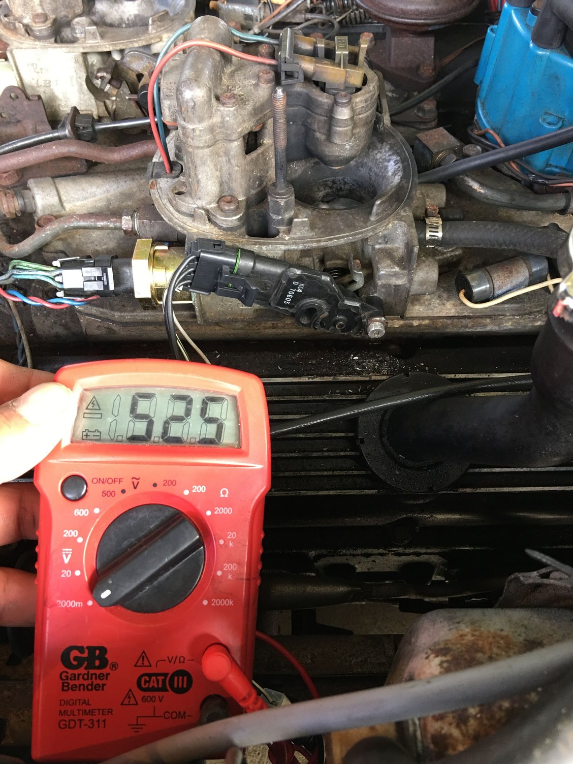

Reset tps to correct reading but look at angel

there is no decimal infront of 525 look at this meter http://www.ebay.com/itm/Digital-Volt...UAAOSwHnFVkYPk 2v dc

You can use the scanner with the engine OFF and NOT running BUT the ignition ON to set your TPS. When you get it set.,...then SLOWLY accelerate the throttle and WATCH the TPS sensor volts and see if it increases. Take it all the way to FULL THROTTLE and watch the reading.
KEEP IN MIND that IF your TPS is NOT able to be held in with the TWO screws...and it is at the angle that it is currently...I would STOP and get another one.

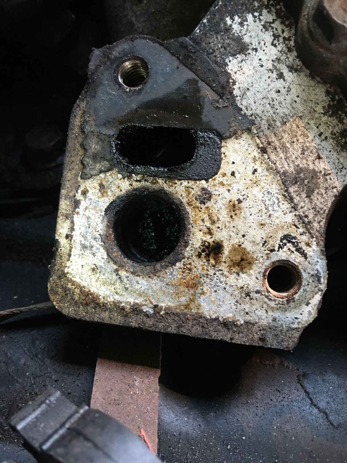

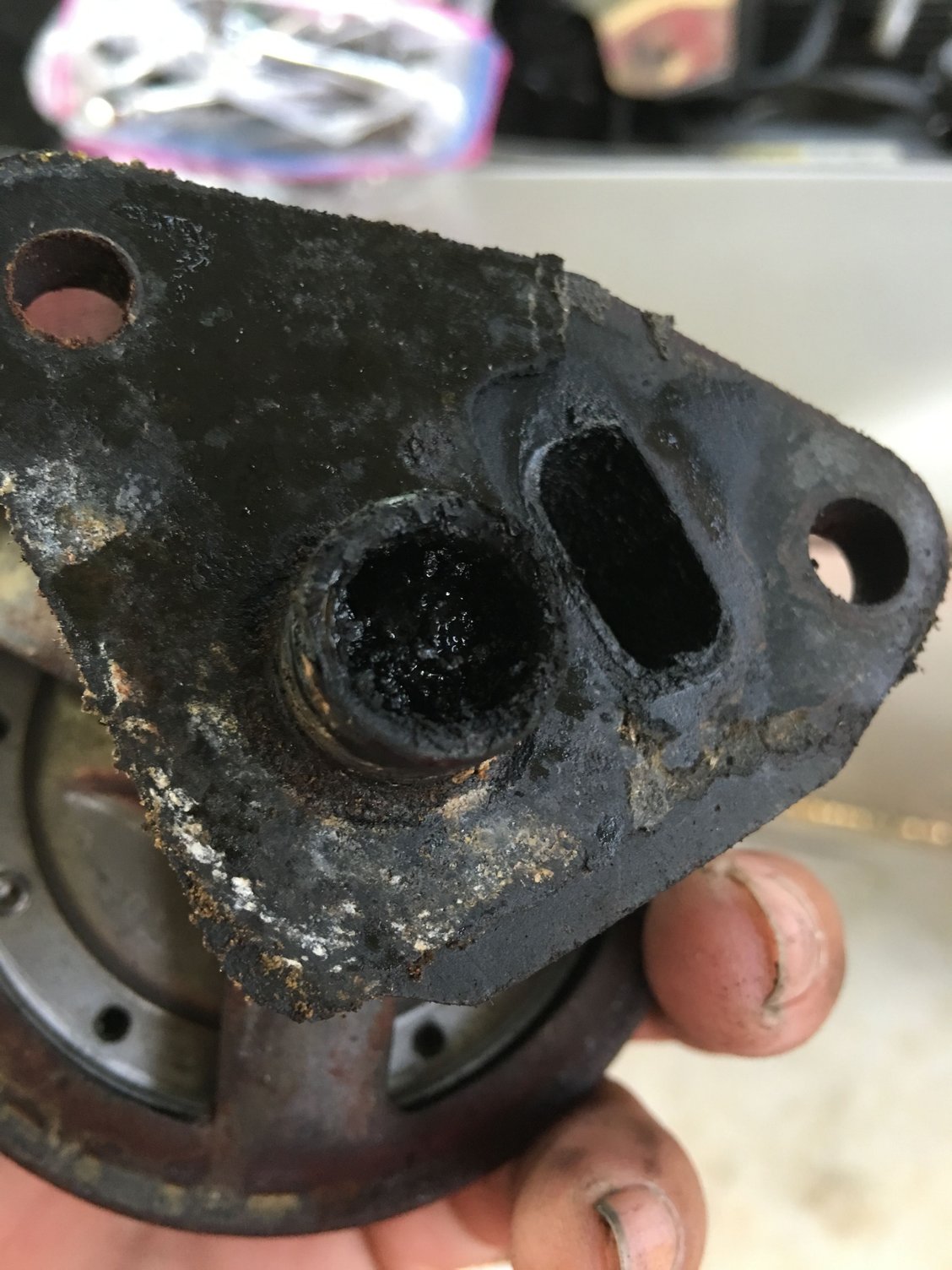

Took out egr was plugged i cleaned it but still getting code and started it to get all lose pieces our when egr was off

This is a problem!!!!!
The TPS should be as you know .54 volts +/- .075.
Your IAC is awful high also.
MAP should be around 1.40 volts if my memory serves me correctly

Originally Posted by lancer013
No still working on gauge so is tps wrong or do i have to readjust what about egr do a delete
YES it is wrong....do you read what people write you????????????
I do not know the laws where you live dealing with emissions. For testing purposes at idle the EGR can possible be blocked off due to it does not work at idle anyway....but when driving it DOES come into play.
It looks likes the intake may needs to be pulled IF you plan on keeping the EGR.

plug off the egr for now .get it running first then fine tune it.the tps is way off.If you are testing the tps correctly and your are getting those kind of numbers then the tps is bad.replace it.I would check your timing .put it back to factory .make sure that the harmonic balancer is good .

I set the tps with scanner with key one then locked it in at .52 and when running i was getting those numbers on live data i advanced the timing because would idle better if anyone wants to reach me direct my number os 808756-2269
