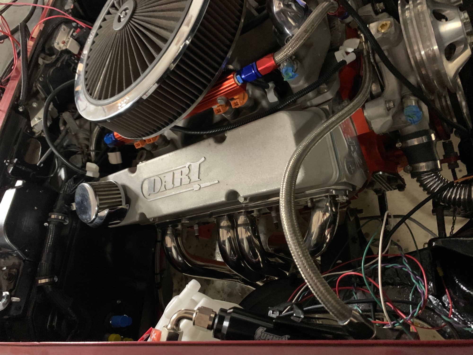

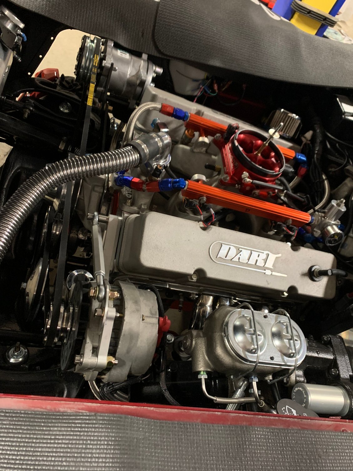

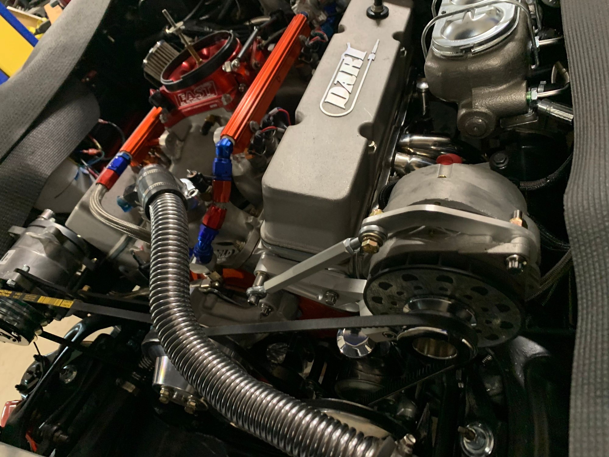

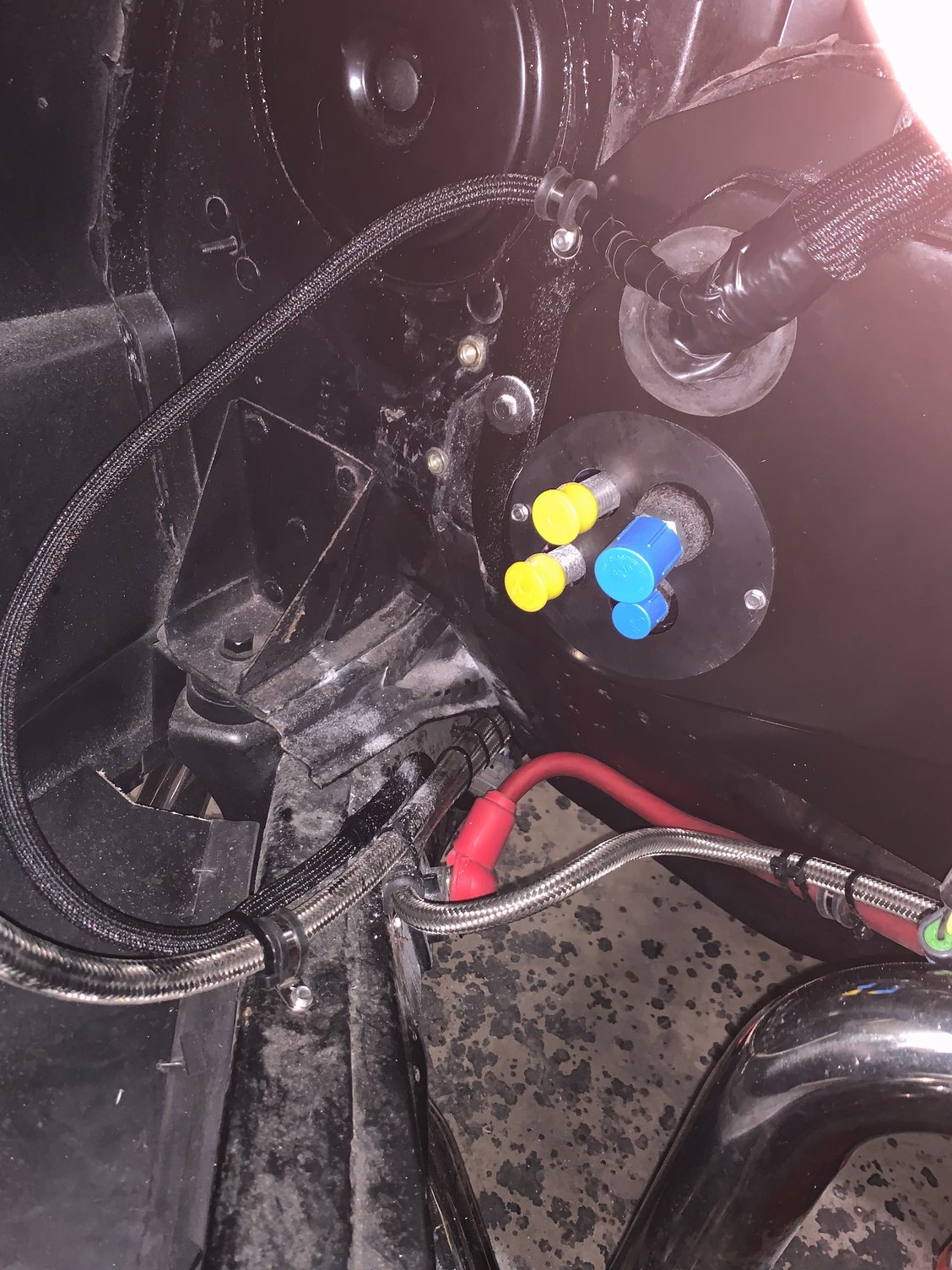

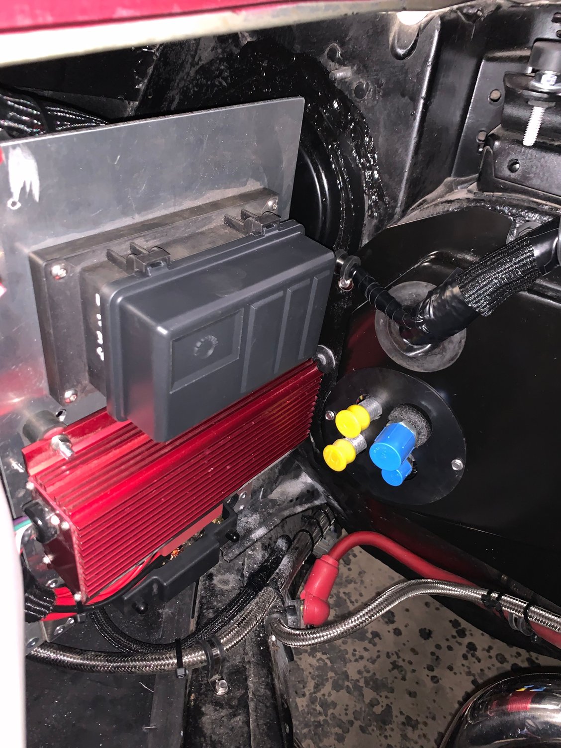

I might have posted on this awhile back but I've been doing some work getting the car ready to run so it looks quite a bit more tidy. Has been sitting since it last ran but I'll get it running this year.
427 dart little M block
AFR 210 eliminator heads
solid roller comp cans. .630 lift, 245 duration at .05
comp cams roller rockers and afr stud girdles
ported Motown efi intake. Fits under stock L82 hood
Mahle forged pistons 10.3:1 compression
scat crank
scat polished I beam rods
Fast efi. Just rewired whole car
MSD crank trigger
hooker headers , side pipes and uncapped sts spiral baffles

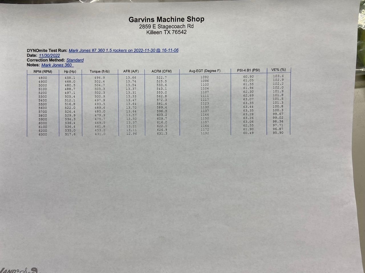

Are you sure? And please theres no issue with your skepticism with me, I welcome it.
"Wow... those are big block numbers...." Not my big blocks
Cam specs: 264/264/.528/.528/108/104
Head flow what I remember. @ 28 Inches .300 201
.500. 250s
I will try and find the dyno sheet.
So lets get back to my 1979 long bed C-10 Big 10 truck, is there anyone on this forum that believes this truck weighs 3600 pounds with a person in it? By the way my 327 ran 12.0s in this same truck. Keep in mind this was not tested on my dyno, but independently tested on another shops dyno.
I was wondering how you were making that power and thought it may be just math and RPM…..but should have known….you are at 103% VE up to 5600rpm…..very nice.

I don't trust the numbers off this dyno (RPM numbers), all my engines peak low (RPM) on this dyno for some reason, I know my HP peak is around 6400 RPM, although the TQ peak seems reasonable. I had 499 observed HP @ 900 feet elevation, I can't remember the conditions. I show roughly the observed HP going down the track in street trim, but you'll never show corrected HP in a truck, to many loses. My truck runs 11.20s in race trim, and 11.40 in street trim. Good enough for a daily driver shop truck with a production 350. A shorten of the bed and a carbon fibre drive shaft, and Lamb front brakes-I got a 10 sec truck.

What were your dyno numbers should be close to 650 hp .
