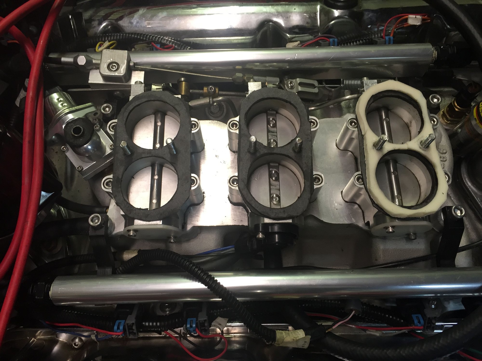

496 BBC in my '75.
Originally ran a '69 tri-power setup to stay under the stock hood. Used both the stock carbs and a Mopar mechanical secondary setup. Decided to upgrade to EFI and had a custom 3x2 Tri-Power port EFI setup made. System has 3 two barrel throttle bodies on a progressive linkage on a heavily modified Edelbrock dual-quad manifold under the air cleaner. Fast XFI 2.0.
Also went with a March serpentine belt setup and PS with remote reservoir. Car has a T-56 Magnum and Tom's 3.73 12-bolt diff built by Gary Ramadi. Goal ended being to make the car look like it could have rolled off the GM line if GM had all this technology in 1975.

Thanks. Lots of work and effort but worth the payoff. It can sit for three weeks, I walk out, depress the clutch (safety switch), key to run for 3-5 sec to get pressure up and then crank it. Fires right up without ever touching the gas. Tuning is so easy. Decided to change advance at idle from 15 to 25 BTDC. Open laptop, change two cells, done (had to tweak idle stop a hair since more advance smoothed out the idle but that was easy).

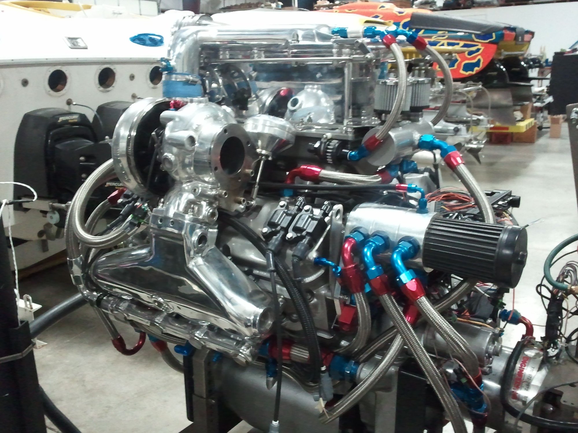

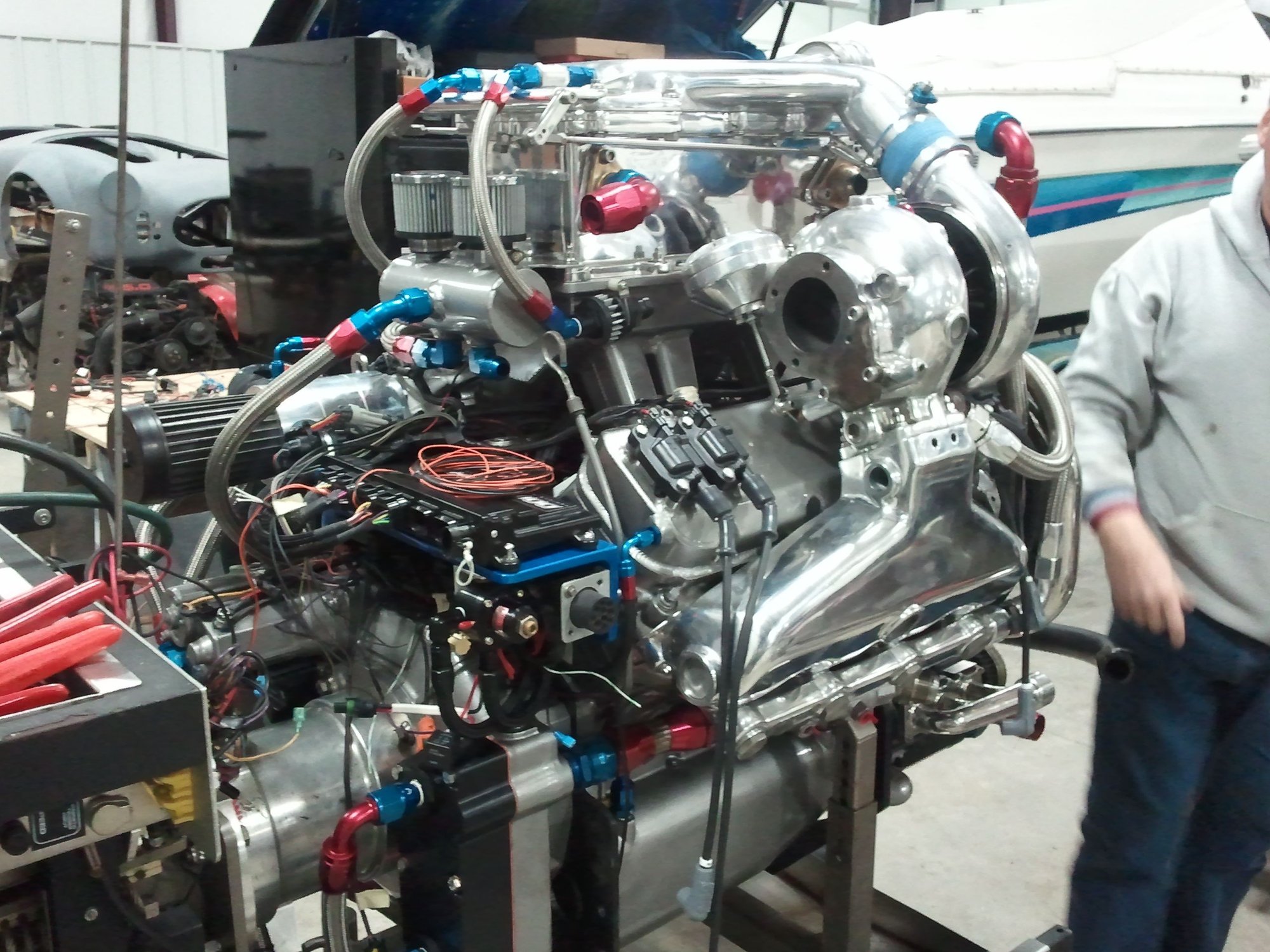

Here you go Dbl...….. LOL Might need a new hood.

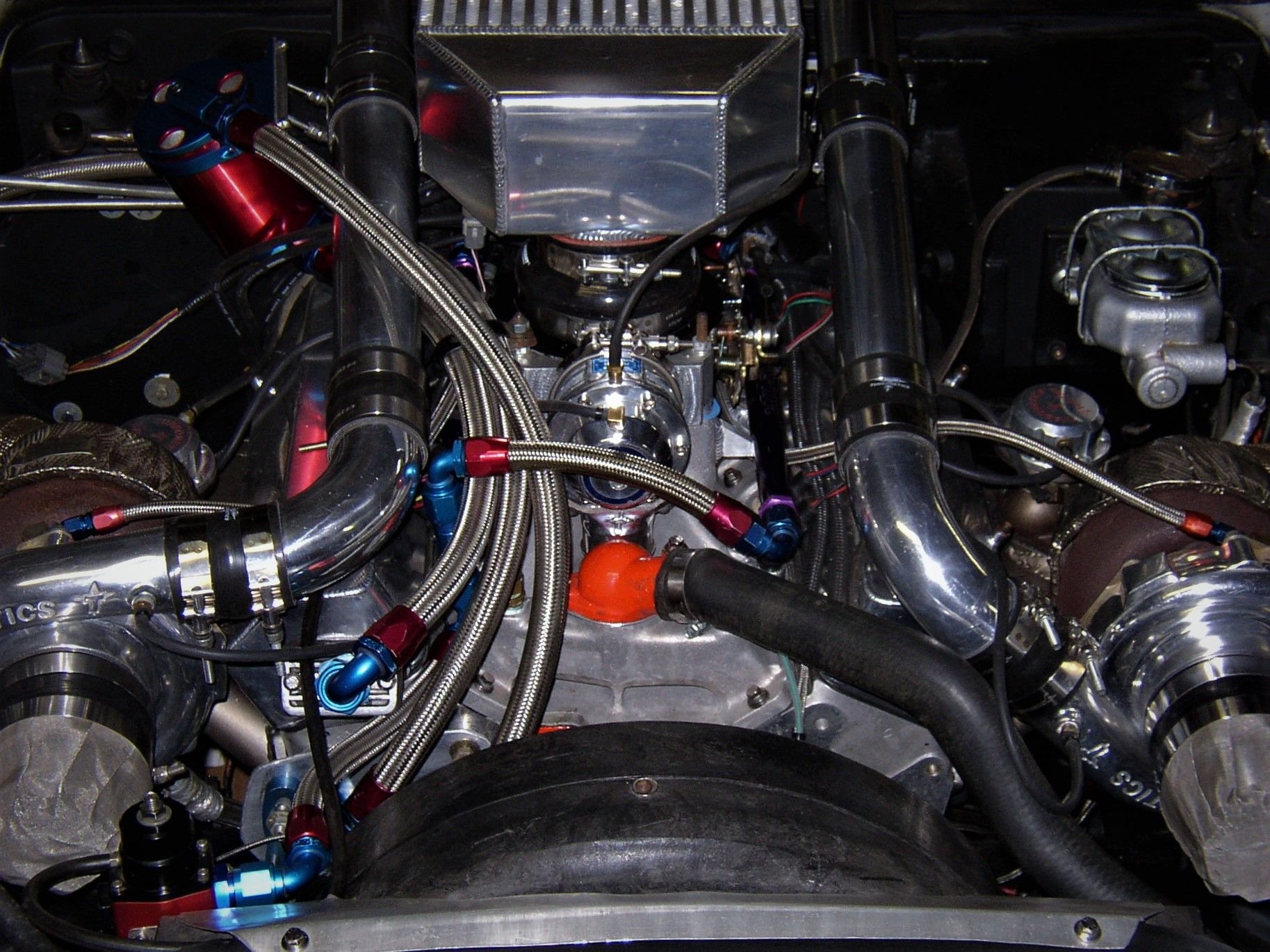

just got this going

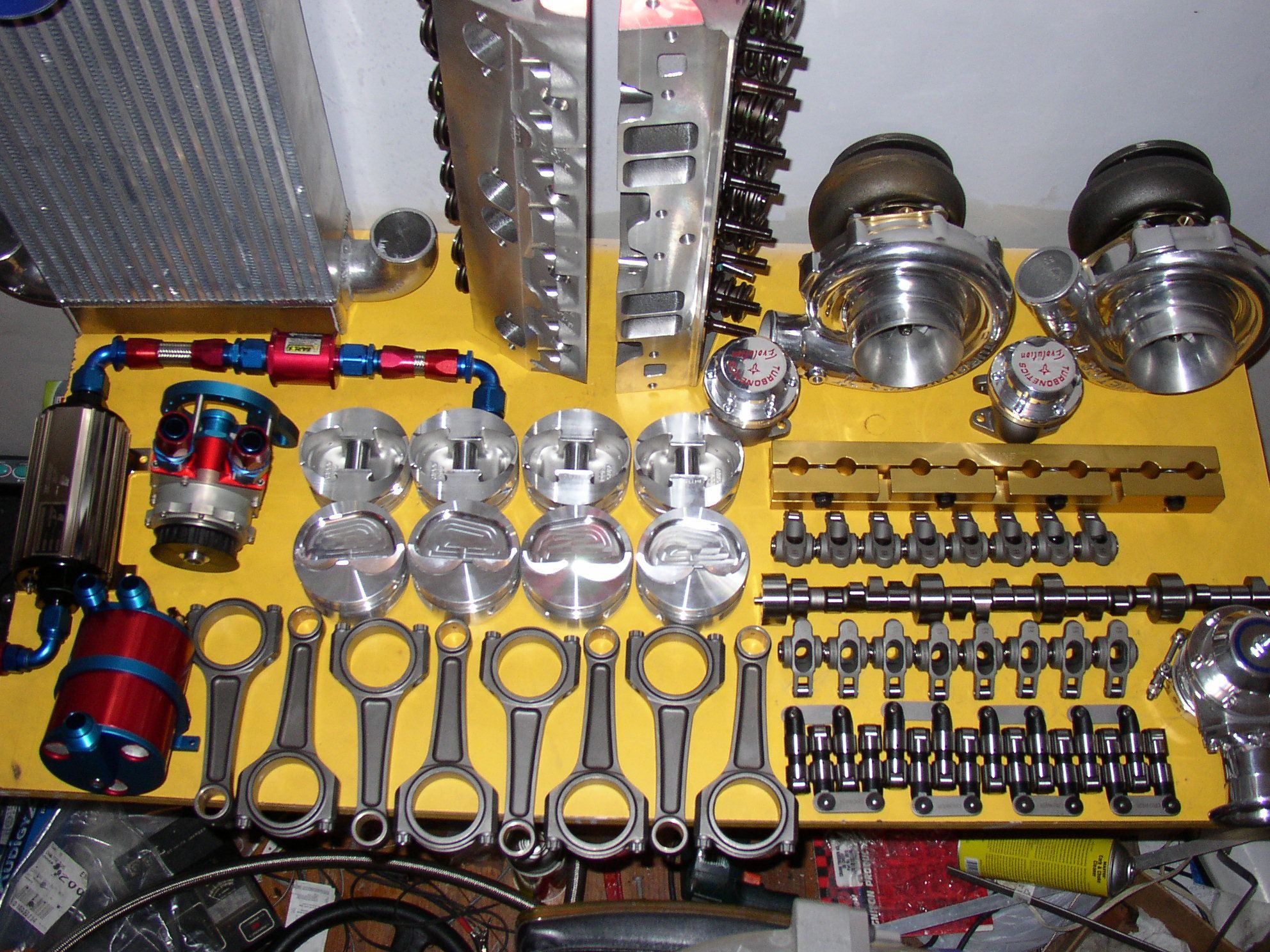

no pics of it on the stand, but here are the guts
2-197 spearco core
Brodix 227 cnc heads Ti retainers
Turbonetics 64mm ceramic bearing turbos Godzilla BOV Evolution wastegates
Crower severe duty lifters, 1.6 stainless rockers, 6"maxi-light series 5 rods
custom Comp-Cams 1474/1474-114 mechanical roller
custom Ross 8.5 compression pistons tool steel pins
Star machine vacum pump and puke tank
Aeromotive 11102 pro series pump
World Products motown block steel caps 4" bore
Titan Sportsman series oil pump
Cola crank 3.48 stroke

Truly awesome, Steve.
I really love what you did there; EFI TRI-Y 496 that other than the fuel rails looks like it should. I've not seen this before; super cool.

When even your mains caps look like they belong on the space shuttle! -I really should pay more attention because I've never seen splayed 4 bolt mains caps that use both studs and bolts before.
