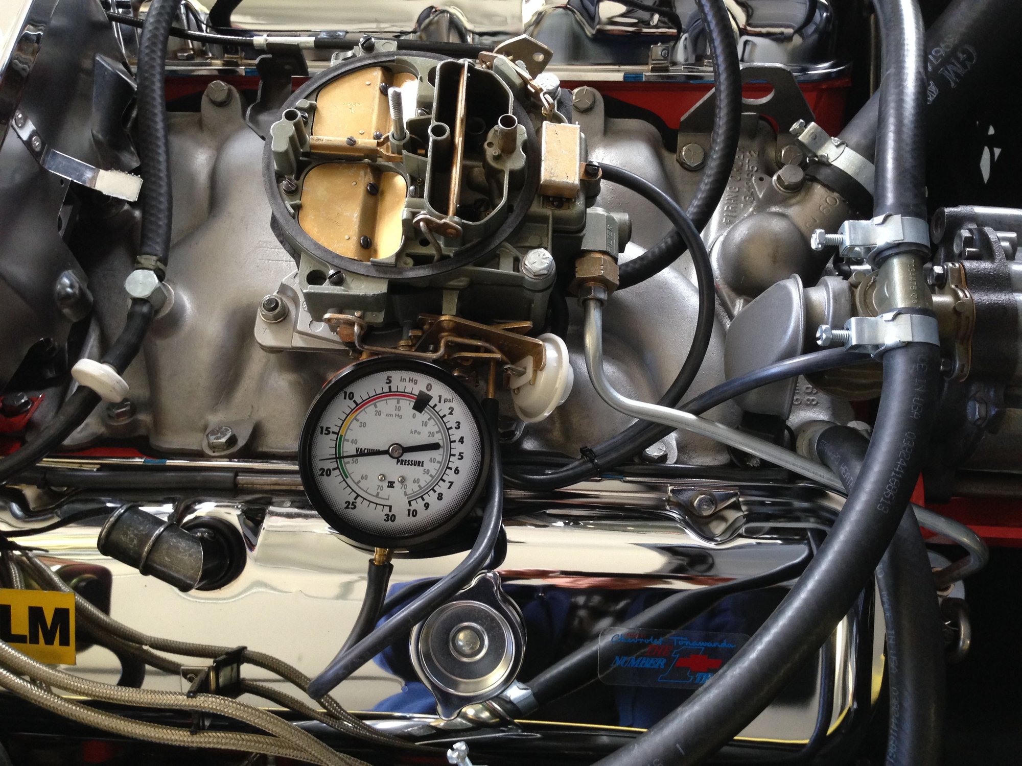

The Quadrajet is the proper carburetor for a '69 427. When I bought the car, it had a 454 (not correct of course). The carb had been rebuilt by Lars to stock specs a few years ago (I have the receipt) and it ran perfectly. The newly rebuilt engine (427 - L36) now uses the carb. It has the original and proper jets and metering rods so it's essentially stock. I installed a Howards roller cam: lobe lift = 0.327" (intake and exhaust), duration = 226.6 deg @ 0.050 (intake and exhaust) so it's not an extreme cam, but definitely bumps nicely and has much lower vacuum at idle. It was hunting pretty badly (power piston spring too stiff) so I removed the power piston spring (for testing) so that the primary metering rods would certainly drop into the jets. The engine runs quite well above about 1100 RPM on up but I just can't get it to idle down. It simply dies. I've fiddled with the idle jets, plugged all vacuum lines (including spark advance) to eliminate the possibility of leaks (barring any potential intake manifold leak), check the timing, valve clearance, etc. Spark plugs, wires, coil, points, and cap are new.
Any ideas on what I should try next? Thanks in advance.

I also have a 69 L36 and think your problem is in the initial timing. The chassis service manual says 4 degrees initial advance which really chokes it down even when stock. With that cam it would be hard to get it to idle at all with only 4 degrees initial and is also the reason you have low vacuum at idle. Check how many degrees mechanical advance in your distributor and shoot for about 34 degrees total to start with (vacuum advance disconnected and the line plugged). The original 69 L36 distributor produced 26 degrees of mechanical advance which is why only 4 degrees initial was used. I have mine reduced down to 17 degrees mechanical and use 17 degrees initial with a Comp XR270 hydraulic roller. By doing this it idles smooth as silk (like stock) and produces 18.5 inches of vacuum at the stock 800 rpm idle. If I drop this to the stock 4 degrees initial it will barely run at idle.

Thanks for all of the suggestions. I took it all in an bumped the initial timing to 18 deg, and she's running pretty well. I can now idle down to about 800! Much better. I didn't think to go that far. Thanks guys!
