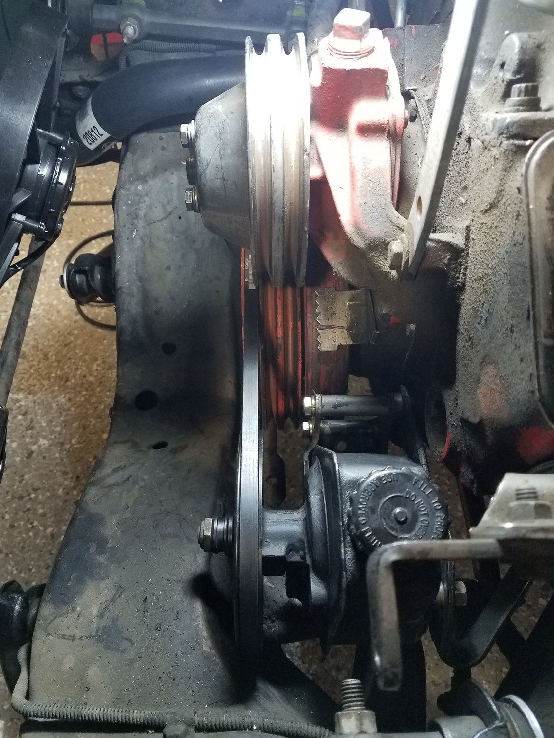

Finally. I received the belt from RA. It placed the pump all the way out. So, my spare for the 81 fit perfectly. Oh well. So I recommend the XL7360 if XL7365 is too long. Fits perfect in the pulleys . Ride height is right where you want it.

As expected, the rest of the belts were incorrect.
3 trips to the parts store, and I am happy with the width, length, and alignment. My parts guy lets me exchange over the counter to size them correctly.

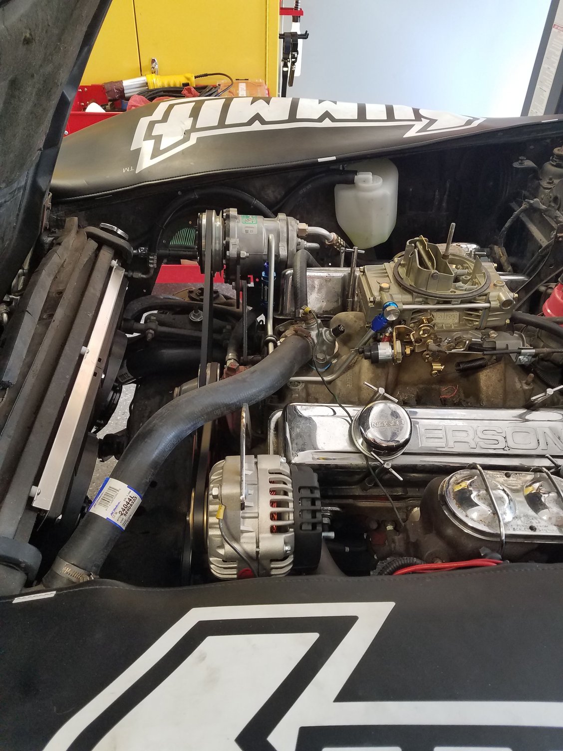

Installed the top hose, and filled with coolant.
I want to start it up and check my work so far.

Okay. Took a while to prime, but started right up with no leaks. So far, so good.
Now to attack the bubba wiring, update for new alternator, spal fans, elec choke, a/c kick up and HEI.
I am quite sure the red neck engineering will continue in that as well.
It will be very reliable when done.

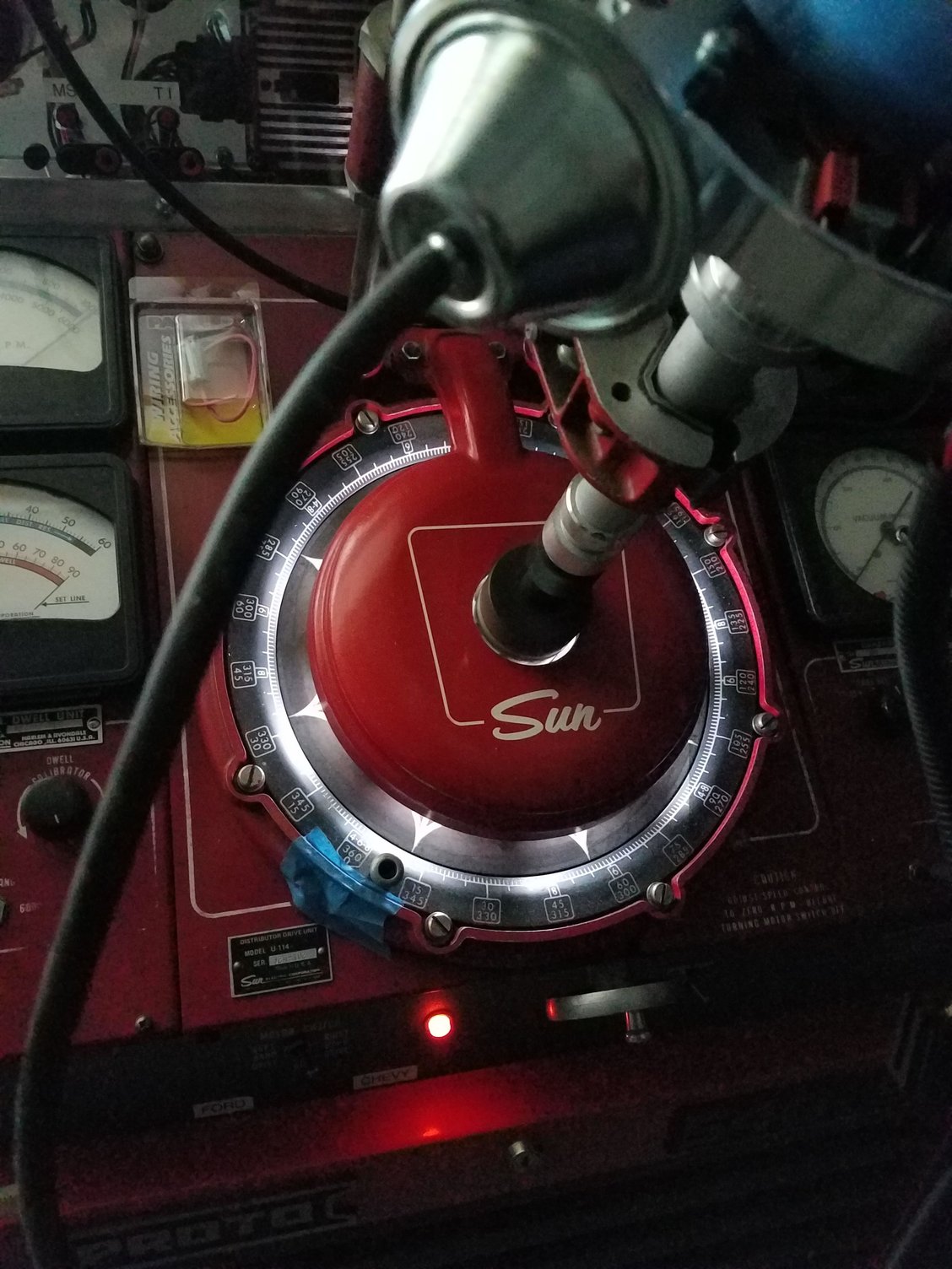

I tested the DUI HEI today.
Off idle to 3000rpm shows a nice linear curve of 18*
Vacuum advance is 10* all in at 13", which is idle vacuum for this cam.
I will add a thrust washer for the tach gear, and a tad more grease.

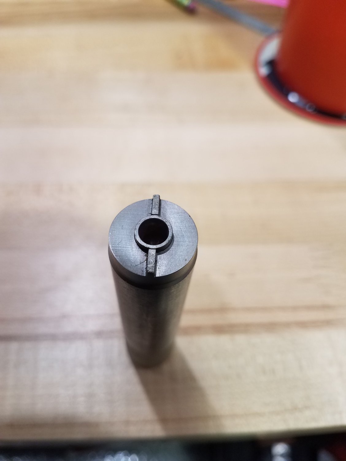

The DUI unit has their own gear set with a larger shaft and a bushed SS coupling. I added a tad of lithium grease.
The tool is custom made for me.

I will now run it for 60 minutes at 500 rpm, 1000rpm engine speed, and check the gear mesh and look for heat anywhere.

As a side note, the repop couplings are brass, while the GM units are bronze. Can you spot the other difference?

I know it's for 0.104" square drive, but just for the heck of it, what does DUI female cable drive actually measure across flats ?
coupling diff ? wag = crown?

The cable is a slip fit. Wait an hour and I will check.
Here is a NOS GM gear.
