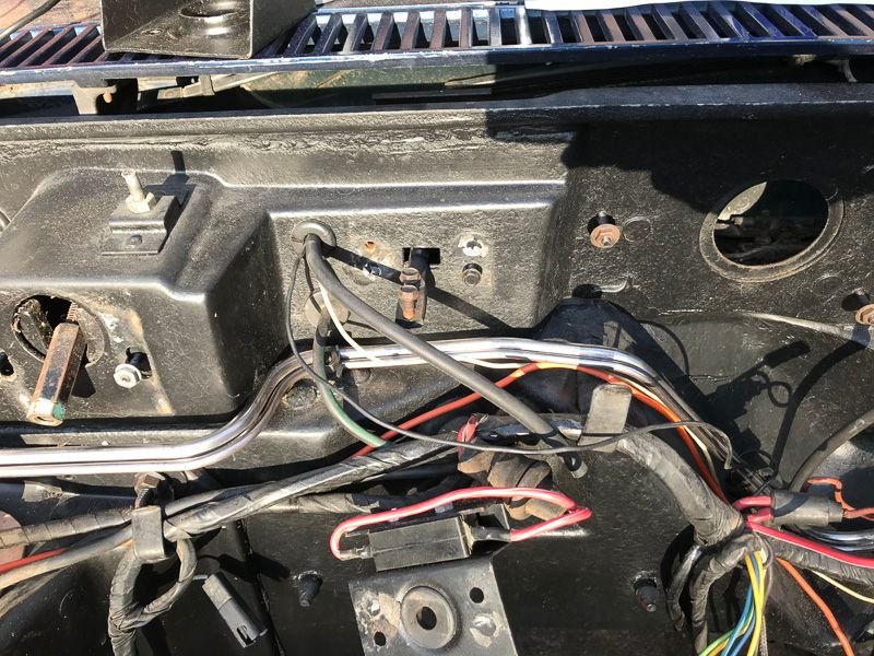

Added a photo of my '72's firewall before new harness, cleanup, and repaint. The texture is kind of like an orange peel.
