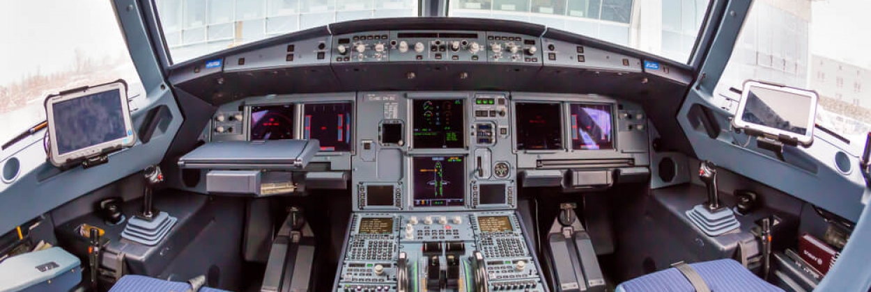

Boeing = Steering Wheel. Airbus = Joy Stick Maybe that's why there is the saying " Boeing or I'm not going " But then a again Sully did a pretty good job of putting it down in the Hudson with a Joy Stick.

I don't think that what jets use can truly be called a joy stick. I have no first hand jet experience but I would imagine that a jet's yoke is attached to the floor and between the pilots legs. Lots of throw on a floor mounted yoke as compared to a joy stick. I can see how fighter planes need to go from full left to full right instantaneously and a yoke is better for that.
I can just imagine driving a car with a joy stick and sneezing while holding a joy stick. That would send me into the neighboring county.

Airbus 321

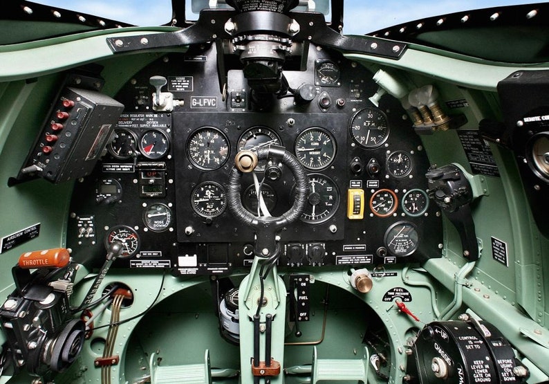

Boeing 737

The Airbus is more like a Cadillac. The fighter jet is more like a C3 !!
