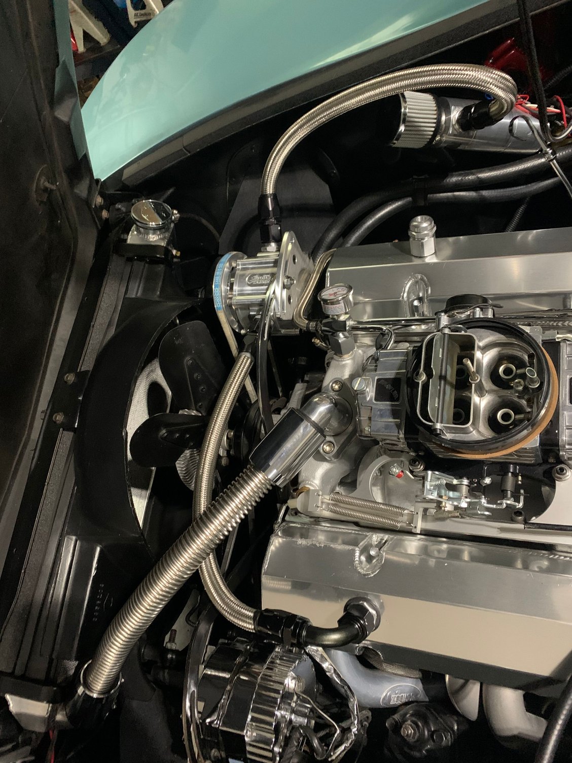

Got my kit today. The cooling fan does not clear the pulley. How did you get around that? Electric fan?

Little bit more of a project than I anticipated but it’s working out so far. Had to use a spacer to get clearance to the crank pulley. Also have to cut the crank pulley down to get fan clearance. Then into to the valve cover for the outlet and then connections to the can.
Bad lighting sorry

Did it not come with spacers of different thicknesses for the crank pulley ? Any pic of what they supplied for mounting it

yes but the crank pulley sticks out so far that it hits the cooling fan. I talked to AC and they said I could cut the mandrel down to size.

I believe I can pin the top of the pump down with another alternator bracket.

Got the pump positioned with some modifying for brackets and spacers. Found a spot for the catch can. This was difficult due to how tall it is but it’s at an angle where it will flow oil down. Installed the vacuum connection in the valve cover. Got the relief valve installed on the other cover. Next is pulley connection to the crank. I will need to modify that a little bit pretty doable. Then hose connections.

Got the hoses connected and pulley and belt installed. Have a quick test run and did ok. I’m not so keen on the exhaust hose. I will be testing it and adjusting things over the next several days.

be sure to not over tighten belt on the pump it only needs a slight amount of tension , good job . I mounted my catch can behind the pass front tire , drilld through the inner wheel well and did it lo enough so I can reach under and drain it with the petcock

Well I took it for the first test drive. Got it up to 4500 rpms and guess what? Dipstick still in place. I felt more power in the 2k-4K range as well. So far, very glad I did it. I wouldn’t mind a better looking bracket as I completely just “made it work” as you can see in the picture. Maybe I’m being too picky?!?

Not to picky my kit had a weird 2 piece bracket i was able to make work with a aluminum spacer
