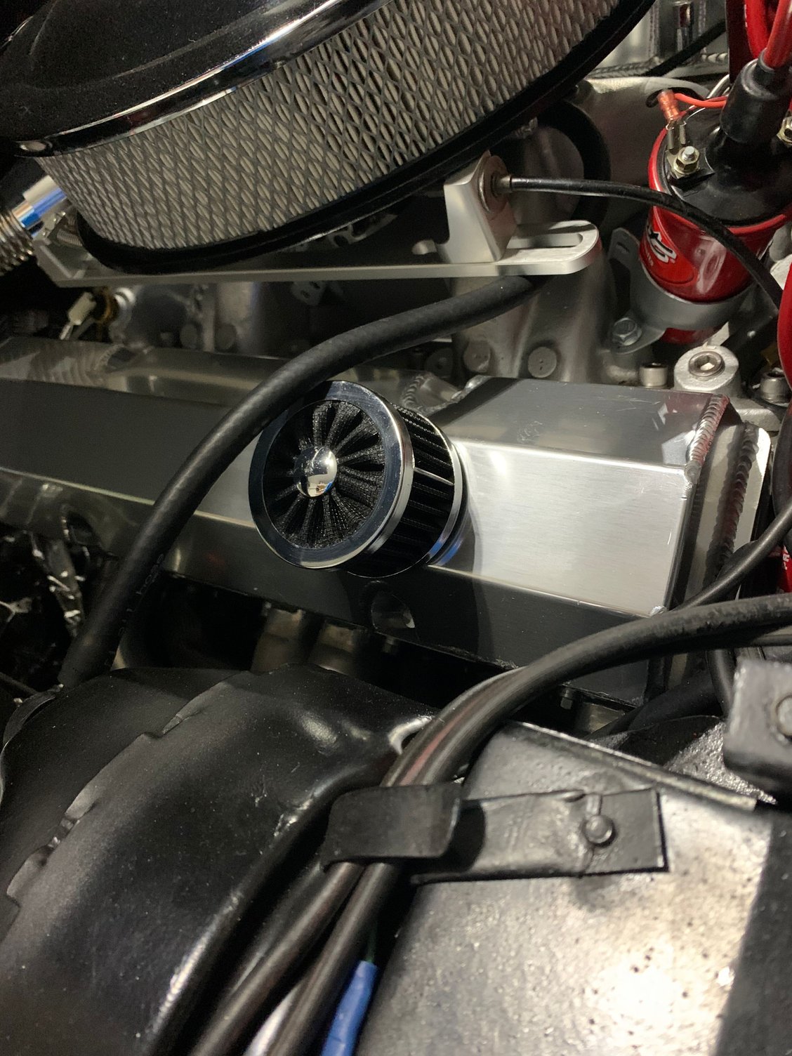

Got the high flow breather in. Will take it for a test drive soon.

Well it pops out still but much less. I’m happy with this set up for now. That breather looks good too. Maybe one day I’ll get the vac pump. Or a 434 swap

I wonder how hard it would be to put another breather hole in that valve cover...just a thought.
It’s aluminum so not hard I’m sure. Something to think about. Does it matter with valve cover gets the pcv? Maybe I should swap sides?
